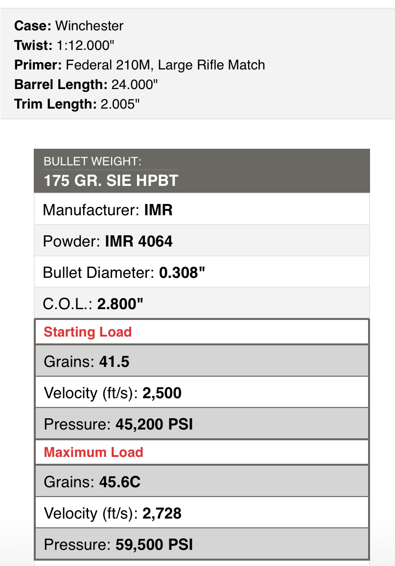

I've used it for a while, but stayed below 42.9 gn of 4064. but now that sierra updated their books its looking like i would be able to go higher. I am trying to get a consensus of what people have gone up to.
I've loaded IMR4064, 175SMK, and Lapua brass up to 45C grains. I did have pressure signs, but not much. IMR lists the max load with Winchester brass as being 45.6C grains. I think you might find 42 grains shoots to a "gold match" level. ;)

Sounds about right. I have loaded to the 45+ level in my R700 with Win brass but that rifle has about a 100yd freebore! I wouldn't recommend loading anywhere near there.
I would try the recommended loads that others have found to be the "sweet spot" in their rifles. A ladder test may refine this for you and varying your primers can make a big difference.
