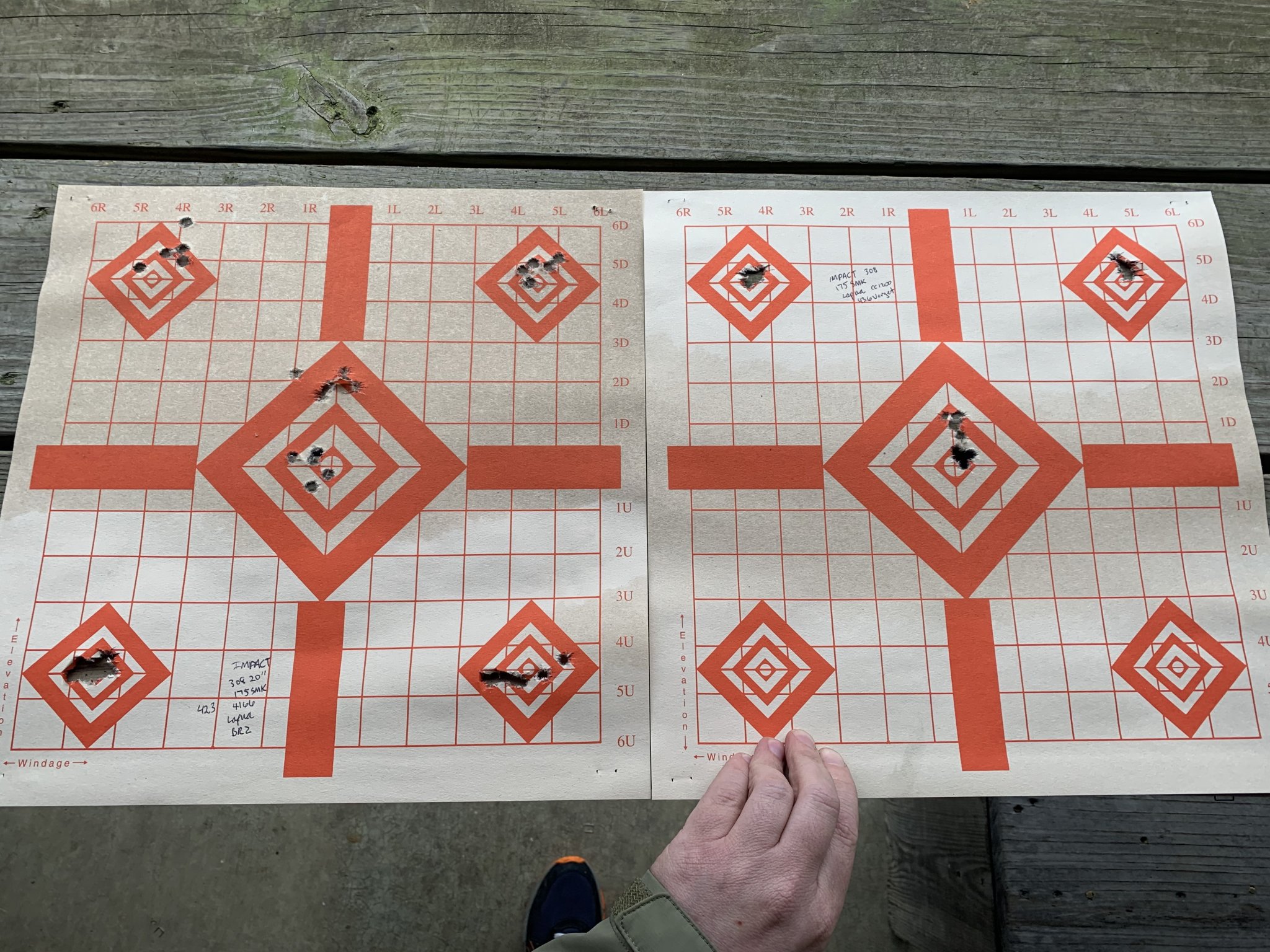

Same rifle, bullet, basically same primer, and case. The difference is Varget on the right and 4166 on the left.
Mine shoots really well with varget but I think they mostly all do. Lol. Mine shoots rl15 really well too. Kreiger barrel, it shoots everything I have put in it but 155 noslers.
