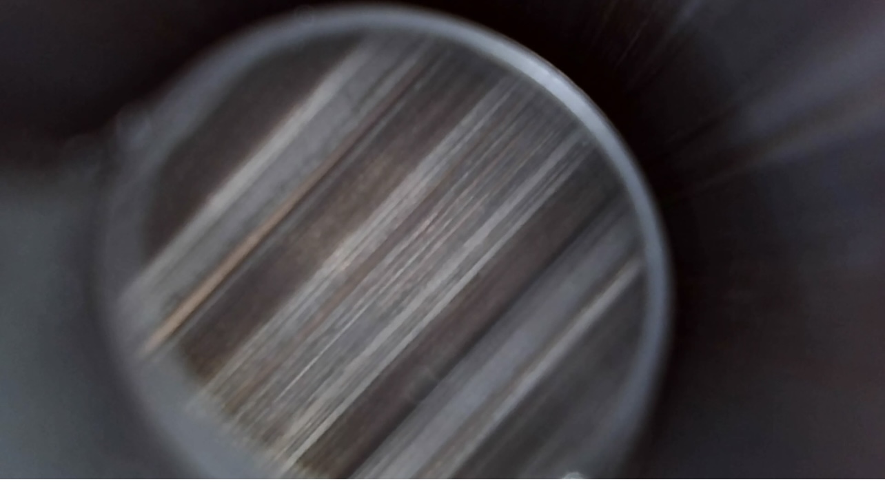

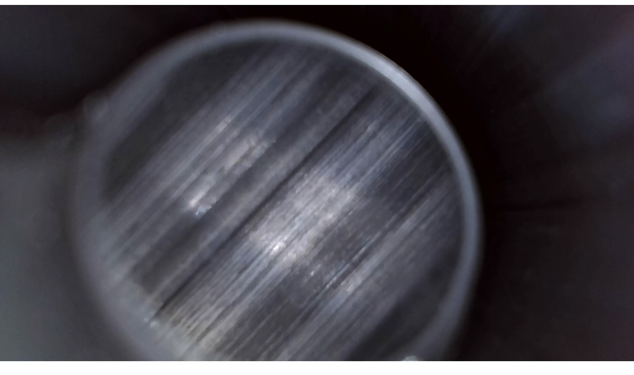

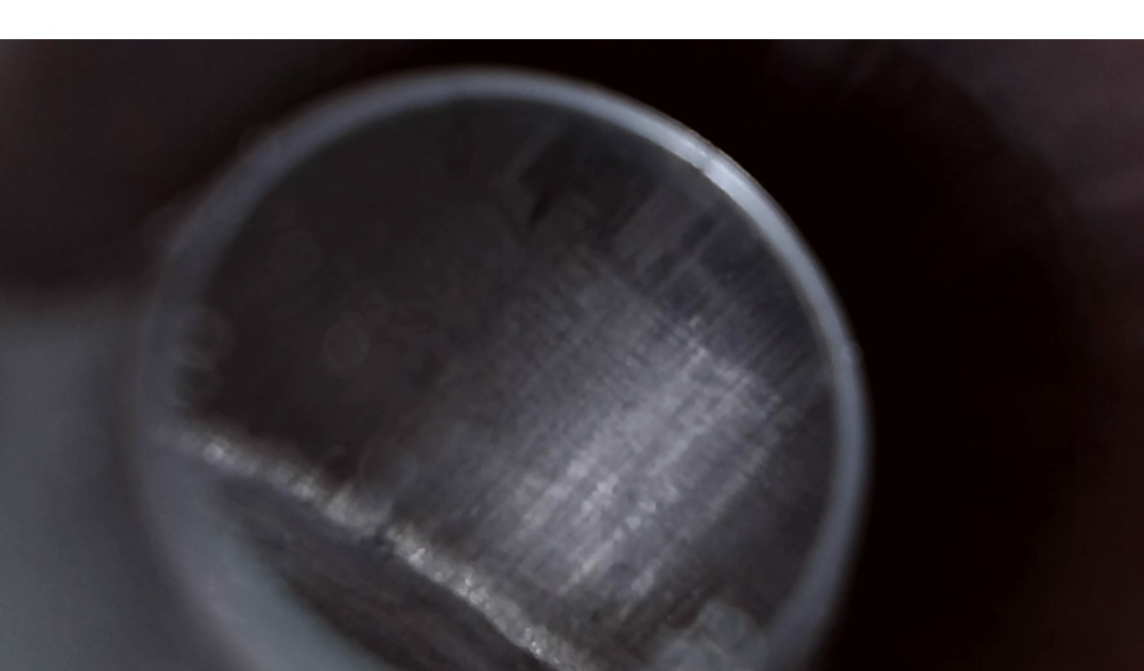

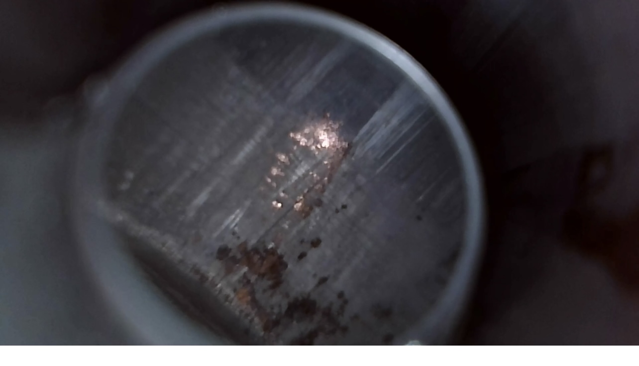

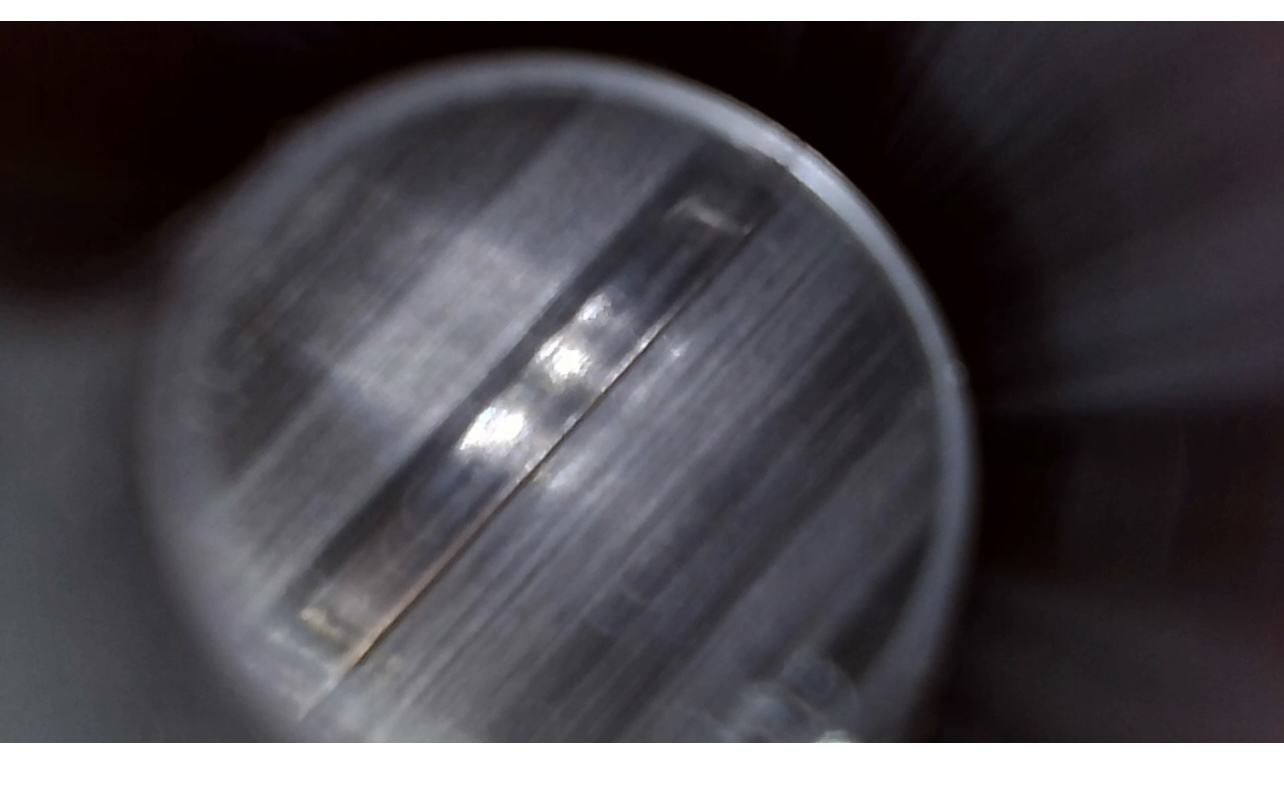

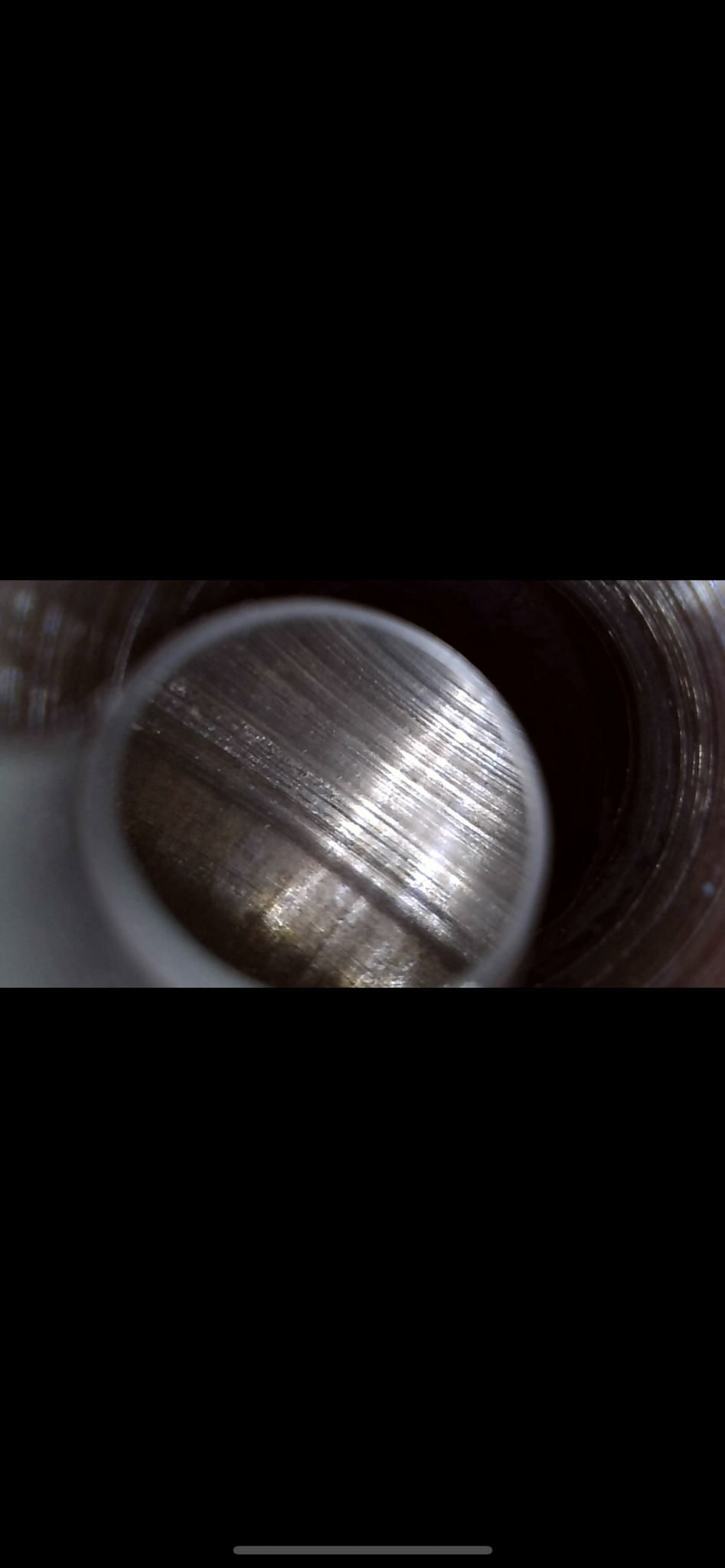

Well first set of pics is the rifle dirty second is with one pass of a bore snake. No serious cleaning. The three pics go in order throat middle and muzzle end of barrel. Throat is a bit rough yet and I’m picking up copper there and the muzzle. I also used a hornaday length gauge and I hit the rifling at 2.910 and I’m loaded at 28940. I guess I will do another loader test back at .040 tho jump and run down my powder about down another grain to see if I can find a node down low and see what happens.

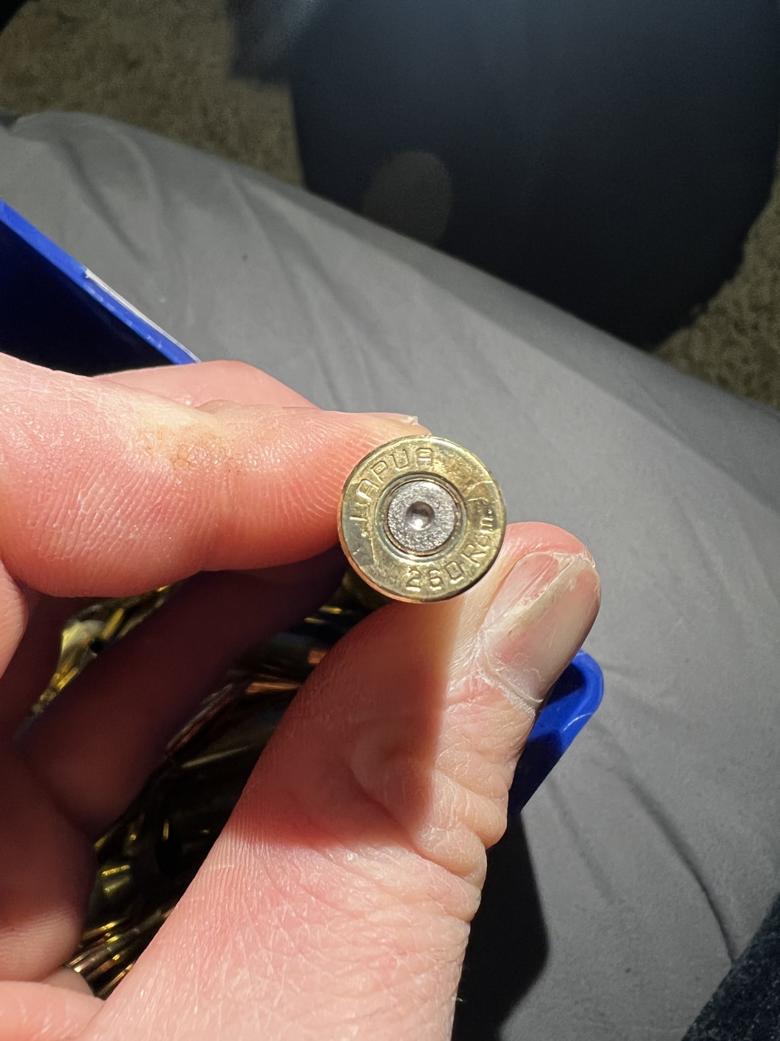

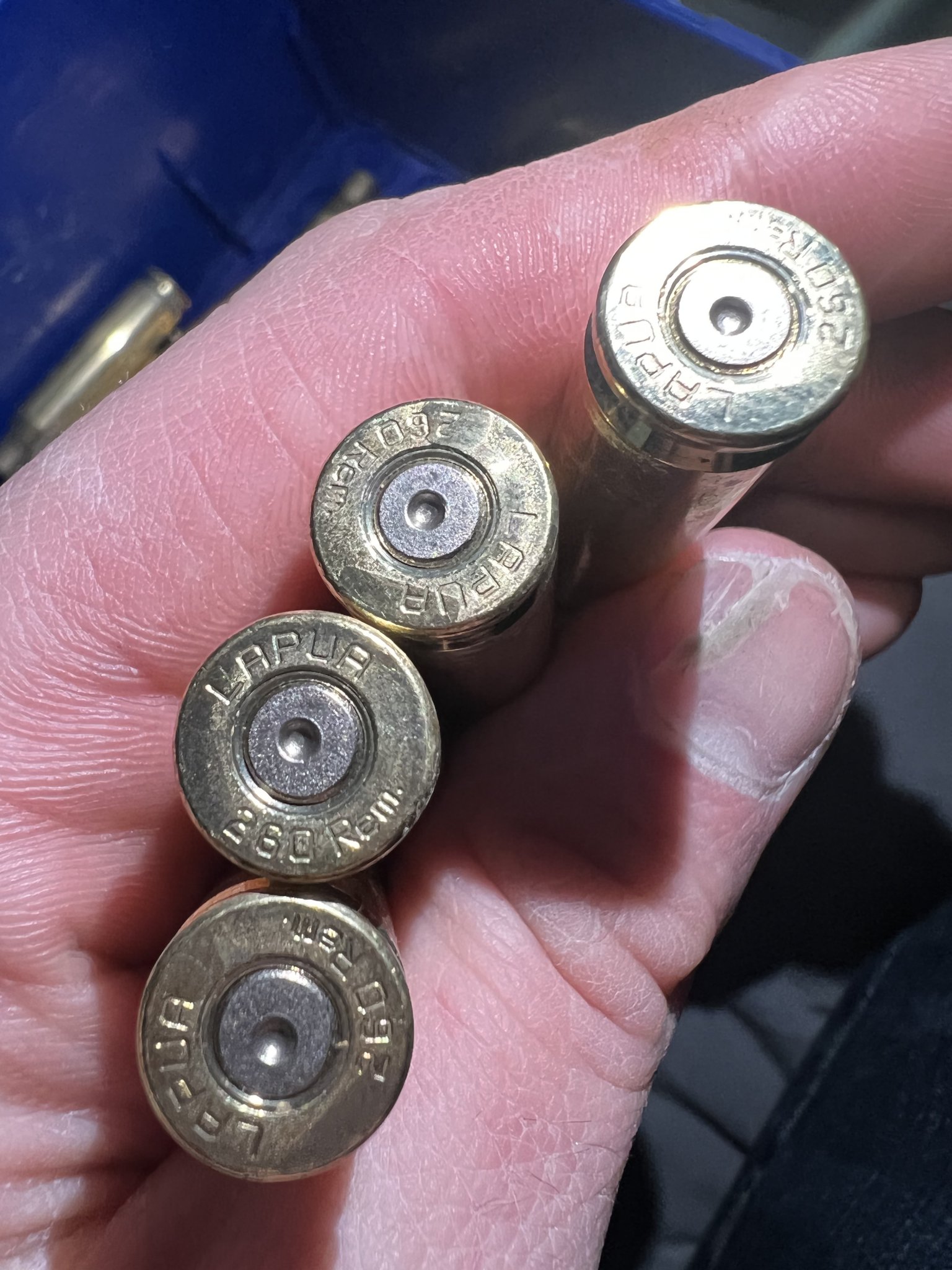

Are there other pressure signs other than bolt lift? how much did you bump your shoulders with resizing? What's the case head look like? How close to the lands are you?
At minimum setting on my die. .020 off the lands. Flat primers. Light extractor marks. Definetly not safe conditions. Orginal testing never showed anything like that. Just going to have to load it down for copper atm

Your velocity's seem to be a bit on the slow side for a 260. The neck area on the chamber looks rough,
how does the rest of the chamber look? That can cause hard extraction.
