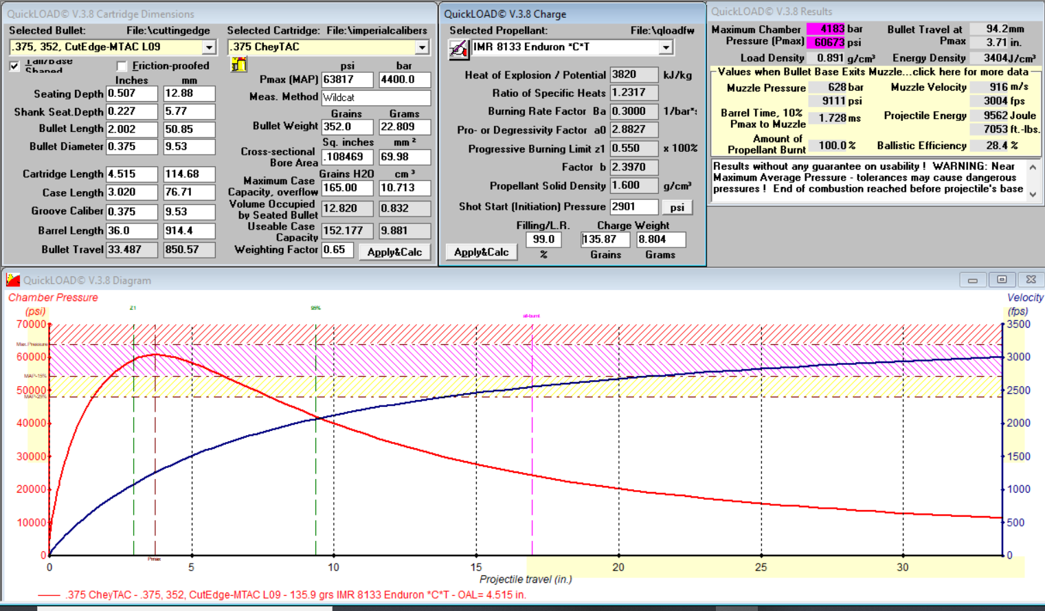

IMR 8133 should be pretty good in a .375CT, from what QL is telling me.
I used the Cutting Edge 352gr because it was a very common bullet for .375CT. I have no experience with the IMR 8133, but according to burn rate charts, it's similar to Retumbo, RL33, and N570.
Now take this all with a little more than a grain of salt, but using QL for an educated guess, I'd say you're probably safe (using the above specs) from 129gr to 136gr.
Thanks Dogtown. I was planning on using Cutting Edge 352gr to start experimenting with the load. I will give 8133 a try, perhaps starting around 125gr for a few rounds just to check pressures.
