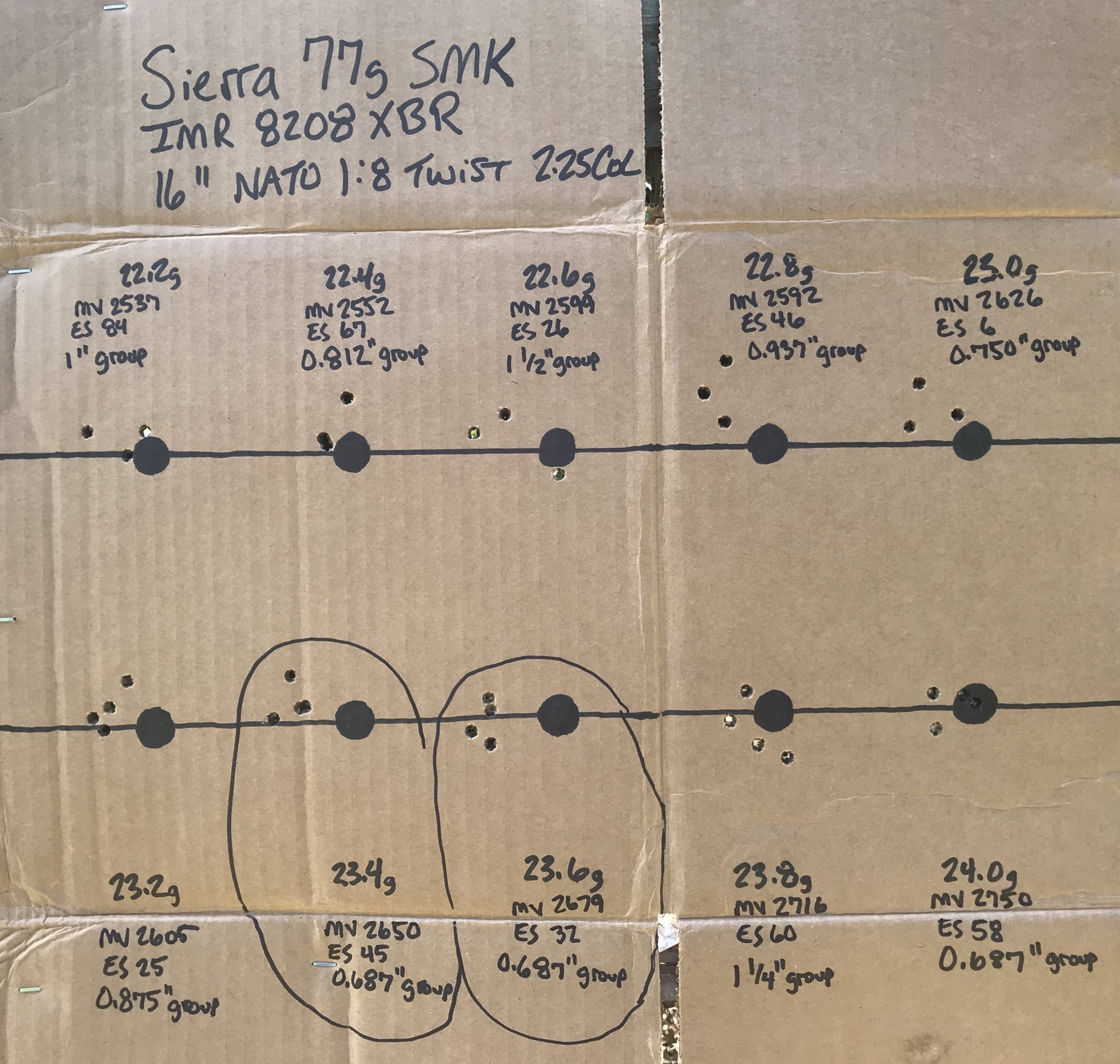

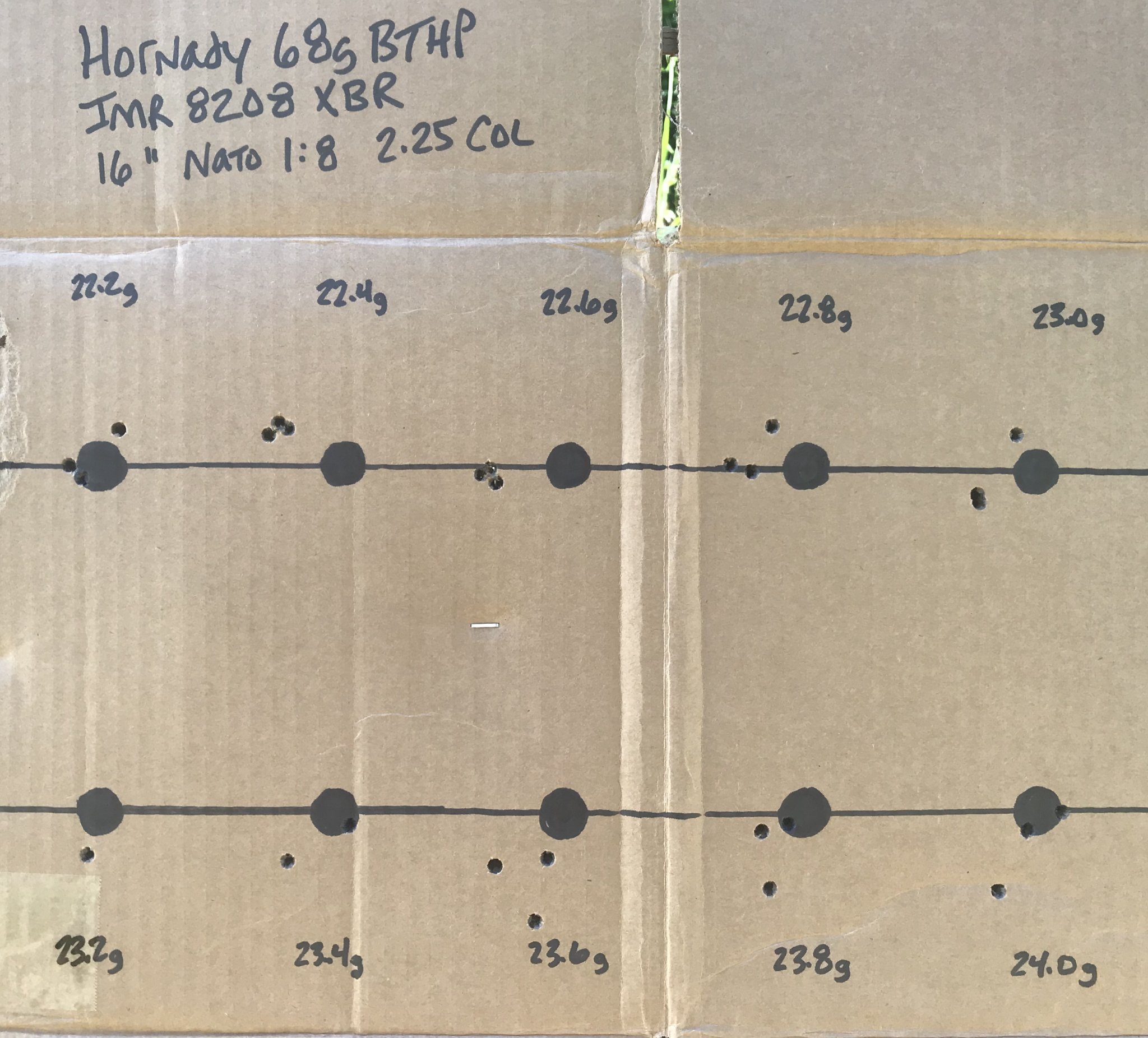

I am new to reloading, so be patient. My question is whether my velocities are consistent with what others are getting with 8208 and Horn 68gBTHPs? I stumbled on what appears to be a great load with respect to accuracy, but the velocities appear anemic. Also, I was curious if anyone had tried loading above 24.0g as I was considering seeing if another node could be found within a reasonable safety margin above 24.0g. I did see an ejector smear at 24.0, but honestly, I don’t know if it was already there before hand. My test was as follows:
Hornady 68gBTHP
IMR 8208 XBR 100yd Test
Wt. MV ES Group
22.2g 2544 65 .875”
22.4g 2565 56 .250“
22.6g 2618 21 .250”
22.8g 2641 35 .687”
23.0g 2665 27 >1”
*23.2g Not Tested
23.4g 2688 37 >1”
23.6g 2743 37 .875”
23.8g 2761 33 .938”
24.0g 2806 11 >1”
*Test was fired unsuppressed in round robin order. Feed issues were encountered at 23.2g, so that ammo was discarded due to dented cases from the mis-feeds. A quick side test with known good factory ammo revealed the typically very reliable gun was dry and dirty, and the rifle was mis-feeding with the known good ammo as well. Single feeding was performed for the remainder of the test.
Rifle:
AR15 Springfield Saint 16” 1:8 Twist, pinned mid-length gas non-adjustable, 5.56 NATO Chamber.
Brass:
Mixed, LC-14 and Hornady with approx 3 firings. Headspace of twice Fired Brass 1.4625. Full Length Re-Sized to 1.460 +/- 0.001. Primer Pockets uniformed, and trimmed to 1.750”.
Primers:
CCI 450s
Seating Depth:
2.250”

Well, about one thing at a time, I did do a little multi tasking and tried another test on my last outing using 77gSMKs 😆. They did fine, but I just didn’t get any ridiculously small groups with them like I did the 68s. Who knows? Could’ve been my technique behind the gun at that point. I do want to see how the 77s group at 200 and 500 tho. Might surprise me.
What is your testing procedure?? Are you just loading charges and deciding on load by group size? Forgive me, but thats what it appears since you refernce not finding small groups... You do know, you are NOT looking for group size when doing this part of the test.. You should be shooting your different charges, (0.2gr increments I see which is good) in Round Robin style. You should be use same headstamp brass when doing this. Biggest reason why, case capacity differences causing different pressures. That will skew your results right off the bat...
You are looking for consistent POI (Point of Impact) to identify the node. 23.2-23.4gr is pretty consistent and right there in the known 77smk/8208XBR node... 23.6gr - 24.0 POI drops down a little and is pretty consistent across those charges. You have options here. I would load up 23.3gr and do a seating depth test.
Your next step is to do a seating depth test. That is the step where you look for group size. If done properly, I guarantee you will find one group that shrinks right up and stands out from the rest....

Have you had any luck with 8208 with Hornady 68g BTHPs without cannelure? I only did three shot groups on my initial 68g test, but the groups at lower charges blew me away. Was not expecting to see that, but was pleasantly surprised. Gotta see if I can duplicate it now and will try it with what I currently have available as far as sorted headstamp brass goes.
That’s great information! I was just looking to see what charge weight grouped the best, and didn’t really grasp the concept of what this test is truly designed to achieve.
Nope, never bothered with them. I have shot 10's of thousands of 77smk with and without cannelure over the years out of precision AR's. They just flat out shoot, no reason to mess with anything else. Skipped right over the 69smk as well. My load and needs were for dinstance shooting out to 800yd. Which is the max effective range Ive found with my 20" AR's and 77smk.. Very consistent hits from 800 and in. Hits drop big time when you go to 1000. Yes, you get hits, but not with the consistency you do at 800 and in.
