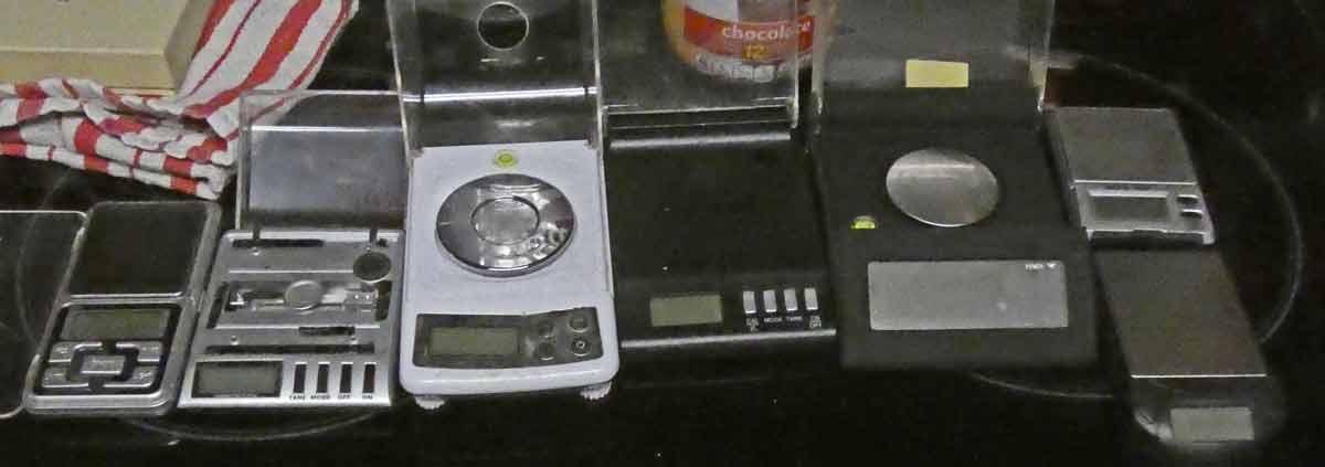

    What scale are you using? I was looking at some that do that carat weight for around 200$

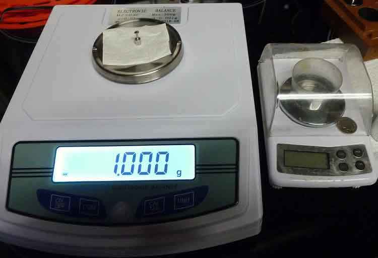

    This small cheap scale is the most accurate I have. 0.02 grains. It detects individual kernels.
    The design is bad, the pan is way too slow. This scale was designed for jewelry.
    What I do is to put another pan on top of its pan.
    It is very good to use it for checking after you use another method.
    @R0man
    That is a really poorly designed scale but it is pretty sensitive.

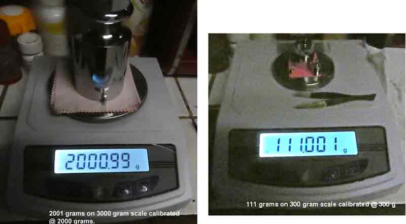

    A 300 or 400 gram scale that costs less than $1000 is going to have a resolution / accuracy problem at 1 or 2 grams.
    I have a cheap 300 gram scale the larger one with rechargeable batteries that reads to 0.001 gram all the way to 300. Will display something like 299.999 and 300.001 grams. It's pretty good about 30 grams and up and I use it to compare weights between my reference set of weights and working set.
    One or two or 3 digits drift/repeatability at 300 grams isn't much. At 3 grams it makes a difference. I can average most of that out using multiple substitution weighing methods.
    It does seem to be well built, for a load cell scale. Th load cell is a good 500 gram rated one with the electronics scaling that to 300 grams.
    While it reads to a milligram I would not trust it under 30 grams or so, even as a comparitor.
    I also bought one of the 3 kilogram models that seems good at 500 grams, 1 and 2 kilograms.
    It reads to 10 milligrams.
    The 3000 gram and 300 gram scales with more appropriate weight values.
