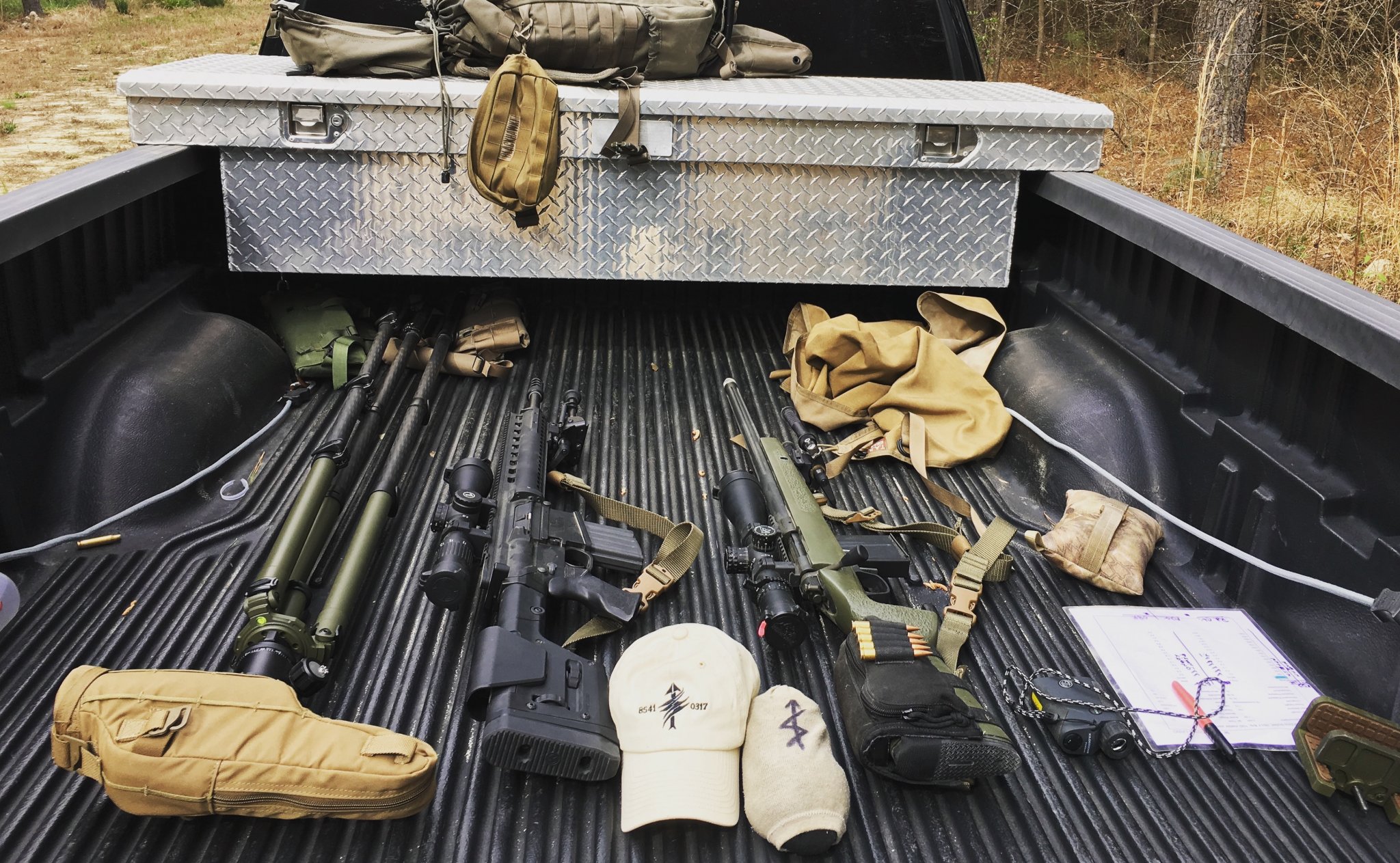

I’m building an AR-10 right now on a Zev receiver set and bartlein barrel. The gas system is all JP (SCS, BCG and gas block). Trigger tech trigger, spuhr scope mount, magpul buttstock, area419 muzzle brake, radian raptor charging handle. This is not a cheap build. But I guarantee it will never fail on me.
This build set me back a good bit, same thing though, just don’t see this rifle ever having a hiccup.
Aero Precision upper & lower with 15 inch keymod
20 inch Wilson Combat Super Sniper threaded and fluted barrel chamber cut in .223 Wylde
Silencerco ASR muzzle break
SLR rifle length gas system
JP BCG with JP enhanced bolt
JP Silent Capture buffer assembly
JP rifle tube extension
JP Houge pistol grip with finger grooves
Luth-AR MBA-1 buttstock
Radian Raptor Charging Handle
Geissle single stage precision M4 curved bow set at 3.5lbs with lower parts kit
When I load and make ready with this thing, I literally feel like I’m fucking wielding Mjölnir
If you want something that is going do what it is supposed to do, when it is supposed to do it, and you want the warm and fuzzy that any accuracy/performance issues are your fault (and not the system's) then buy a quality rifle and don't build. If you want to build one as a hobby and to play with, then build one. I've done both and had great results with an SR25/AR10 that I built. I ended up getting rid of it and just bought an OBR because 1). I've always wanted to try one and 2). its a fucking laser.
I don't have brand loyalty and will be the first one to admit when I wasted money on a product because it was/ is supposedly "the best" but no shit, I'm loving my OBR. I've carried KAC's rifles for years now, and while they are great, I don't think any of them have done as well as my OBR with a PRS stock. The only thing that sucks about having an OBR is working and having to drive over an hour to stretch it out. A lot of people on the forums hate on LaRue but that's just like, their opinion man. lol That being said, they are always popping up with pretty good deals on em in the PX.
Side Note: GAP rifles are GAP rifles, you're going to get a laser as well.
Buy once, cry once, live happy, and die with a few extra pages in your will.

@DaleGribble82
lol I said the same thing about Atlas too. I used to only run the HBRMS but once the CAL was announced on here, I pre-ordered lol. A lot of the guys I ran through LR courses had AX rifles and Atlas PSRs...I couldn't see the need to spend that much on a bipod when $100 Harris worked perfectly and always treated me good. But here I am years later with a CAL and about to order an AXSA.
@TacticalDillhole I've never run a Unimount on any of my systems so this would be my first. I figured money is good right now so I should keep with my "buy once, cry once" altitude and just do it.
Pic for the fun of it (Other rifle is my FNH A3G w/ the CDI DBM upgrade). Shit, now I want to go shooting.
