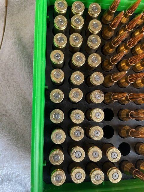

    So, after much thrashing trying to get a good load for my .260 Rem gasser, I finally arrived on one. I worked up (actually worked down - long story) a good load in Lapua brass using the Berger 130 AR Hybrid, 41.0 gr of IMR 4451 @2790 fps. Had no pressure signs with the Lapua brass and under .5 MOA accuracy at 100 yds. I had a match coming up this weekend and wanted to use my Virgin Prime brass as I didn't want to use my new 1x fired Lapua and lose it. The Prime stuff is quite a bit lighter weight and the case volume is larger than the Lapua. So I didn't expect there would be any problems loading the same 41.0 grain load. If anything it should be slower, right?
    I went out the day prior to the match to get some dope with the new loads in the Prime brass and sure enough the same load in that Prime brass was about 40 fps slower than the heavier Lapua. Accuracy was fine. But I noticed that some of the Prime brass had a significant amount of swipe while others had none. Also almost all of the cases get the plunger mark on the head. The picture below is all the same Virgin brass, all with the same load and shot on the same day. Some of the swipe actually have some sharp edges where it carved into the brass head.
    So the question is 1) why am I getting this much swipe when it's a fairly light load?? 2) And then why do some show lost of swipe swipe while others are completely fine and not marked. And finally, 3) some of the virgin brass I just shot was reloaded for the match and probably 69% of them had very loose primer pockets. I would not have expected that with a lighter loads.
    Is there something going on that I am not seeing? Or is Prime really that shitty and I can expect to toss right away??

    Would you happen to have a chamber drawing for your rifle’s barrel? Or know the neck diameter?
    Agree that’s a sizable amount of brass overflow around that ejector plus loose pockets for that charge weight.
    Wondering if you have a really tight neck chamber (but readily admit I can be totally off-base).
    How much is your chamber allowing the case to expand? How much is the bullet jumping?

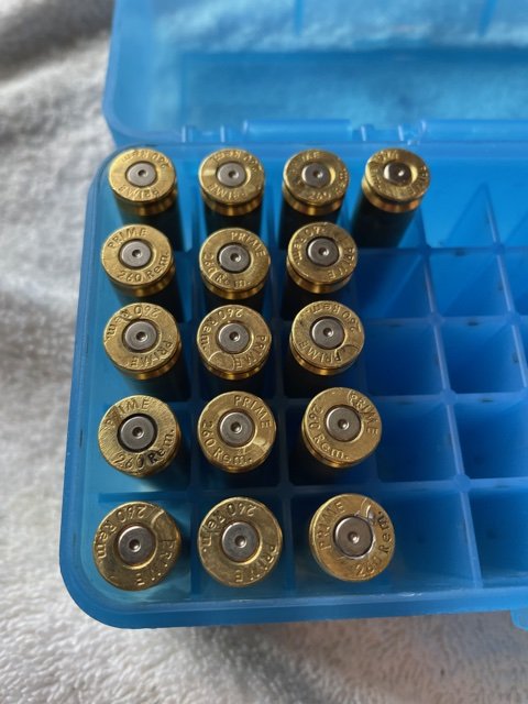

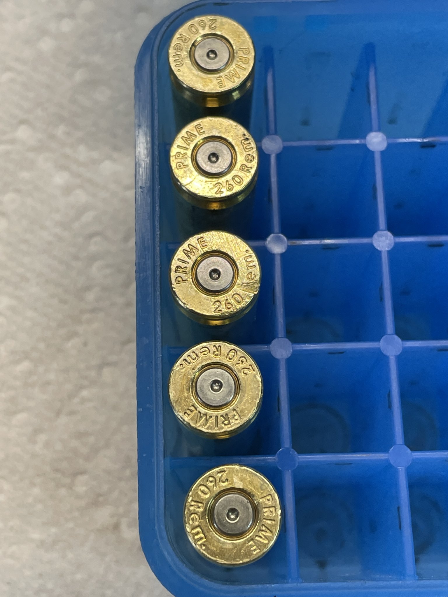

    This may be the culprit. The fired headspace (using a Hornady headspace gauge) is 1.6300. The virgin headspace from the factory was about 1.640. So that's a pretty big gap to fill. However, I shot a mix of Virgin brass and some 1x and 2x fired - and even the 1-2x fire formed cases are showing some swipe while others are not showing a mark at all on them.
    This first pic is from the match with 2-3x Fired.
    This pic below was the Virgin brass:

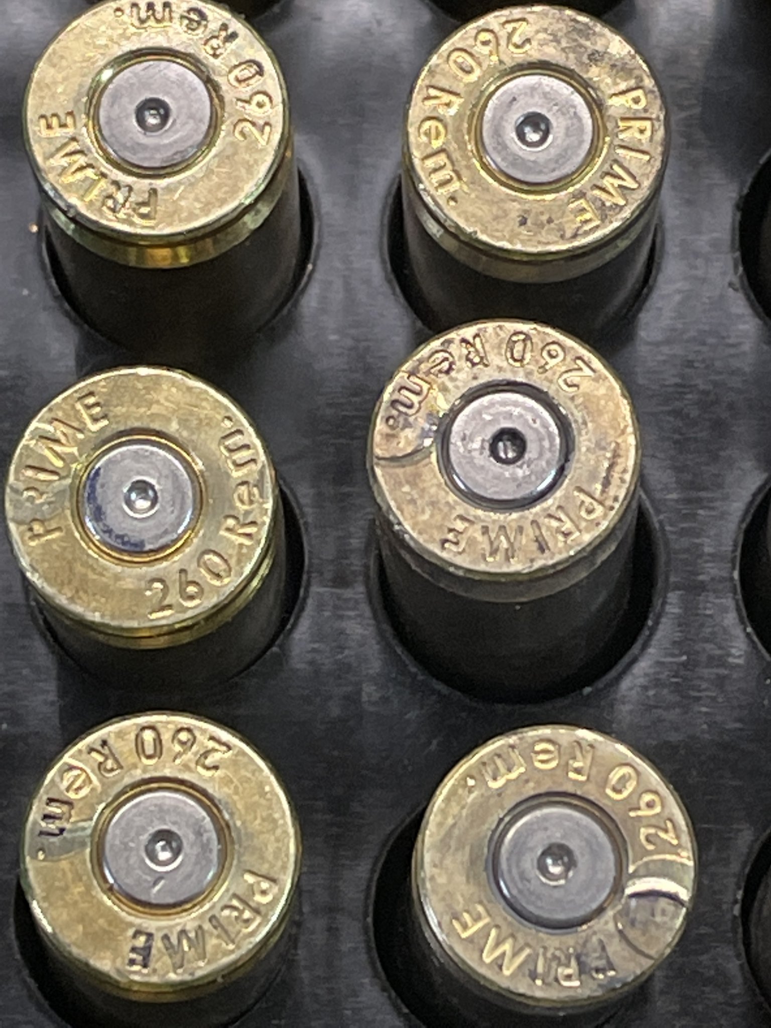

    Look like you have blown primers in addition to the ejector marks. I would not rely on a comparator to measure AR brass. It is often fucked up on the bottom and stretched and does not give a reliable shoulder length reading. I would size the good ones incrementally until the bolt closes to see where the length is at.
    Also test for bullet setback.
    If you can drop a bullet into the fired cases without resistance then you don't have a tight enough chamber to create excessive pressure.
    Pull the gas tube and shoot a few rounds. If they do not have ejector swipes you will need to tune the gas system and/or the recoil buffer and spring. The AR308 in 260 is very sensitive to gas pressure, dwell time, and unlocking. If the rifle is unlocking under pressure it will manifest as excessive pressure (ejector swipes, blown primers, stretched primer pockets). Slower burning powder with exacerbate the problem because it makes pressure slower and maintains pressure longer.
    ETA: Not all powders and bullets are compatible with all gas guns. 4451 is a slow powder and probably poorly suited for this application. Also, 41.0gr of IMR 4451 isn't a soft load, it is around 58K PSI and over max for the platform.

    No. No blown primers. I started decapping some to throw in the tumbler before I thought to post. What spurred me to start a thread was how loose the primer felt coming out on the just fired virgin batch.

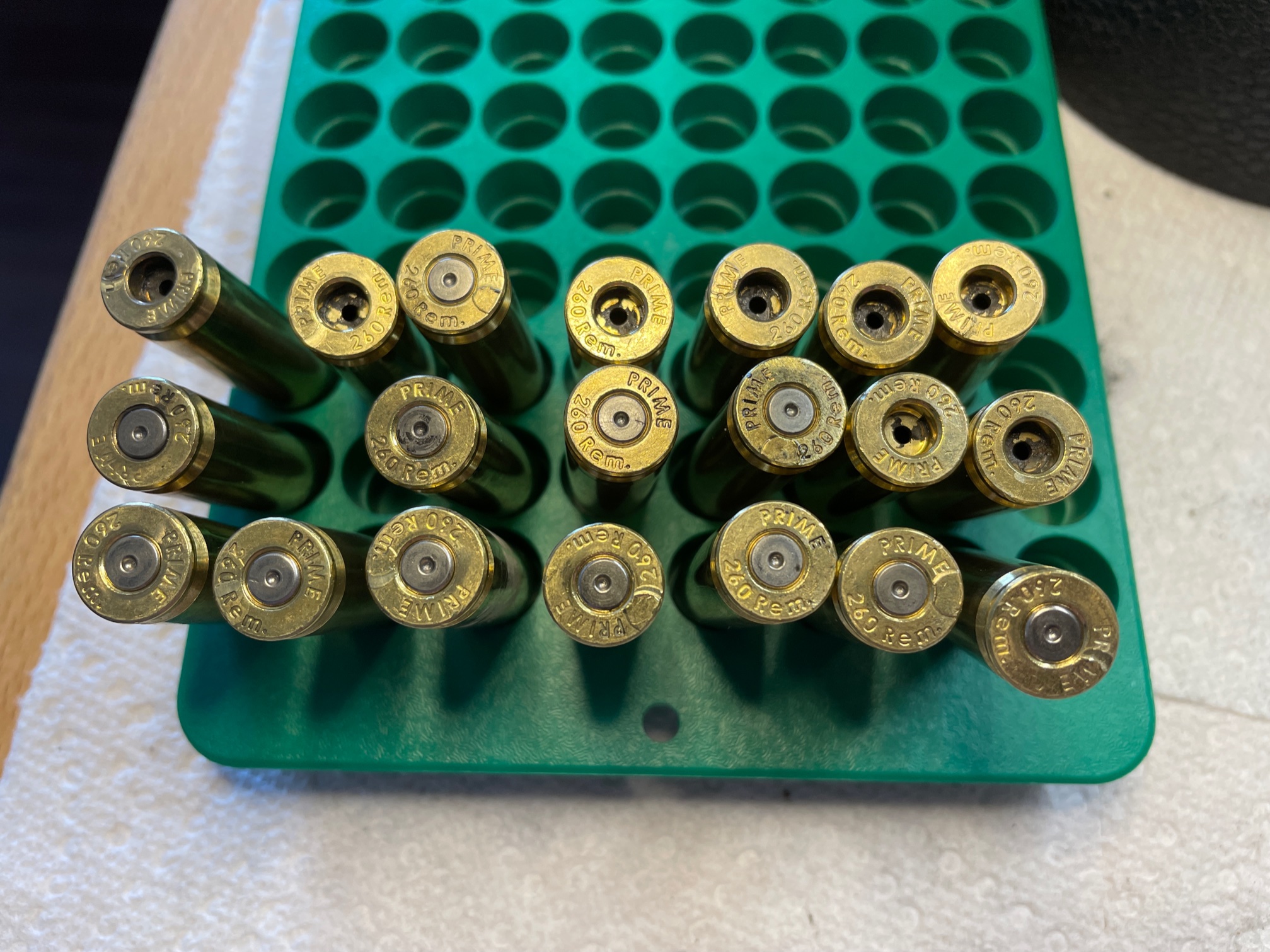

    The blue box has cases with blown primers. The black around the circumference of he primer indicates it is blown.
    Ok, maybe we just have different definitions of what a "blown" primer is. I always thought that it was either a pierced primer (hole through the primer strike) or the primer has been physically blown out of the case. Neither of those situations were the case with these particular loads. Although I have seen this in the past. Now, If you are talking about gas coming out of the primer pocket around the sides of the primer itself, then that's certainly possible. But all of the cases in that pic had their primers and there were no pierced primers. The ones without the primer were simply decapped before I thought to take a pic and post this thread.
    Blown primer means gas leaked around the primer pocket. This will fuck up your bolt face.

    Ok, to close the loop on this - I'm pretty sure I found my root cause today. I was trying to go through all of the variables that could be causing these obvious pressure signs and torn up brass. It turns out (or at least I'm pretty sure) it has been a headspace issue. I had been bumping the shoulders about .0025 to .003 based on my understanding that typically a .002 shoulder bump in a bolt gun and about .003 in a gas gun is desirable for smooth function. Turns out it was too much for this particular rifle. After discussion with my shooting partner last night, I took some 3x fired cases (PRIME brass) and set up the die to just barely bump them enough to chamber and eject the live round without having to force the bolt open. So I started with a fired round with no sizing and it would chamber but would not eject without having to bang the stock against the loading table while holding the charging handle to get it open. I backed off in tiny increments until it would open normally. Turns out that sweet spot was about .0005 to .0015 bumped from the fired cases. I'm using the Hornady headspace tool and a Mitutoyo digital caliper. Fired rounds measure 1.6300-1.6305 and the final bump to get them to eject normally was 1.6290-1.6295.
    So I went out and shot them today along with a batch of the same brass and same exact load, but with the brass headspaced to my original dimensions of around 1.6265-1.6370. HUGE difference. The minimal headspace brass had zero indications of swipe or the ejector stamp where the brass flowed into the ejector hole. And best of all, it functioned flawlessly even with the minimal bump. I have a small set of data points, but I'll continue to barely bump the shoulder and see if it continues to not show the swipe and ejector "nipple" shearing like I was seeing before. But I would not have believed that that small a change in headspace / shoulder bump could have made that big of a difference.
    Below are cases from the original .003 headspace.
    Below are cases with the minimal shoulder bump
    the case in the middle of the blue box was where I tried to file off a previous ejector bump and got a little too aggressive. So that was there previously.
    All the cases in the pic where shot today. Same conditions, same exact load, etc.
    Did you ever check how much your rifle is bumping the shoulder while chambering, if any?
    While I'm not a huge fan of reading primers for pressure, it APPEARS that your tight head spaced brass showed "less" pressure as to how "flat" the primers are.
    Yep. If I take a fired case and chamber it, it bumps maybe a half thousandth. If I size and bump to that .001 to .0015 like above, there is no additional bump from chambering.
