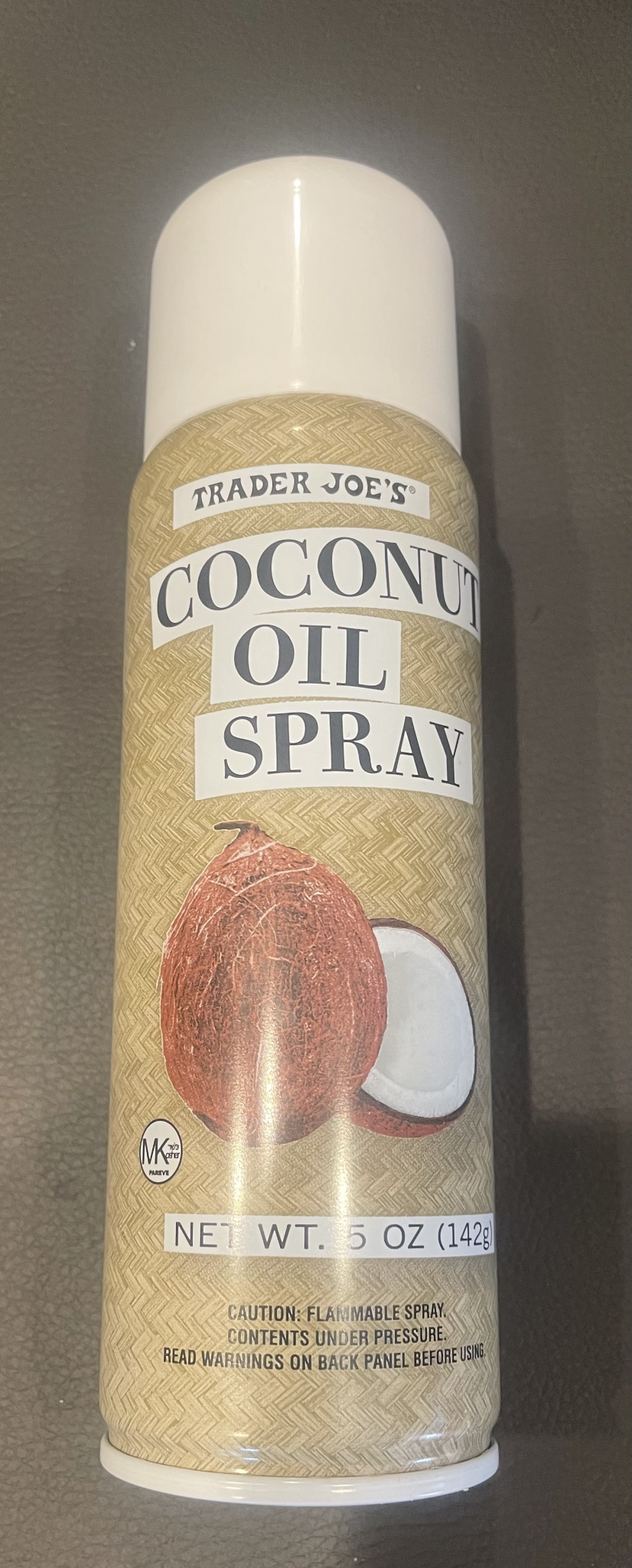

I've been noodling on how to get better accuracy out of my generic/crap .22 rounds lately when the good stuff is either too expensive or not available.
I noticed several years ago that most of the Eley and SK and Wolf rounds come with sort of factory wet-lube. So I set out to see if wiping my CCI and other generic .22 rounds down with that same lube, harvested off of higher-end ammo, would have an effect.
My findings- while not scientific, indicated that the lubed rounds seemed to show a marked decrease in spread at 30 and 50 yds compared to the same rounds dry. ......enough of a difference to warrant more investigation. Test rifles were several Savage MkIIs and a CZ- all bolt action.
SO, I started looking around for lubes that were easy to use and wouldn't foul up the rifles. I also wanted something cheap, non-toxic, temperature resistant and fairly easy to find.
After trying multiple silicone greases and cooking spray oils I settled on this....Traders Joe's Coconut Cooking Oil Spray.
I'd like some independent verification of what I'm seeing ....but it's pretty funny how well this stuff is working.
I'll still shoot a box of Wolf Or Ely when I can but this has lessened their appeal due to the stupidly high cost and general lack of availability.

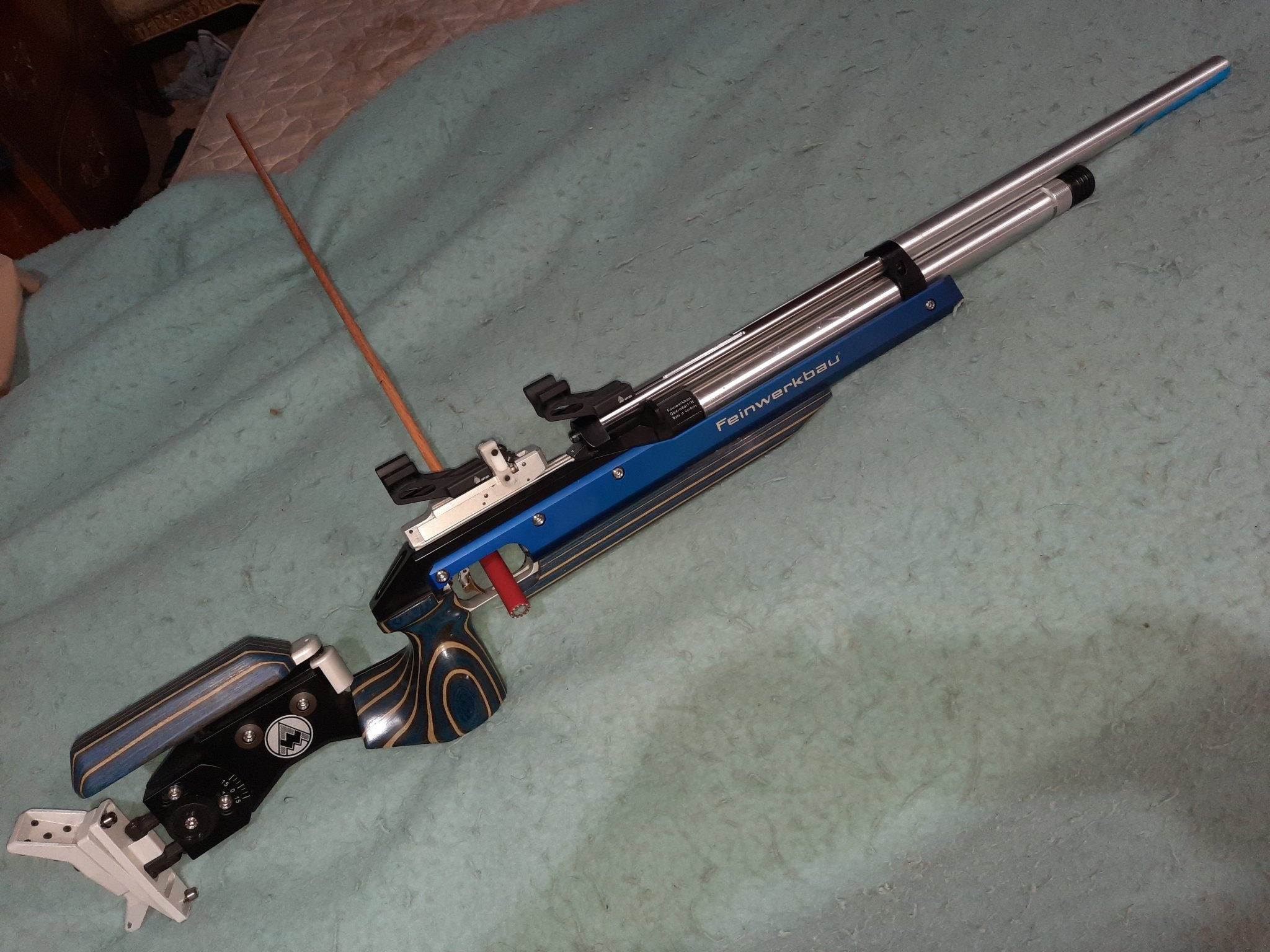

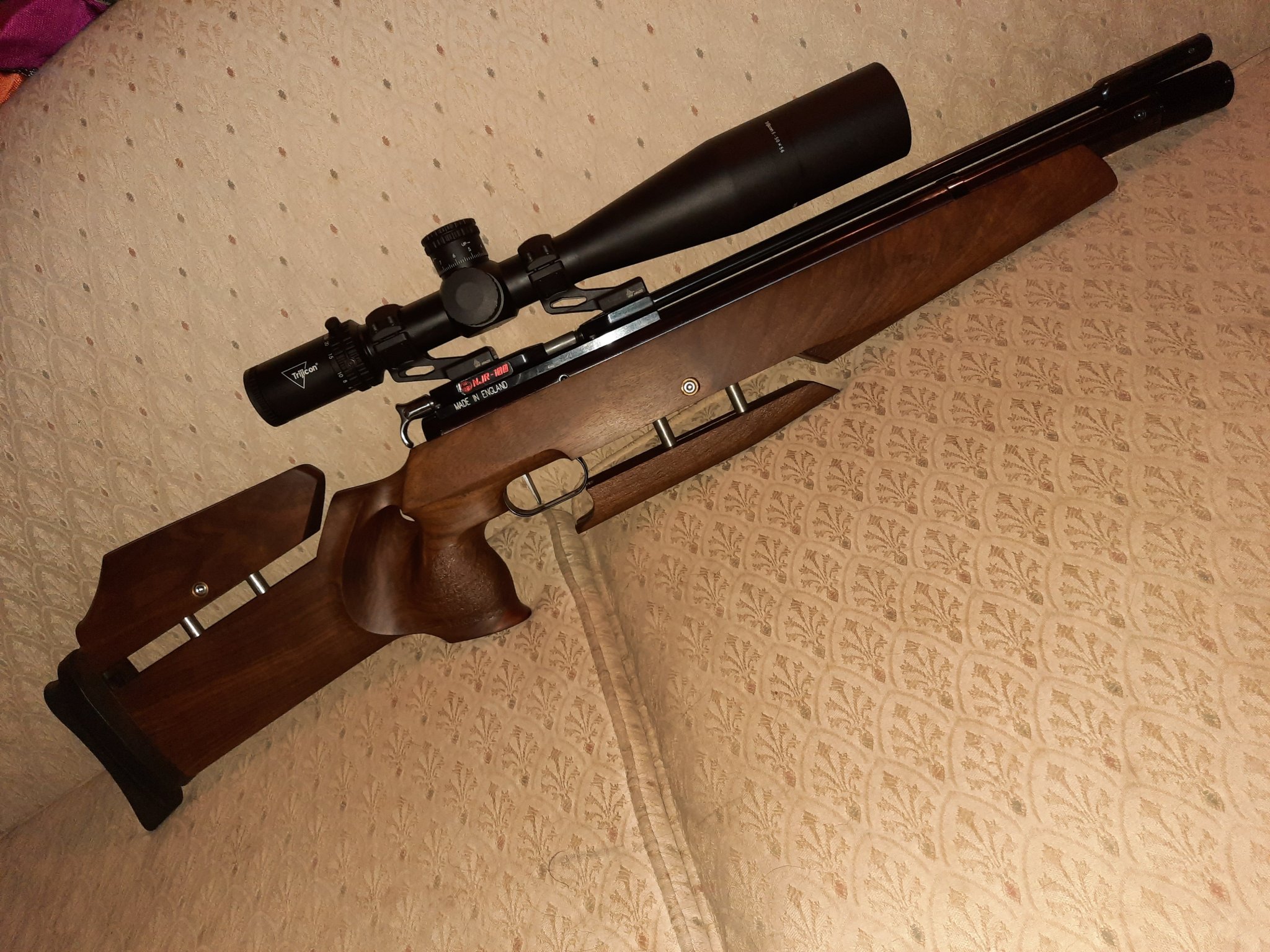

Consistent .25" ctc accuracy @ 50 yards is my current goal. !! In 1994 it was .38 (aspirin ) at 50 yards. They are fun
because they powder like miniature skeet.... That was with a $500.00 airgun and a 6.5-20 EFR Leupold scope. Now I have a pair of
Trijicon 5-50s and a 1994 Air Arms NJR 100. The blue gun is an FWB P70 high power from 2007.

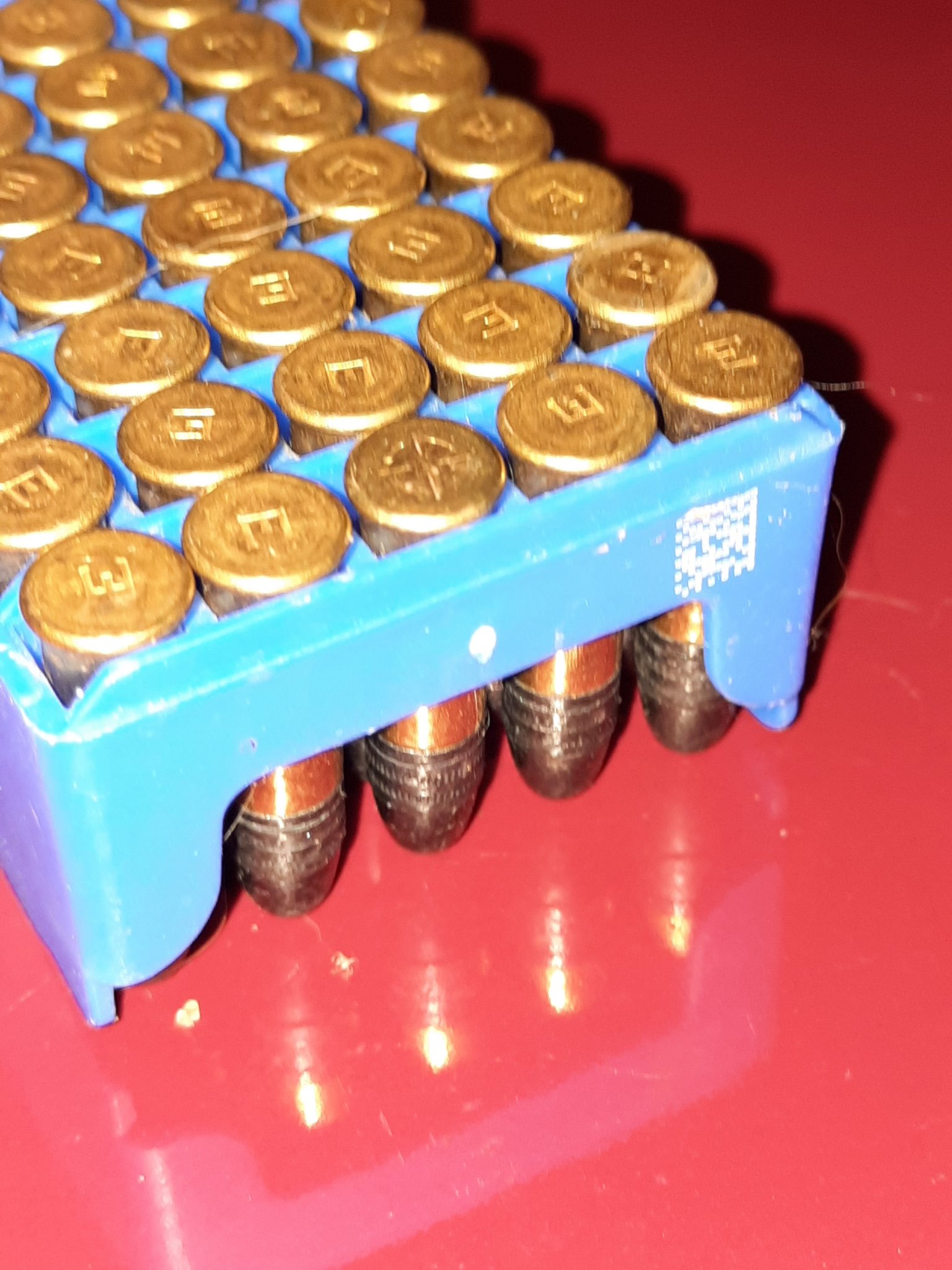

As far as applying the lube, you may be able to adapt the candle making approach. That is hang them nose down and dip them
50 at a time. Personally, I would use the handy bullet holder that is found in every box of decent .22 ammo as shown in the attachment.
That said, I may try and use the holder to let the bullets soak to remove the old gunk.....

I've found that the coconut oil spray is easy to apply on the framed rounds at the bench. On colder days it thickens up and on hotter days it doesn't appear to run.
I'm not getting any indication of dieseling.

It would be nice if we could buy whatever they use at the factory as a lube if nothing else but to refresh old dryed up old ammo.
I have some Eley Tenex thats been laying around a while and the lube is now dry and chalky. I would like to freshen it up, because it no longer shoots like it once did in my Annie.
Thought of using case lube, but ideally a proper over the counter product would be great. I'm assuming its little more than an emulsification of bees wax and some sort of oil or grease. Probably similar formulation to a skin moisturizer recipe but without the water.
