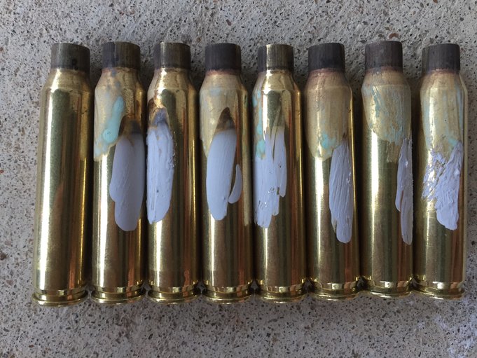

So it looks like induction annealing does not necessarily leave the same patterns on brass as flame. How can you tell if your brass is where you want it with induction? It's definitely melting 700 Tempilaq on the inside. 3.5 seconds does this and leaves the case body warm-hot to the touch but you can touch it. Some slight discoloration occurs, almost like dulling of the brass, maybe some slight bluing, its hard to tell. Also, we pretty much have it set to where its maybe 10 thousands past the shoulder. Can anyone share pictures, tips, advice on their induction annealing process?
You can't go by discoloration. Brass discoloration varies depending on how you cleaned it and how many times you annealed and reloaded it. I use a 650 degree tempilstik as a minimum and thumbnail to the case mouth as a maximum. If my thumb nail is able to indent the case mouth, the neck is too soft.
I should have worded that better. I realize you can't go by discoloration. I guess I'm saying it was hard to find a reference point, since there is almost no discoloration. The only things I know is that is melts 700 Tempilaq on the inside of the neck, yet it doesn't feel any softer to the hand when finished. I guess my question is for fine tuning induction annealing. Our unit is very consistent. I'm mostly looking for help as to the little details on when its hot enough, yet hasn't gone too far.
Do the thumb nail test. If it bends the case mouth it's too soft. Your nail will give before the case mouth will.
Ok my buddy just tested a few more. 5 seconds actually looks good and he said it started to glow slightly right before it shut off. 6 seconds you are able to dent the case mouth with finger nail.

Able to dent the case mouth very slightly with a lot of fingernail pressure (made my thumb hurt) on the ones at 5 seconds. Is that too far?

Put the tempilaq on the outside where you can actually see it on the neck down past the shoulders. You want it in only long enough for it to begin to turn clear down to the base of the shoulders. I use the 750 so the 700 may be a different composition but my tempilaq once dry will go from green, to clear, to black where it almost looks just like a sooty case mouth. My understanding is that the temp is achieved when the paint first starts to change phase and not once it has all burned off because once it has all burned off you have been at (and thus way past) the temp for too long.
I also position the neck shoulder junction in the middle of the annealing field. If the middle of the neck is in the middle with the shoulders further back out of the field it caused the neck to go clear way before the shoulders ever actually did signaling an uneven annealing job on the case. If I cooked it to where the shoulders turned the neck would have been at temp for 1 second longer than the tempilaq signaled it should have been. Moving the center point to the shoulder neck junction made it so both the shoulders and neck turned at the same time signaling an even job to me.

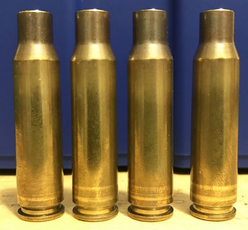

This is my annie and some 223 brass I tested on when I first got it, you can see the progression: 2 cases at each time interval, one with tempilaq and one without. 6 different intervals. On the left side was too little time in, on the right side was too much time. You can see that the tempilaq doesnt melt on those on the left and on the right it melts down too far past. What youre looking for is the point middle ground when the paint transition is just migrating off the shoulders like in the fourth pair from the left (right under the power switch). It has gone clear through the shoulders and is just starting to turn on the body.

Thats my understanding of it and the use of tempilaq in an induction setting. Your 700 may require migrating a bit further downward but if you can see the brass glowing you are likely getting too hot from my studies.
I just got some 450 in to test on the bodies and I should be annealing a batch of 50 after this weekend. Ill report back with a similar pic (provided I remember in a few days) but with the two different types used to see just how far down the cases the heat migrates. 1.6 seconds in the annealer turns the neck and shoulder tempilaq and I have to drop that bitch like its hot quick so Im sort of concerned about the downward heat transfer. Especially on my 300bo brass.

Way too hot on those two 5 second pics. The zinc has fried out of the mix with the copper.
Start with some shiny brass tumbled in corn cob or tumbled with stainless pins. Get your annealer set up and turn out the lights in the room. Creep up on the time until you just see the neck glow. You may have to have to dial in a little more time beyond this for proper annealing. The best indication for a proper anneal is to look at where the brass changed from a shiny finish to a matte or frosty surface finish. I usually set my time so I get the matte finish to show up just below my shoulders. When done this way, my necks are a matte straw color, not coppery like an over annealed case.
From the op's first pic above, the left case is pretty much an ideal anneal. The right one shows a little bit more time or a different location in the annealer coil, but by no means over annealed.
Those are 5 and 6 seconds. 6 actually was over annealed as I could bend the neck with my fingers. The two that look copperish are because that's what color the tempilaq turned.

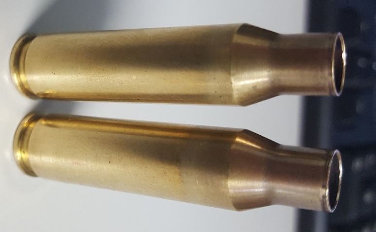

Here's some of my induction annealed .308 brass using an Induction Solutions automotive induction heater with my own hand wound #10 AWG 7 turn coil. This is 7.5 seconds anneal time. Anneal times will vary depending on what frequency and wattage your particular unit runs at. These cases have had shoulders bumped in a body die, which is the reason why the body of the cases aren't near as shiny as when they come straight out of the pin tumbler. IMG_1865.JPG

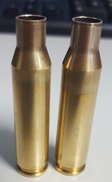

Just because I said I would follow up, this is a normal case, the next three are 1.6 seconds and the next 4 are 1.7 seconds. Green is 750 and purple is 400. You can tell that the 1.7 is just a bit more done in the shoulder and what I was using before and though the paint is actually lower on them you can still see where the line is just a bit lower than the 1.6. The additional 6% time between the two benefited the shoulders yet had minimal impact on the body of the cases.

Keep in mind that it's 223, it won't take as long as larger cases. But with that in mind it's been fine.
