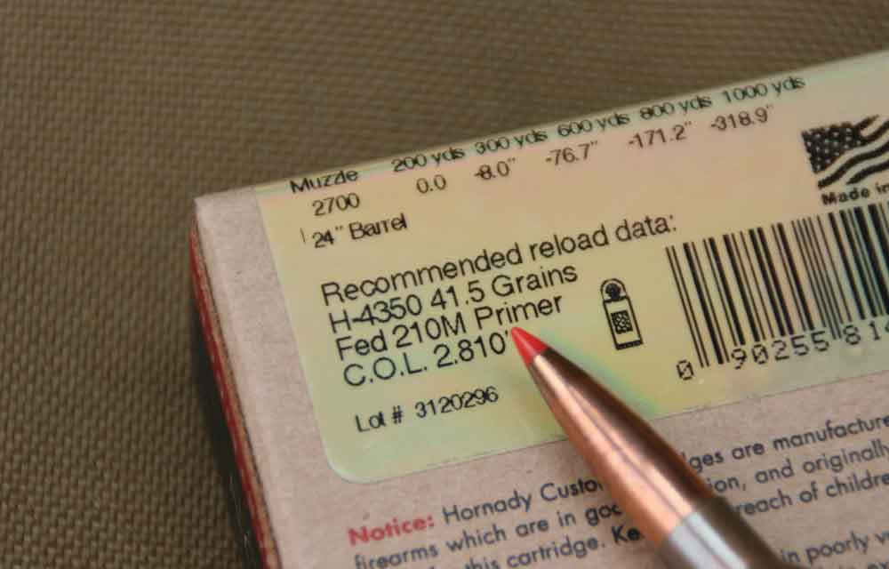

Info on Hornady 6.5 CM ELDM ammo. 140
I believe they switched to a proprietary powder after switching to the ELDM. When they loaded with the AMAX bullet, it was H4350. They used to print the recipe on the box along with COAL
Edit: Found the pic
Here's what I use as a reference load in my Tikka T3x TAC A1 with StaBall and Berger 140's ... YMMV. (Seating depth is measured with the Accuracy-1 seating depth gauge ... so if you don't have that, it won't be useful to you.
