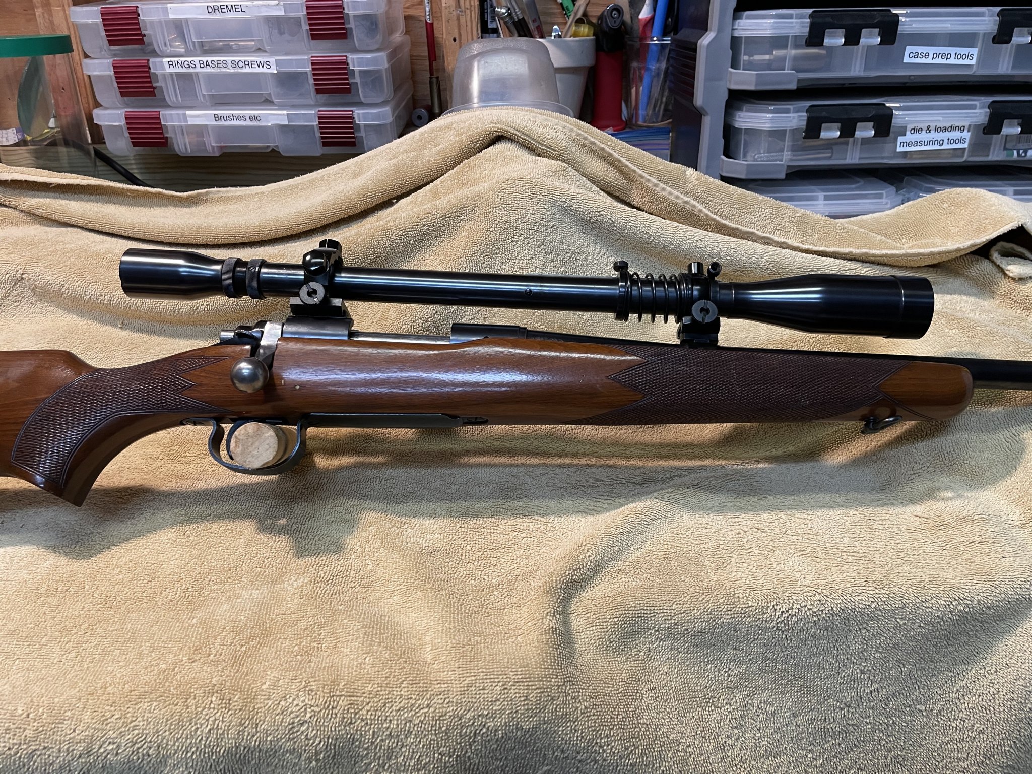

I have a 722 in a Fajen stock. I got a Jewel trigger for it and it fit the action just fine. The only thing was it is so far back that it actually touched the trigger guard. I just used a flat washer on that action screw to lift the guard up a little. IMG_20220713_165818098_HDR.jpg

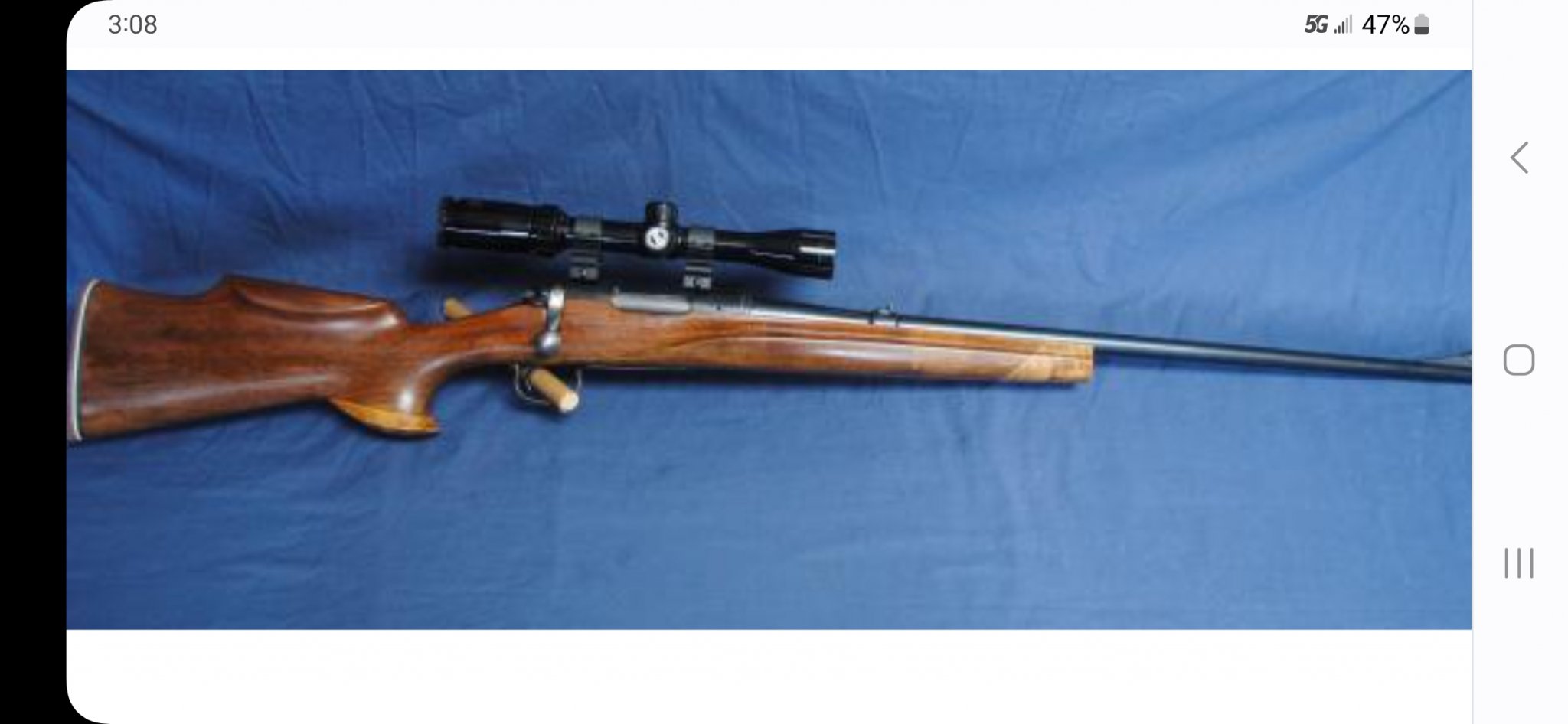

How can you tell which variation it is? Looking at buying a 722 in 222 and never seen a stock like it before

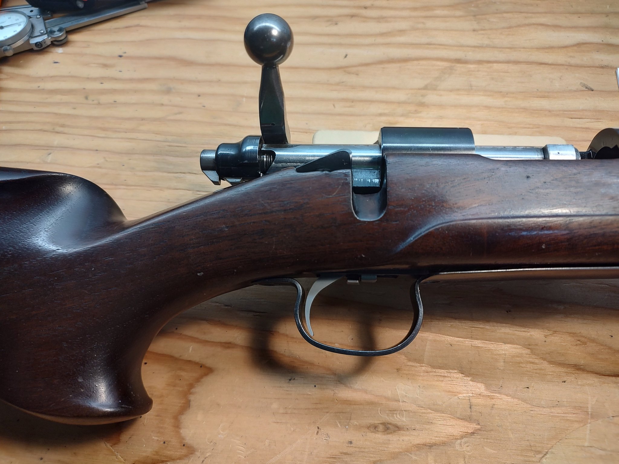

I inherited one from my dad. He shot ground hogs in VA with it. Rem 722 in 222. He made the stock himself out of a piece of wood that was intended for individuals to make their own stock. Some ancient reloading gear also. In the safe and will continue to be a family heirloom
How can you tell which variation it is? Looking at buying a 722 in 222 and never seen a stock like it before.
I would venture to the Remington site. But they rarely show much on stocks. Yours looks to be a varmint type stock. It could be factory ? I am not sure. Or it could have been a aftermarket put on in later years. I have seen these stocks in the past just not sure who produced them. You have a beautiful piece there. I wish I could help you out more. If I run across some literature I will refer back to you. I am leaning more to a aftermarket. Possibly when they were shooting competitions. It was a big thing back in the day.
Thank you for the information! I'll try the remington site.
Okay. I was wondering more about the stock on mine. Wondering if it's original or aftermarket
Since buying mine I have researched them a fair bit and don't think your stock is anything Remington produced.
If you decide to replace it I might possibly be persuaded to take it off your hands. ;-))
I had been kicking the idea around about buying a .222 and the stock is what made me pull the trigger! I was just wanting to know if it was original or not. Only 1's I've seen similar have the black painted on where this 1 is blonde.
This has been restocked with a stock most likely from Reinhart Fagen - definitely not a factory stock. Probably done in the late '60's or '70's.
