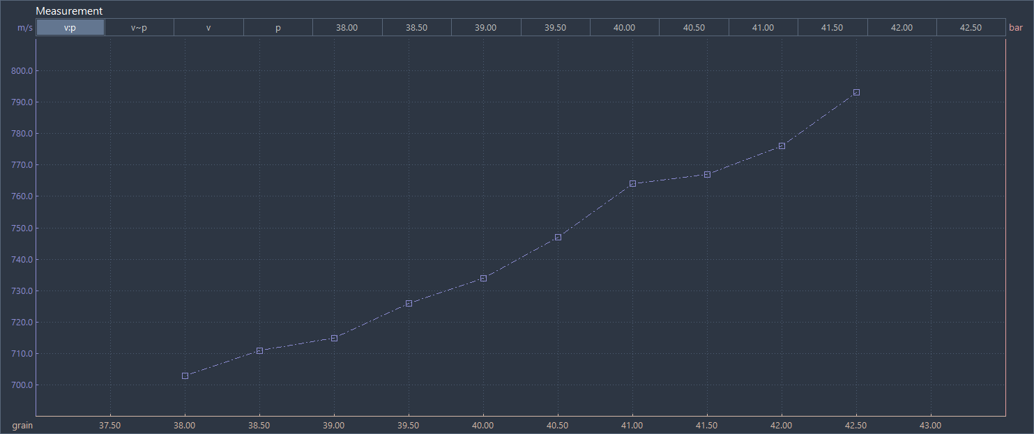

vbogoev:
You’re going to end up around 43.5-44 grains with this combo and your loads at 42grs will be slow. Tikka barrels are slow and people naturally want to be in the 2750 FPS range with 140s and 24” barrels.
Every bullet/powder/primer/barrel combo is a little different. You’re just going to have to see for yourself. In my 24” barrel (not a Tikka) I get good groups around 2.810” and 2.850” with the 140 ELD-M doing about 2730 FPS. I think those are common coals where people find accuracy. They are a good place to start.

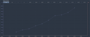

You're absolutely right. I went to the range and ended up with a slow velocity even at 42.5. That was the maximum load I had so I'll continue upwards as far as I can, because the case capacity is starting to be a problem. These days I'll make additional tests. I decided to test at CBTO: 2.2580 (-0.020) and I had no issues at all. I was surprised from the group also, given the fact I had a bad mirage due to the cold weather and no time to wait for the barrel to cool down enough. The group is at 110 yards. Max velocity so far at 42.5 - 2601fps. I had 2 rounds at 42.5 and both were with exactly the same speed.

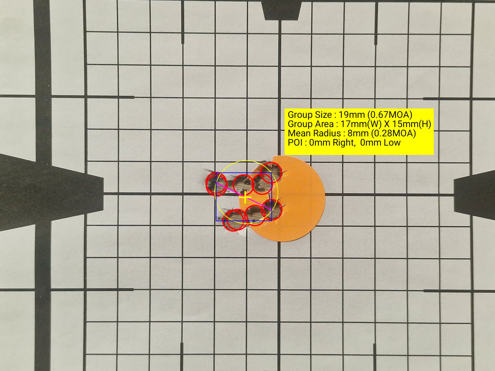

Were you making windage corrections in that group, or is that just how they flew? If one can draw a definite line through their impacts like that it is a tell tale sign of body position/NPOA. (Natural Point of Aim) If you were clicking, that scope tracks really good. Your elevation is balls on!
