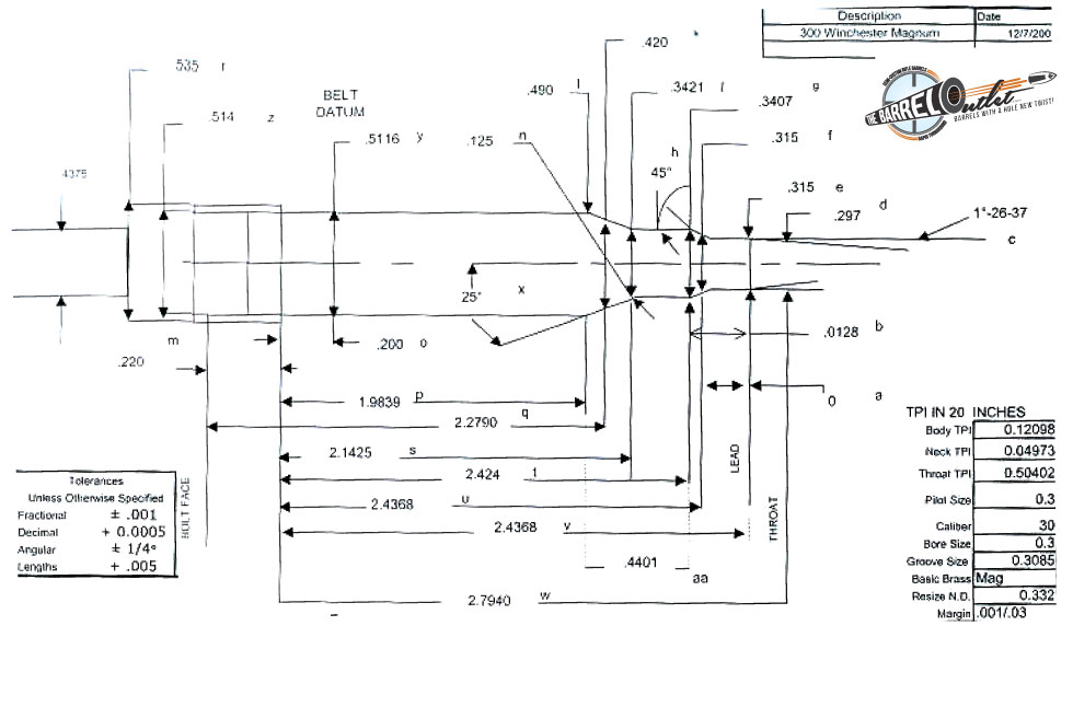

I really can’t with you. Show me the taper wall you speak of?? “BTW, the sides of the case are tapered too”

Go measure a case...mine .509 above the belt and .486 below the shoulder. 🤣🤣🤣

I set up just like a non-belted round. Using a fireformed piece of brass, I only bump the shoulder back 0.002". Every other shooter I know that shoots a belted cased round does it this way. With my 300WINMAGS, I usually have to use the collet die after 3-4 firings. Same for the 7mm Remington Magnum.
Edit to add: The case is most definitely tapered between the belt and shoulder.
