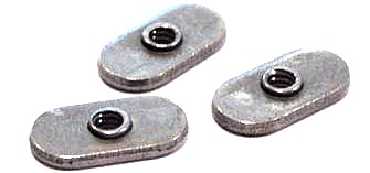

I'm not the OP but I found these pics on Google, looks like it traces back to this post. Looks like it's pretty straight forward and if I was doing this I would maybe use 10-32 screws and weld nuts as it would probably negate the need for epoxy.
Good Luck!
