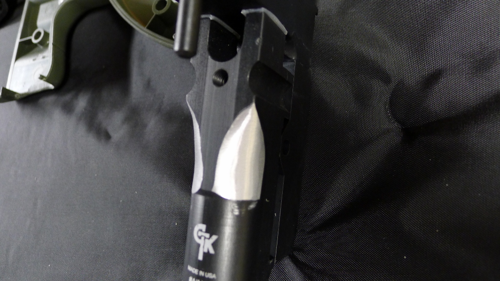

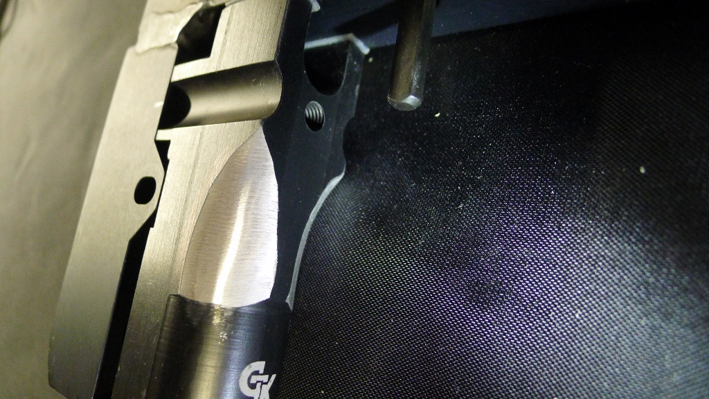

Next is the crappy part. Having to machine or grind on the beautifully crafted monopod. The squared off part needs to be rounded off a little farther up. The stock curves back and the square edges of the monopod hit. This was gut wrenching but easy and is covered by the stock anyways. Here it is modified. P1020995 (1024x576).jpg
After I took material off of the monopod It was easy to see what plastic to remove from the AICS. One little piece of webbing needs to go and you can basically cut a circle bigger than the knurled ring of the monopod. I used an exacto knife but alot of you are the "Charlie Daniels" of the dremel tool so that works good too.P1030005 (1024x576).jpg

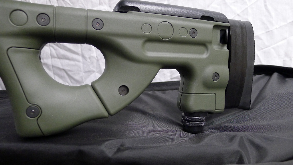

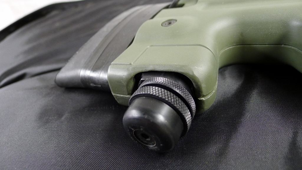

When I got it done, I was happy with the results. It looks great and is out of the way. The knurled adjusters are easy to operate. It is an awesome addition to this rifle. Now I just have to wait for the sub zero temps to go away so I can try her out.P1030003 (1024x576).jpg
