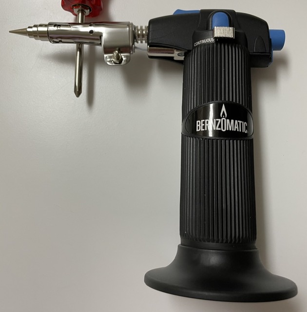

Also on small loctited screws you can use a soldering iron tip to heat inside the head to break the loctite bond. Or you can heat a finishing nail with a lighter, not red hot just good and warm, and that might help.

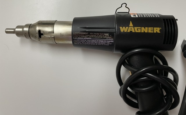

My trigger bolt is really in there. My 5mm hex is bending. Spent about 5 minutes with a soldering iron on 30watt setting and it’s still not budging. Should I hit it with the propane torch?
Mine was the same. In really tight.
I used a maxed out heat gun and an extension pipe to lever the sucker off.
Keep at it son!
Reactions: ElFuego
Keep at it son!
Thanks. I temporarily gave up and went ahead with mounting the new Bifrost stock. But first, I backed out the factory spring preload to the max and honestly, it is pretty light. I will probably take it back out and heat it up again but probably with a torch this time.
Reactions: Anzac
When it comes to Loctited screws, especially Red, I try the heatgun first and as a last resort the torch.

I got a heat gun today so I wouldn’t discolor anything. Put about 6minutes worth of the 600* setting and thought I’d still break the Allen key. Put another 1.5 minutes of the 1000* setting and with a cheater bar it broke free. Elay spring is now installed, not that the trigger really needed improving. It’s noticeably lighter and the factory spring had been set at its lightest. Now it’s set at about 50% of travel. Sorry about the empty reply above - didn't realize I had shot a blank and I don't see a way to delete it.
