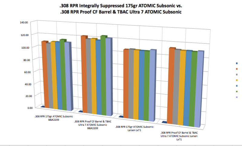

    Comparison for Reference Only
    [IMG2=JSON]{"data-align":"none","data-size":"full","src":"https:\/\/www.snipershide.com\/wp-content\/uploads\/2017\/08\/Screenshot-2017-08-29-16.20.12.png"}[/IMG2]
    6.5CM RPR 140gr Hornady ELD B&K22096.5CM RPR THUNDERBEAST ULTRA 7 6.5 140gr Hornady ELD B&K22096.5CM RPR 140gr Hornady ELD Larsen LxT16.5CM RPR THUNDERBEAST ULTRA 7 6.5
    B&K2209B&K2209Larsen LxT1Larsen LxT1
    120.00140.00119.00124.20
    129.50130.00115.60122.00
    124.00132.00116.30121.70
    129.50128.00116.00122.50
    126.50134.00116.50123.10
    130.00132.00116.50122.90
    124.00130.00115.90122.90
    116.00130.00115.50122.40
    129.50116.70
    NR116.10

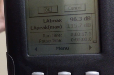

    You should probably figure out how to use that meter. The striker alone will meter higher than your imaginary numbers.
    Great 2nd post, JFettig. This must be a Hide record to achieve the rank of Uniformed Shitbird in 2 posts. How high did your Airsoft striker meter?
    Did you test the striker on that rifle from the front ...
    So you are saying TBAC has not idea how to use the meter ...
    There is a difference between metering the front and sticking the meter at the receiver
    The funny part is the entire thing was shot on video, I have hours of footage, I will string it together to "prove" how this was done and the numbers as recited in real time ..
    Argue that with the resident geniuses, it's unmistakable
    Im thinking someone doesn't know you were using DOD testing protocol as well which is very specific as to where the meters are to be while testing.

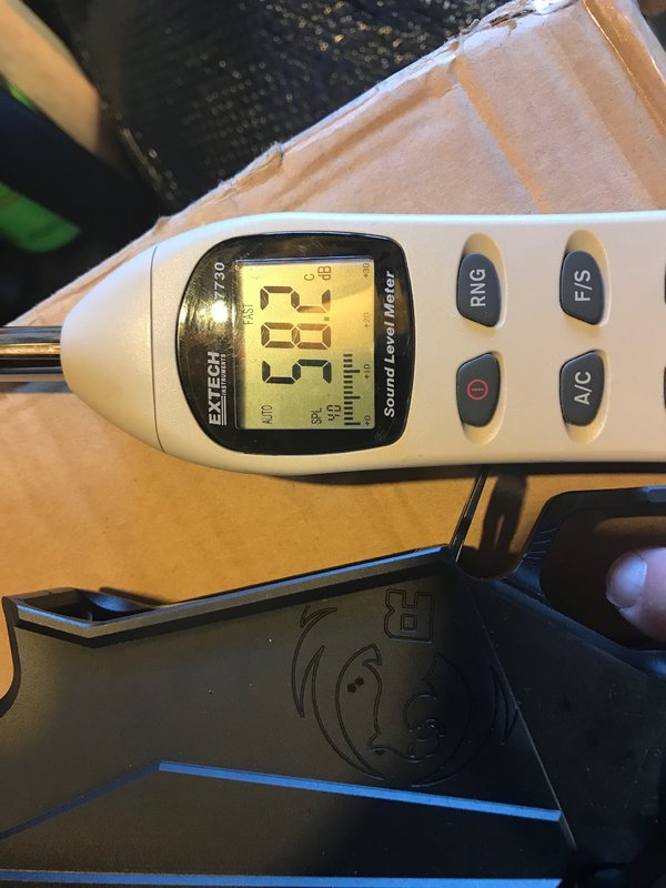

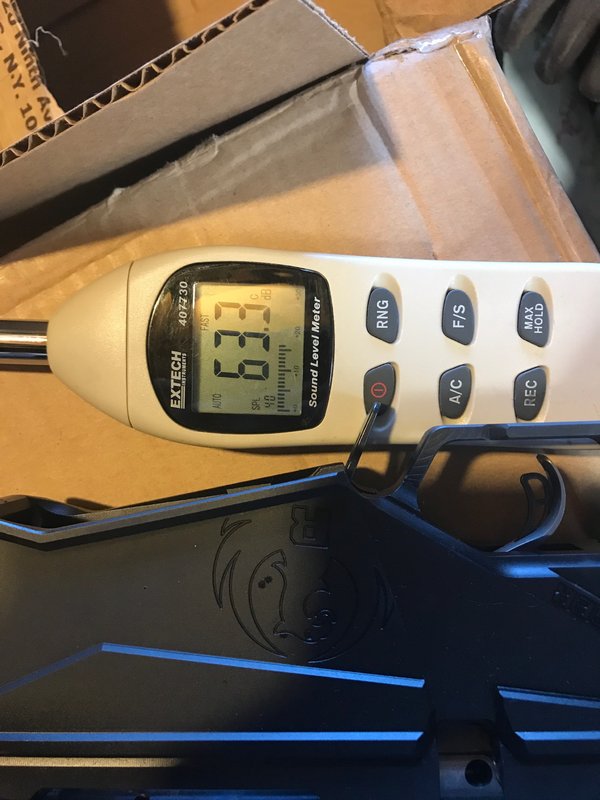

    I asked Alan to ask Ken (who has a Larson Davis LxT) to check the 556 RPR when dry firing
    But with my cheesy Amazon meter, it reads right around 60db, the loudest I got with the meter right next to the receiver was 63db most cases it was around 58 db IMG_9000.JPG
    I know it is a shit meter, but it just reading the click of the dry fire... firing pin fall, so it's not a gunshot.
    I know Alan is at some Machine Gun shoot, so he will have to contact Ken, etc, I don't have the Witt contact details to call them.
    it is a pulse measurement which is a loud sound for fractions of a second. To accurately measure you need a mic with a 20µs rise and a sample rate of at least 102.4khz. With a slower sampling mic you don't actually catch the peak sound waves you catch the backside of the slope so its an artificially low number. FWIW there aren't any hand held mics that I am aware of that hit the current milspec (MIL-STD-1474E) for silencer (impulsive noise) testing. Not trying to shitpost just talking fact.
    4.7.5.2 Recording equipment for impulsive noise. Equipment for capturing and storing impulsive noise shall have a minimum of 16-bit resolution, with 24-bit resolution preferred, and a sampling rate of a minimum of 192,000 samples per second. The analog signal shall be filtered, using a Bessel type with a 40-kHz cutoff frequency. The roll-off rate shall be not less than 36 dB/octave.
    Well aware of that, but clearly there is a difference in dry fire, firing pin sounds...
    Look at the meters we used, both are calibrated, one digital and one analog that is MilSpec
    The guys arguing the numbers are saying two things,
    1. The Larson Davis was not read correctly, the wrong number was taken, not the peak but the max
    2. Ray from TBAC did not set up the B&K 2209 correctly,
    So, while the test was conducted with a 3rd party (Ray from TBAC) and we used two completely different meters for comparison, this was a bad test.
    even the guys arguing the numbers as false, (Who are direct competitors by the way) they had a video were the firing pin was 116db and their first shot metered at 115db
