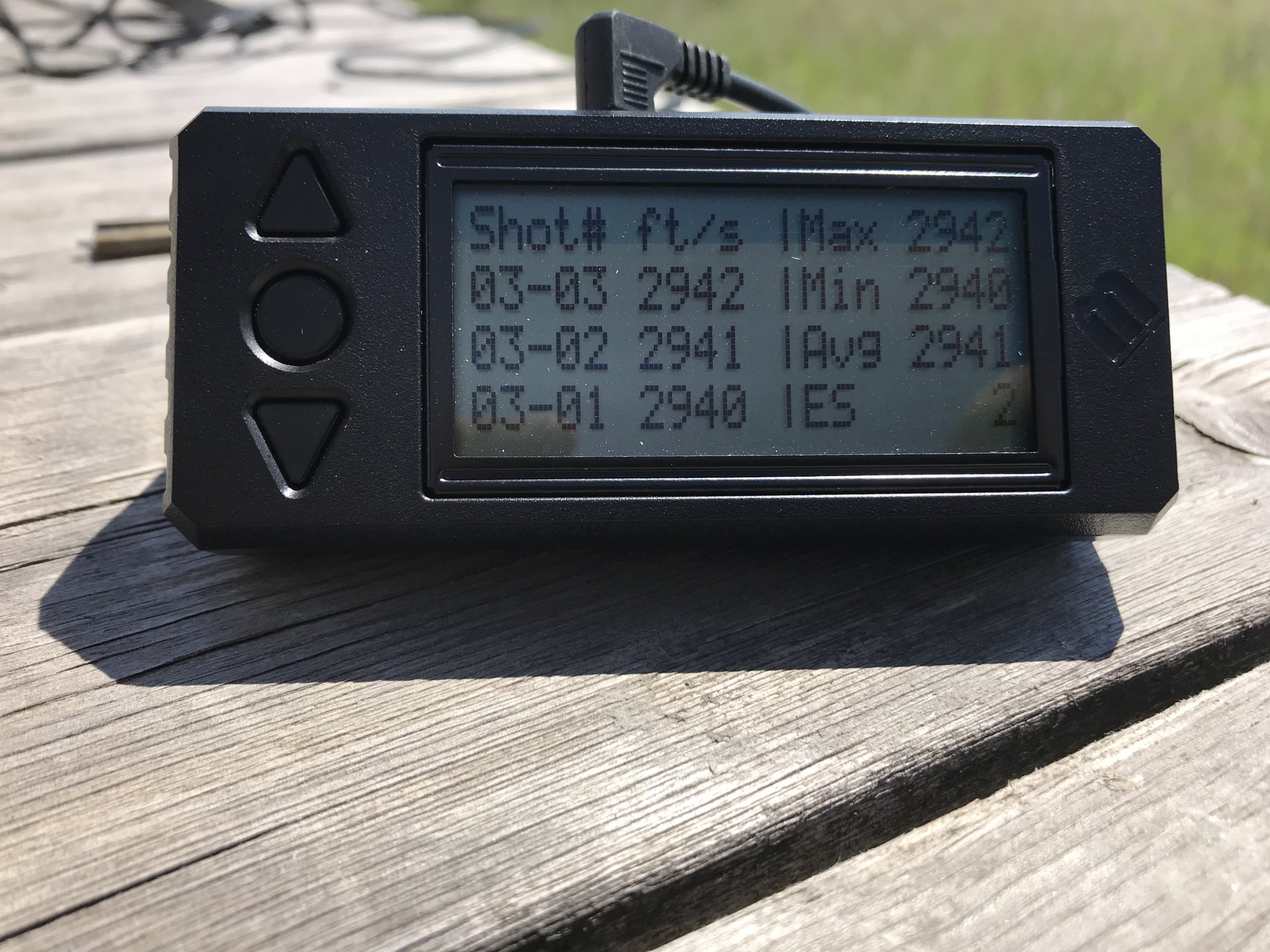

Not sure but I get es of 3 in my 243 w/10 group
Not to detract from a nice load, but 3 shots is an extremely small sample to try and verify speed data. I try to get a minimum of 10 to give me a level of confidence that I’ll take to a match. The farther out you’re shooting, the more important it is for the sample to be larger.
i took the pick after 3 shots( doing load development and feeling pretty proud of my self) then walked back to the house and loaded 20 more. Shot 7 more with the magneto speed on. Then put the next 10 on a 10x10 plate at 735 yards.
If you notice in the pic it says es of 2. After shooting 10 rounds over the v3 my es increased to 3. I forgot to take a pic afterwards.
I have repeated the velocity test several times and es of 4 was my worst.
It’s a great load and I’ve taken that 243 out to a mile with 115gr vlds.
