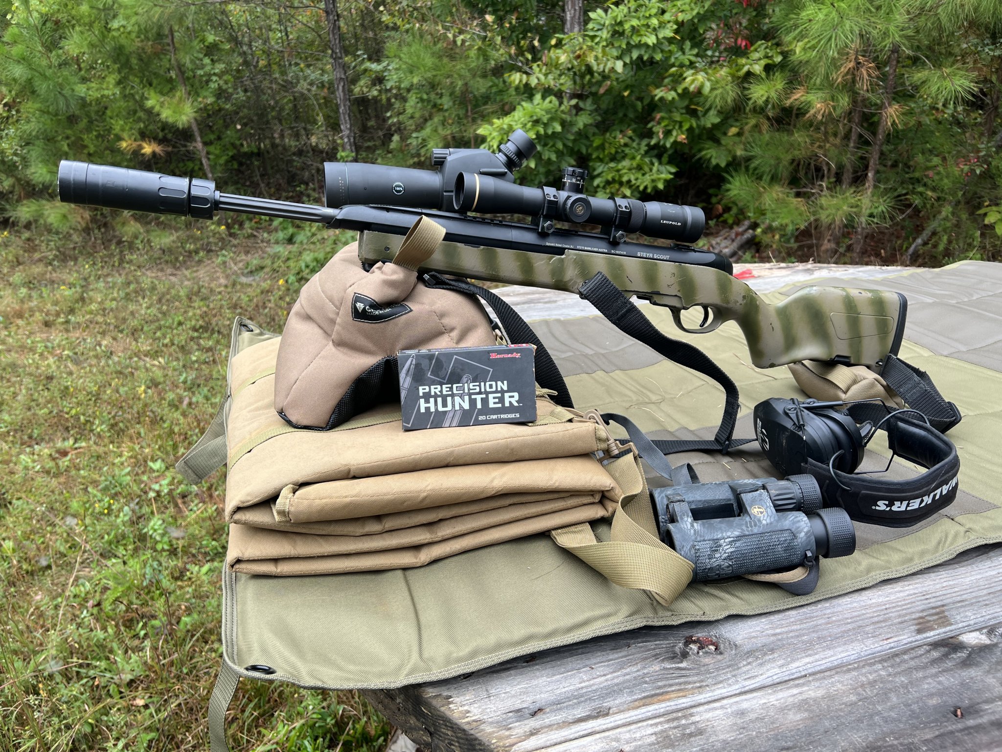

My thing has always been the scout rifle concept. For the past 30 years, I have been dabbling in Cooper's concept of the general purpose rifle. I've taken several classes for this and become reasonably proficient with a 7 pound rifle from bad breath distance out to 300 yards. But for the past couple of years, I've wanted to stretch the limits with this platform. I entertained the idea of taking a long range class with the Scout rifle and even thought about trying one of the NRL Hunter matches with one. Then reality sunk in and I have come to the conclusion that this would be a complete waste of time and money. The Scout rifle platform just can't work at truly long ranges without changing so many things that it gives up the handiness that makes the rifle so appealing to me in the first place. Yes, I could put an Atlas bipod and a 20X mil/mil scope on it and it would be capable of 1000 yard shots under the right circumstances. I could learn everything about how to use a mil reticle and use weaponized math and all the rest. But it wouldn't be what I really need and that is a general purpose rifle.

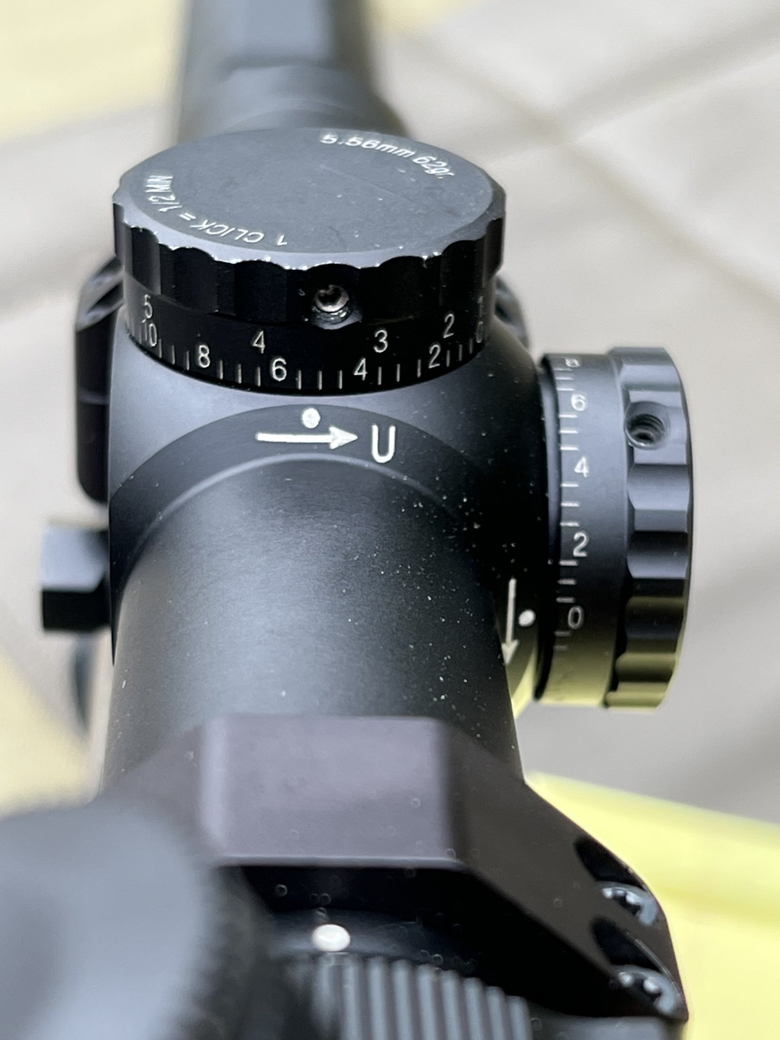

So now I'm concentrating on figuring out exactly what I can do with a scout. I recently gained access to a property where the landowner allowed me to cut a small stand of trees to make a longer range. So far, I can get out to 360 yards. Over the winter, I think I can work on it a bit and get out to 470 yards.

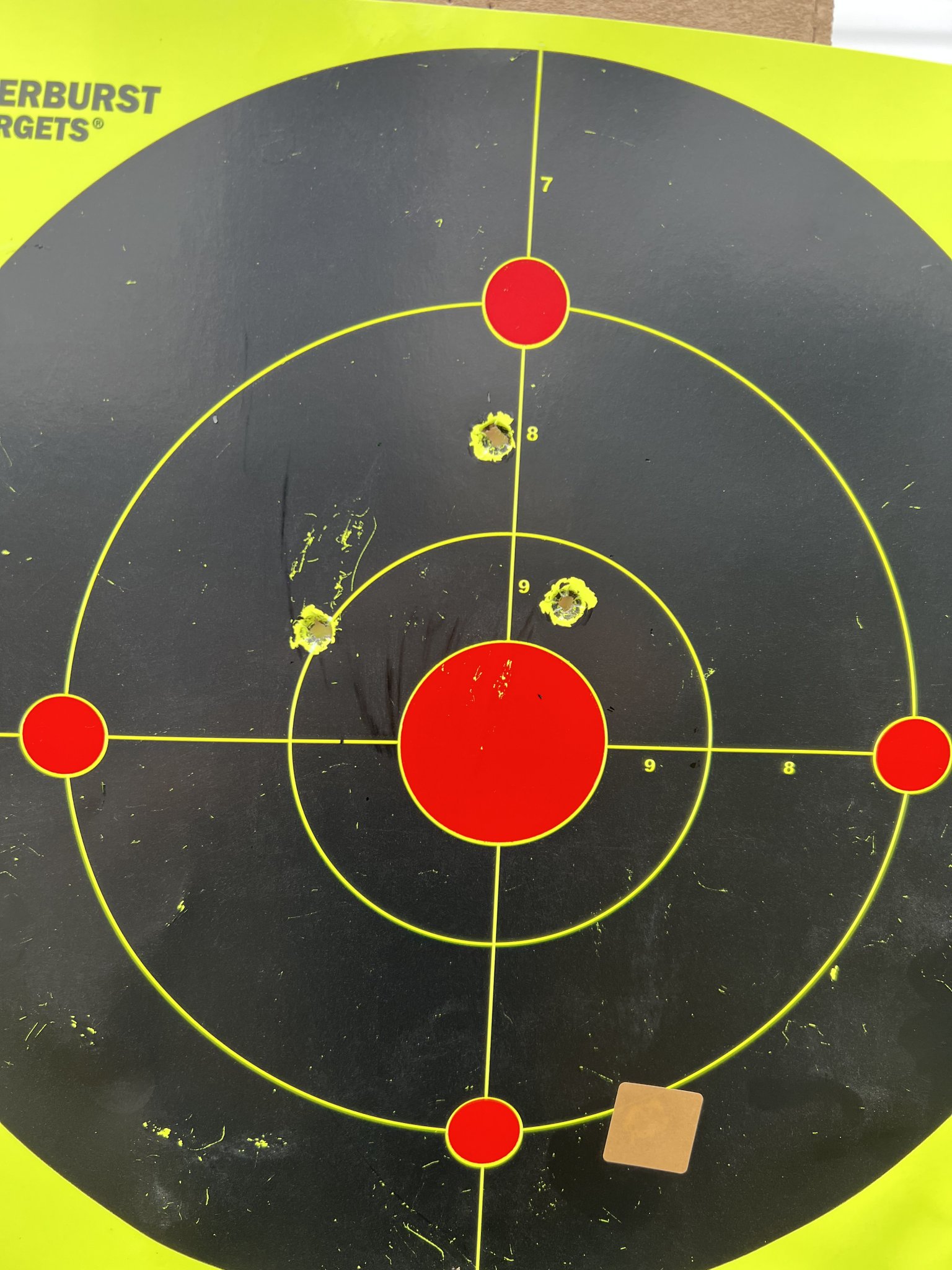

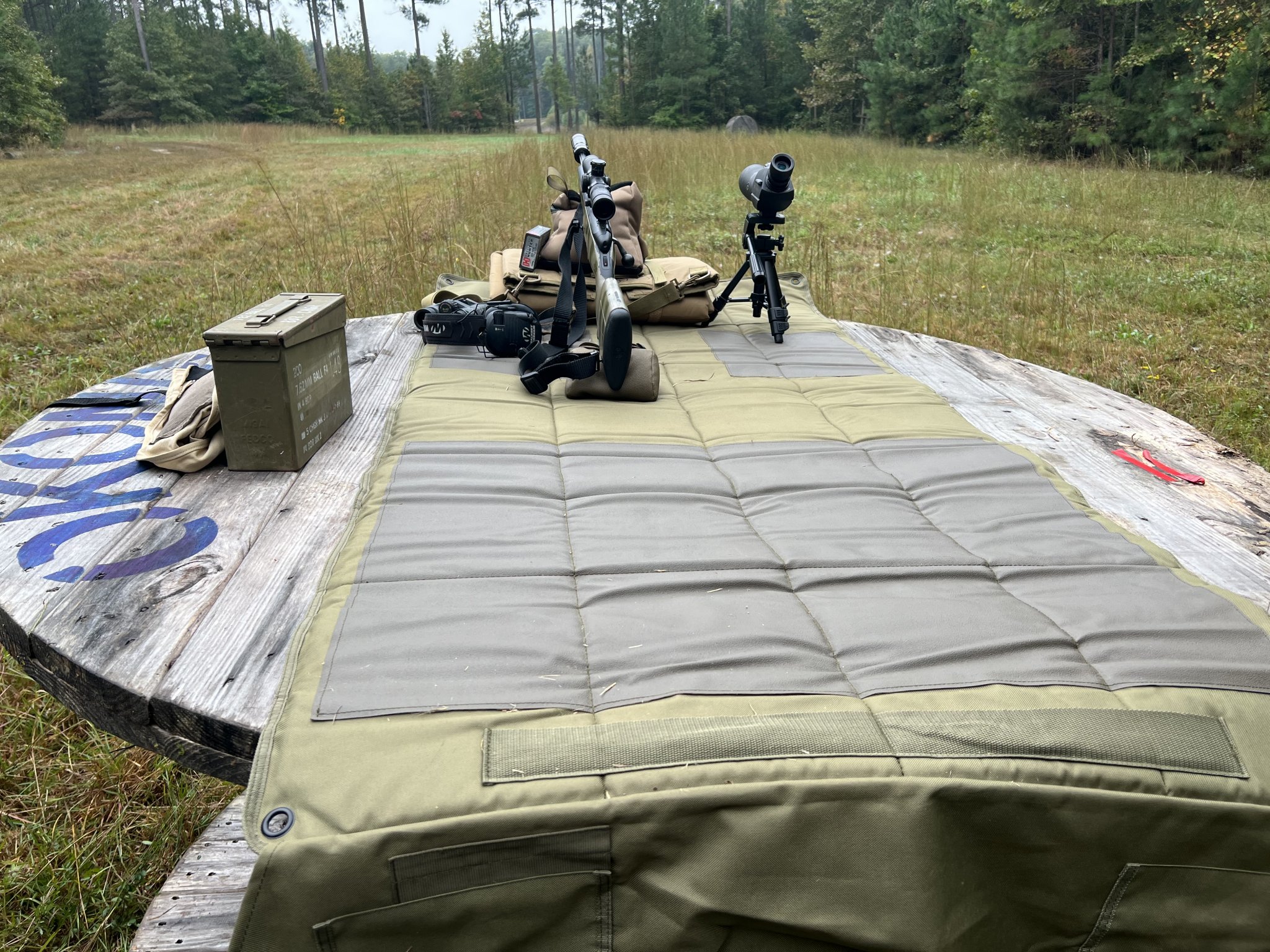

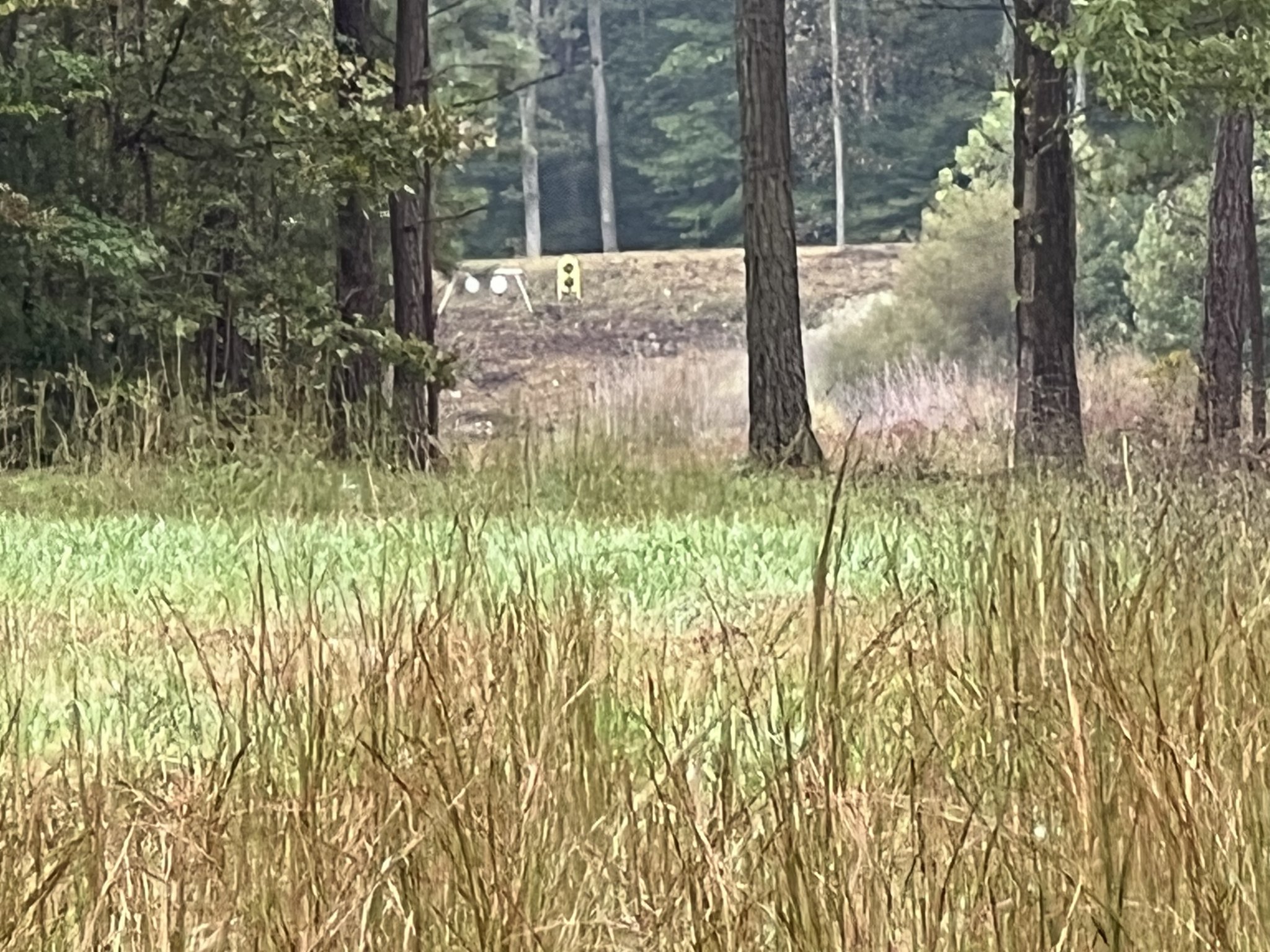

I got to shoot it at 360 yards for the first time yesterday. The results were very encouraging. I have two Steyr Scout rifles and one did considerably better than the other but both show promise. The best was with my heavily modified Steyr. This rifle has the barrel shortened to 16" and threaded. I added a Rugged Micro 30 suppressor, removed the folding bipod and dropped about half a pound from the stock. The scope is a Leupold VX-R Scout 1.5-5X with a Kenton Turret. Total weight including sling and suppressor is just over 8 pounds. Shooting Hornady ELDX 178 grain ammo, I was able to consistently get 2" groups. With M80 ball ammo, that opened up to about 5" which is still less than 2 MOA. I was ringing steel (10" and 12" plates) with boring regularity even when I moved off the sandbag and was just shooting slung prone off my elbows. At 360 yards, the Hornady ammo needed 6.5 MOA and the M80 ball was 6 MOA from a 100 yard zero.
So it is a good start. That particular scope is VERY clear and crisp and I didn't have trouble seeing the target or the steel at that range. I'm looking forward to moving out another 100+ yards and see what happens. I wish I could find a 600 yard range around here as I think that is probably the limit for this package. I also wish there was training for this kind of intermediate range. It doesn't have the bragging rights of a 1000 yard shot but it can be done with a common hunting rifle without adding a lot of weight and complexity. If anybody has a suggestion on that kind of training, I'd love to hear it. I'd also take suggestions on how to adapt what is taught at the true long range classes for this kind of shorter range shooting. For instance, I discovered that while wind isn't as big a deal at 360 yards as it is at 800, it isn't a non-factor either and I'd love any pointers on that.

And, because no one else has definitively stated it- I’m calling BS on your accuracy claims. But, that’s ok because you don’t care anyway. Neither do I, really.
I’m not calling BS, I had very lucky cherry picked 3 shot groups. Although I do wonder because the VX-R has such a huge thick reticle, mine were a bitch to get sub moa at 100 yards with a 3/8 moa rifle just by the thickness of the reticle, I mean it would almost completely cover a 6” target a 300 yards.

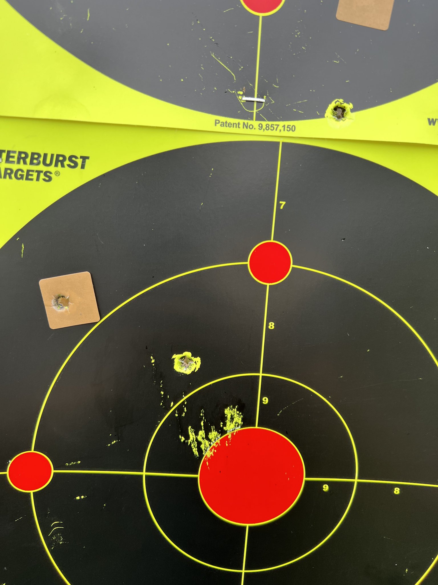

First of all, keep in mind that this isn't 5 shot groups. It is 3 shots and that is due to the cost of ammo but I understand that this doesn't give me as much info as a 5 shot group would. Next, I was shooting two different rifles that day. Both are Steyr Scouts. One is a bone stock rifle with a Leupold Mark 4 MR/T 1.5-5X scope and the other is a heavily modified rifle with a 16" barrel, suppressor and a stock that I've removed the bipod and slimmed down. It has the VX-R scout scope which does NOT have the thick reticle of the fixed power scout scope. I was also shooting at high contrast targets which were easy to see. During this range session, I would shoot three through one and then three through the other and then go check targets.
The modified rifle is one that I've owned for 20 years and I have put a lot of rounds through it. I am not the kind of guy that shoots 10 rounds before hunting season and calls it good. I've taken 5 scout/practical rifle classes with it and I know very well what it is capable of within 300 yards. Never in my years of shooting it has it ever produced results like I experienced this week. In the past, it would put 2 rounds nearly touching (at 100 yards) and other would be either high or high left, opening it up to 1.5 to 2 MOA groups. Shooting with M80 ball, it would be more like 2 to 2.5 MOA.
On Wednesday, I did something different. I hypothesized that the lightweight gun was jumping off the front bag before the bullet left the barrel, causing inconsistent impacts. To try to cure this, I put my forearm through the sling loop up to my elbow and then used a rear squeeze bag at the rear. This put just a little tension on the sling. It wasn't enough to affect the steadiness of the reticle but it seems to have been enough to control the rifle from bouncing off the front rest. It appears to have worked because the groups got amazingly tight. That pic isn't an aberration for the day. It is what this rifle was doing both on paper and on steel for the whole range session.
Now... the other rifle wasn't doing the same thing and I'm not sure why. I've got some suspicions about the scope at this point or maybe it is just lumb luck. The only other target pic I took shows about a 6" group with the same ammo. I was having some wandering zero issues that I need to sort out so there are questions here.

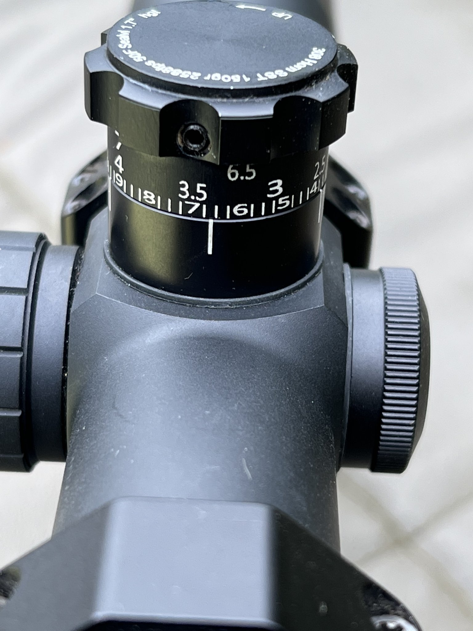

About those scopes... in theory, they are pretty evenly matched with the Mark 4 having an advantage of a BDC reticle. In reality, the VX-R is FAR superior. The image was brighter and more crisp. Colors were a bit washed out on the Mark 4. The VX-R also has the advantage of eye relief in that the brim of my hat doesn't get smacked at every shot. I was VERY happy with the VX-R and I'm even more annoyed that Leupold discontinued this model 2 years ago.

You don't mention how much ammunition testing or reloading you have done for it, but there may be some left on the table for tuning the ammunition to that specific rifle since you have a short / thin barrel and probably not a fast twist if it's an older factory rifle.
You're shooting a pretty heavy bullet, have you tried going to something like the match 155gr stuff with a faster burning powder?
Also I'd suggest you consider a scope upgrade such as the Razor HD LHT series.
Perhaps softer shooting bags that your rifle can dig into a little bit more might be worth a try.
I've tried a variety of ammo and while it seems to prefer lighter bullets, they have all exhibited weird groups... more like patterns (several nice tight groupings but a few fliers that don't seem to have any rhyme of reason but all are high or high left). The 178 ELDX is as good as I've found. It actually isn't hateful with milsurp ball but those fliers are more widely disbursed.
The barrel twist rate is a good question and I'll have to figure it out. The stock 19" I'm sure is the 1:12 but the 16" barrel might not be. When I sent it off to be shortened, it had the older pencil thin barrel on it and the guys at ZR Tactical said there was not enough metal to thread it to even a 1/2-28. They had a spare barrel laying around that came off another customer's rifle that they rebarreled to 6.5 Creed. It still didn't have the thickness for a 5/8-24 but they were able to thread for 1/2-28. I suspect it is a 1:12 but there is a possibility it is the rare 1:10.
The Razor suggestion is one I may look into. Its funny that you don't know how good (or bad) something is until you see something dramatically different. That Mark 4 scope has been moved from rifle to rifle for years and I've been happy with it but when used side by side with the VX-R, I realized just how washed out it is.
