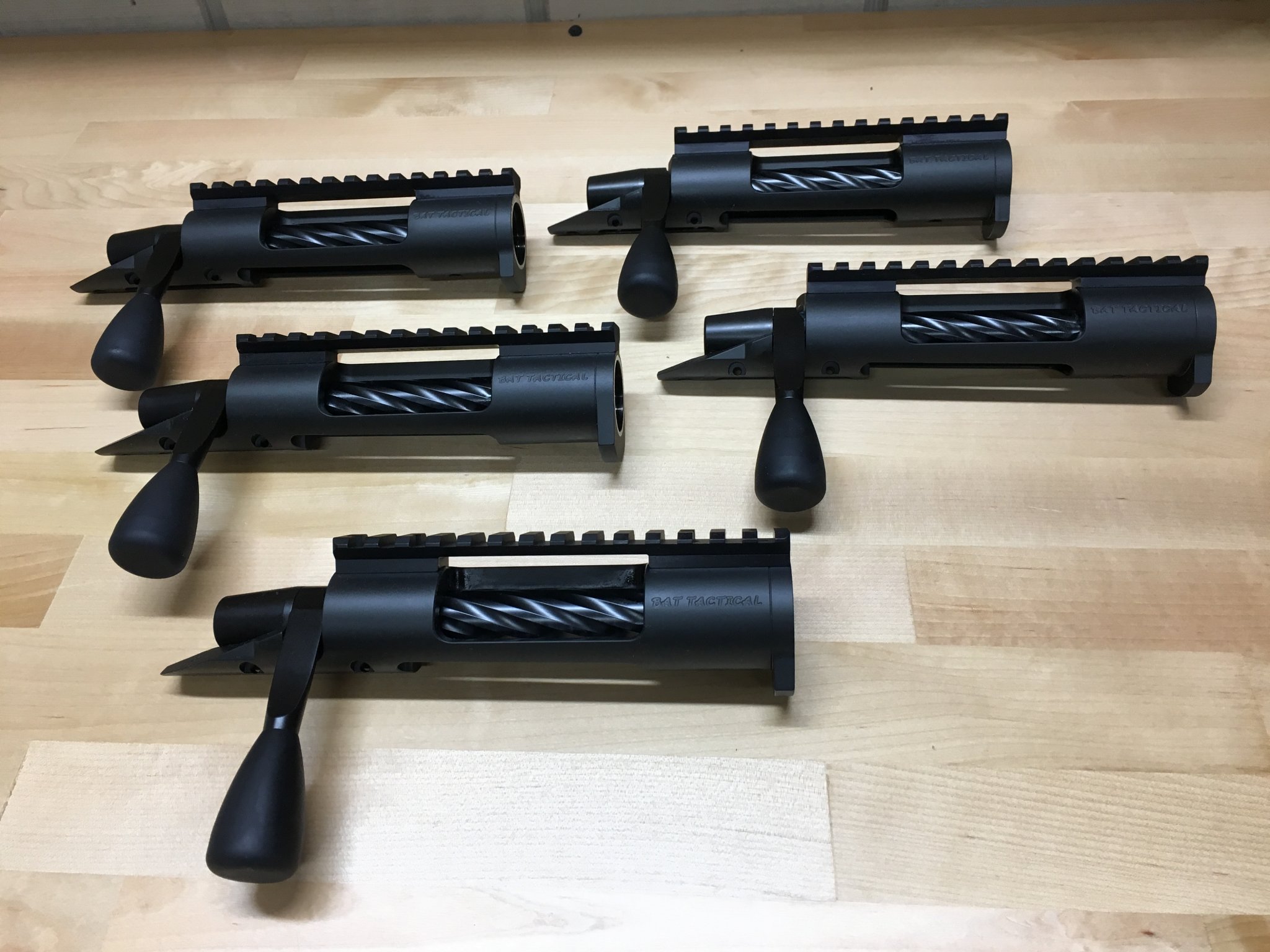

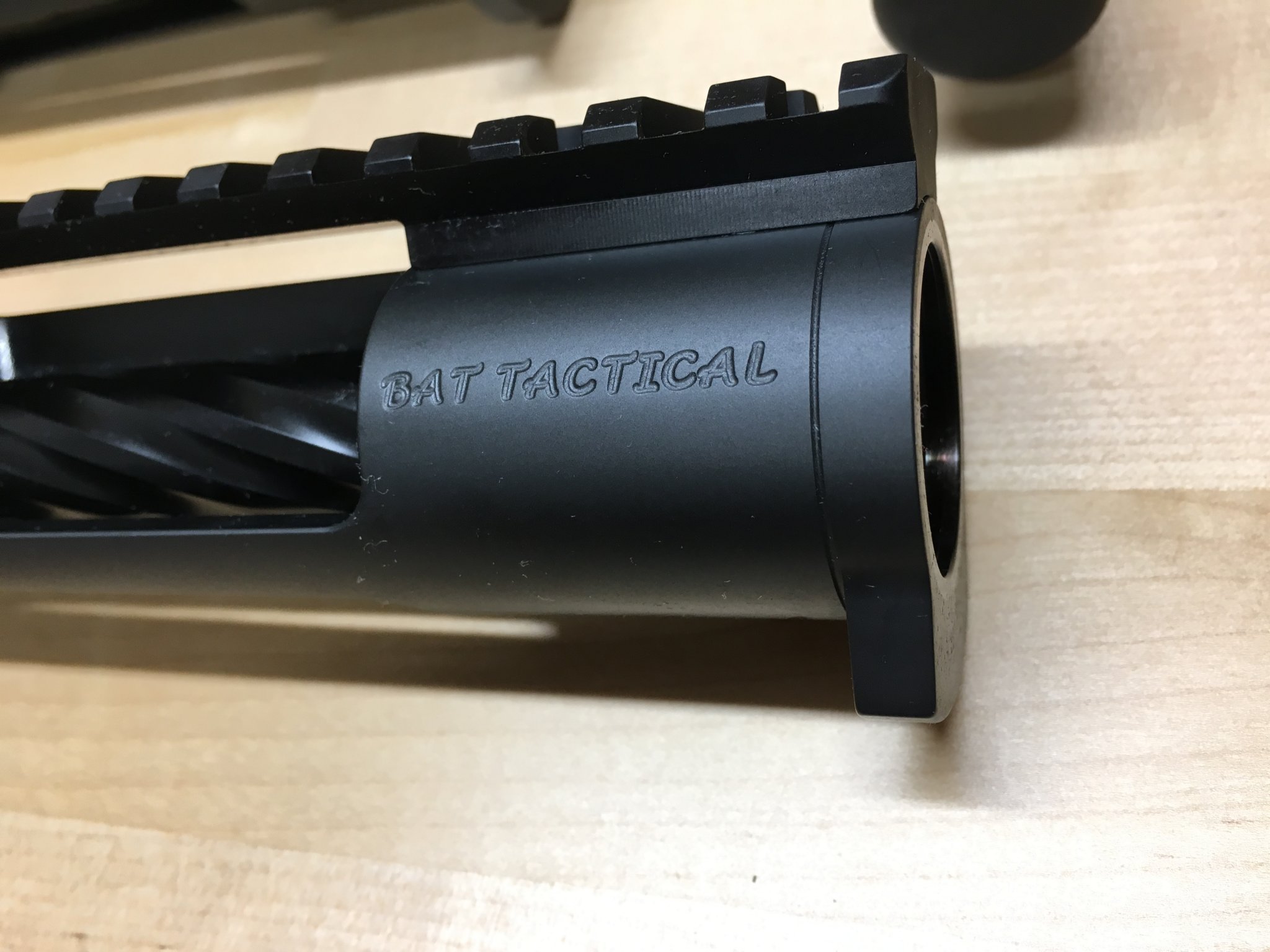

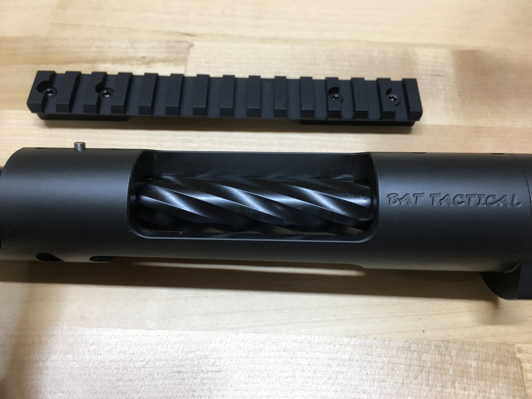

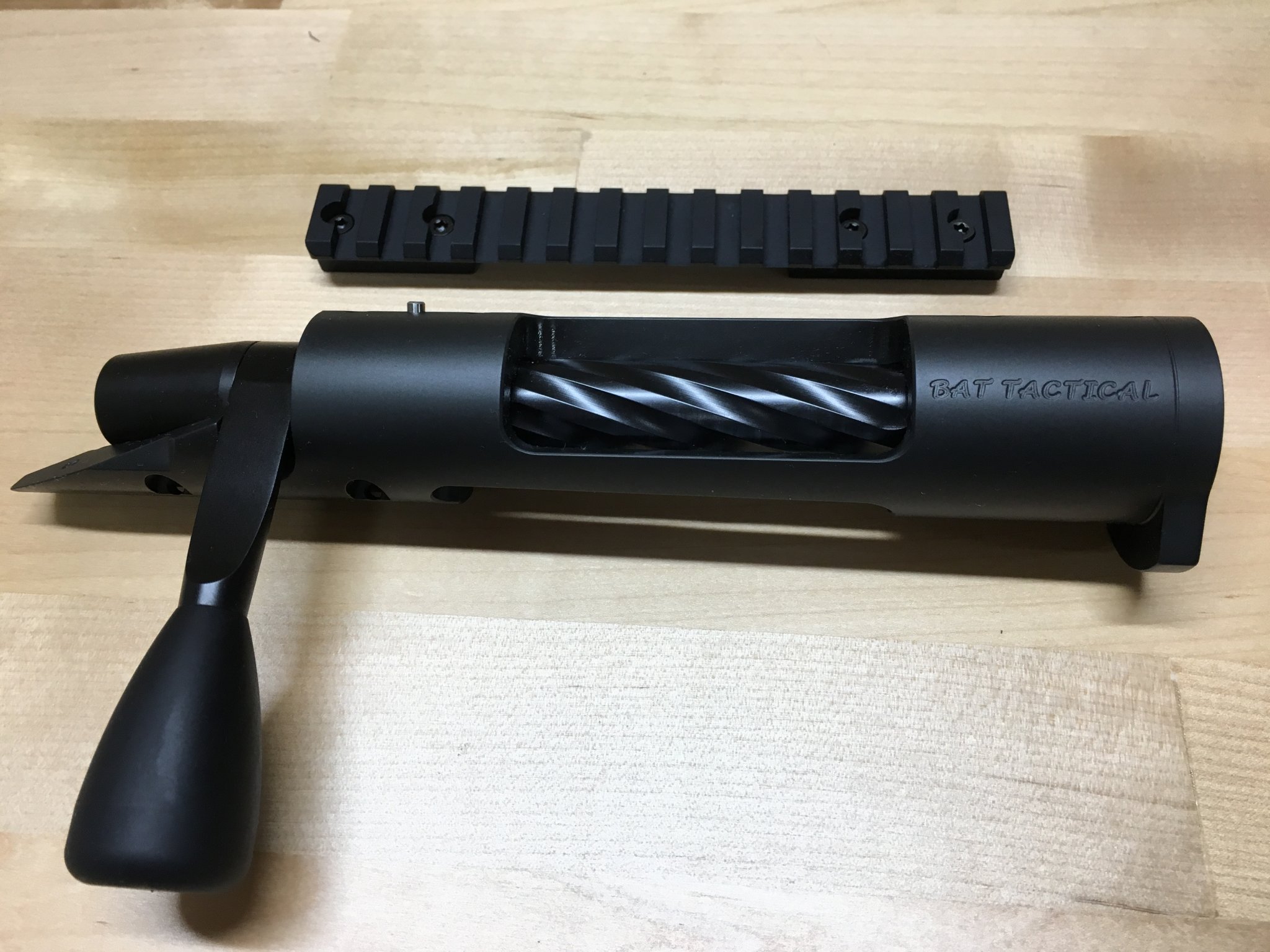

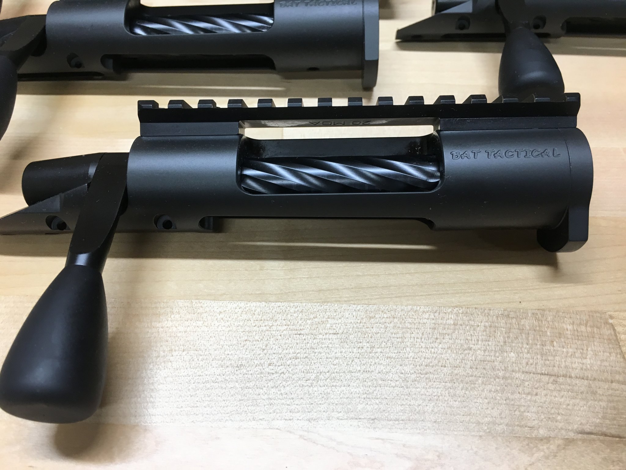

We are really excited to introduce our new BT action. It has all the accuracy of the original Bat Tactical Action, but now weights 1/4 pound less and retails at $1385. It comes with an integral recoil lug, pinned aluminum 20 MOA rail, Ionbonded action, and Melonited bolt body. This is a great option to make a really accurate hunting rifle or a tactical rifle. It is also set up to work with our Rifle Chamber Cylinders which really sets us a worlds apart from anything else on the market.
Thank you for looking and if you have any questions please feel free to call.

My friend has one of the original Wolf Tactical Bat short actions which I've shot many times. It's nice. Both he and I prefer the integrated recoil lug and 1911 rail even though it's non-adustable at a mere 20MOA cant. The locking lug surface area seems a bit small for high pressure "Magnum" cartridges in comparison to say a Remington 700 for PRC/SAUM/WSM type cartridges. The melonited bolt and action run very smoothly though with such tight bolt-to-raceway clearance.(y)
