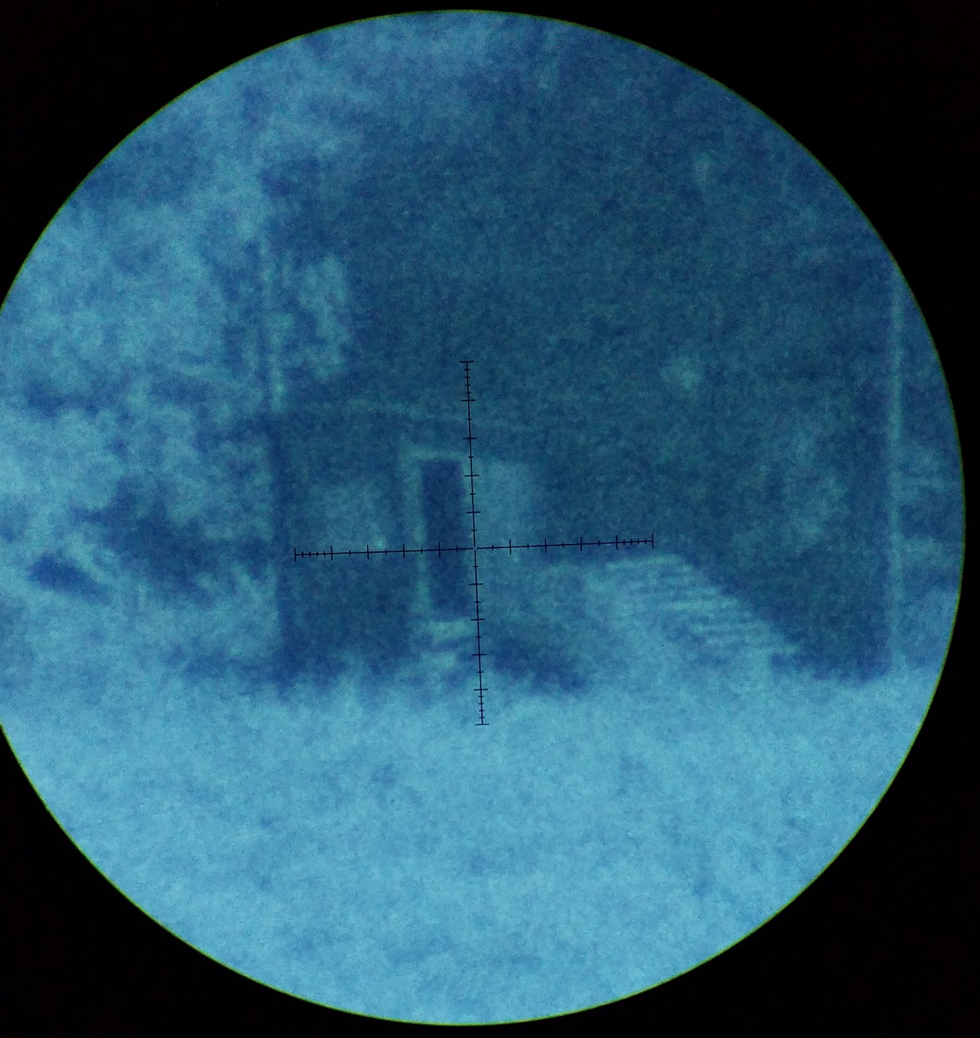

There a PVS-30 with the ELIR-3 on 3 o'clock, radius on top ... 5.56(18) rifle with xtr2 3-15x scr-mil ...

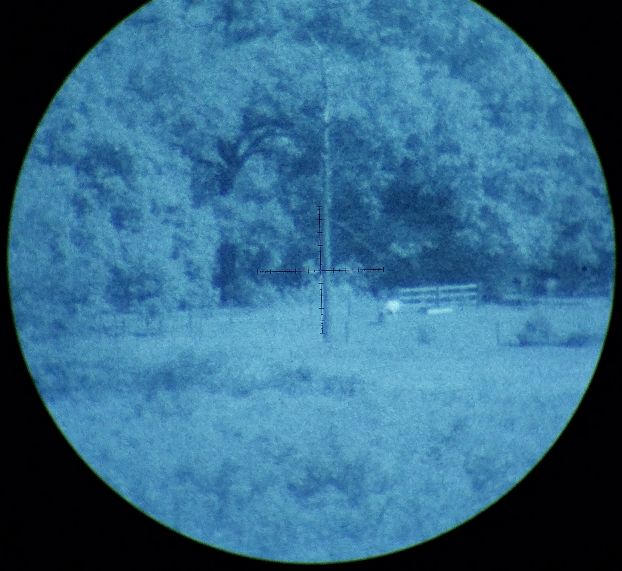

Mineral feeder 415yds without ELIR-3

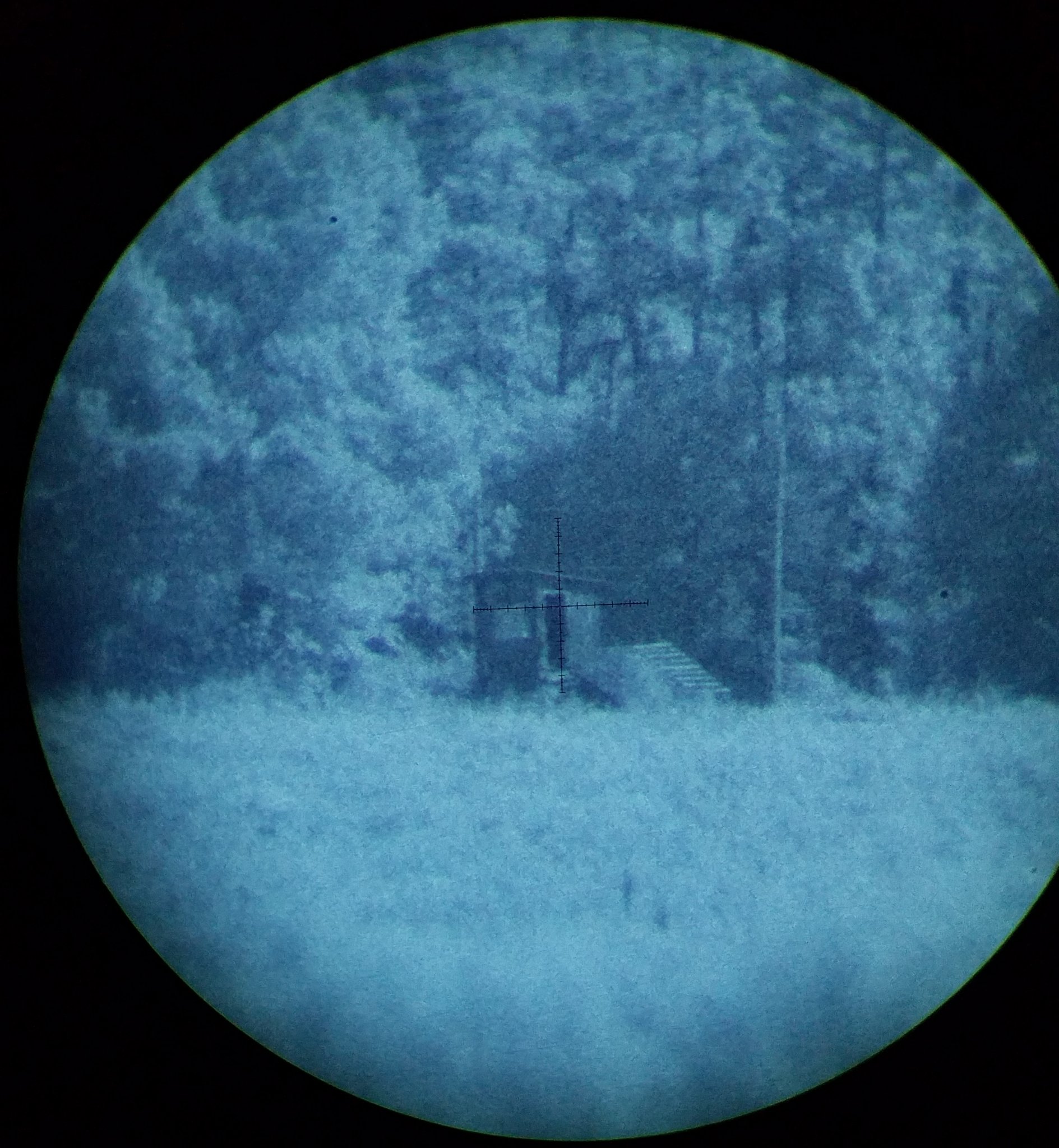

Mineral feeder 415yds with ELIR-3
It isn't an aiming laser ... but almost ! :)

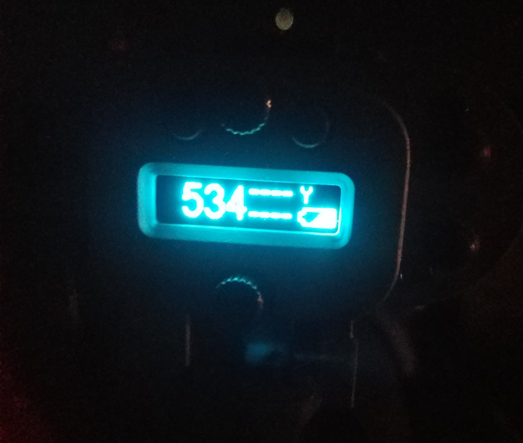

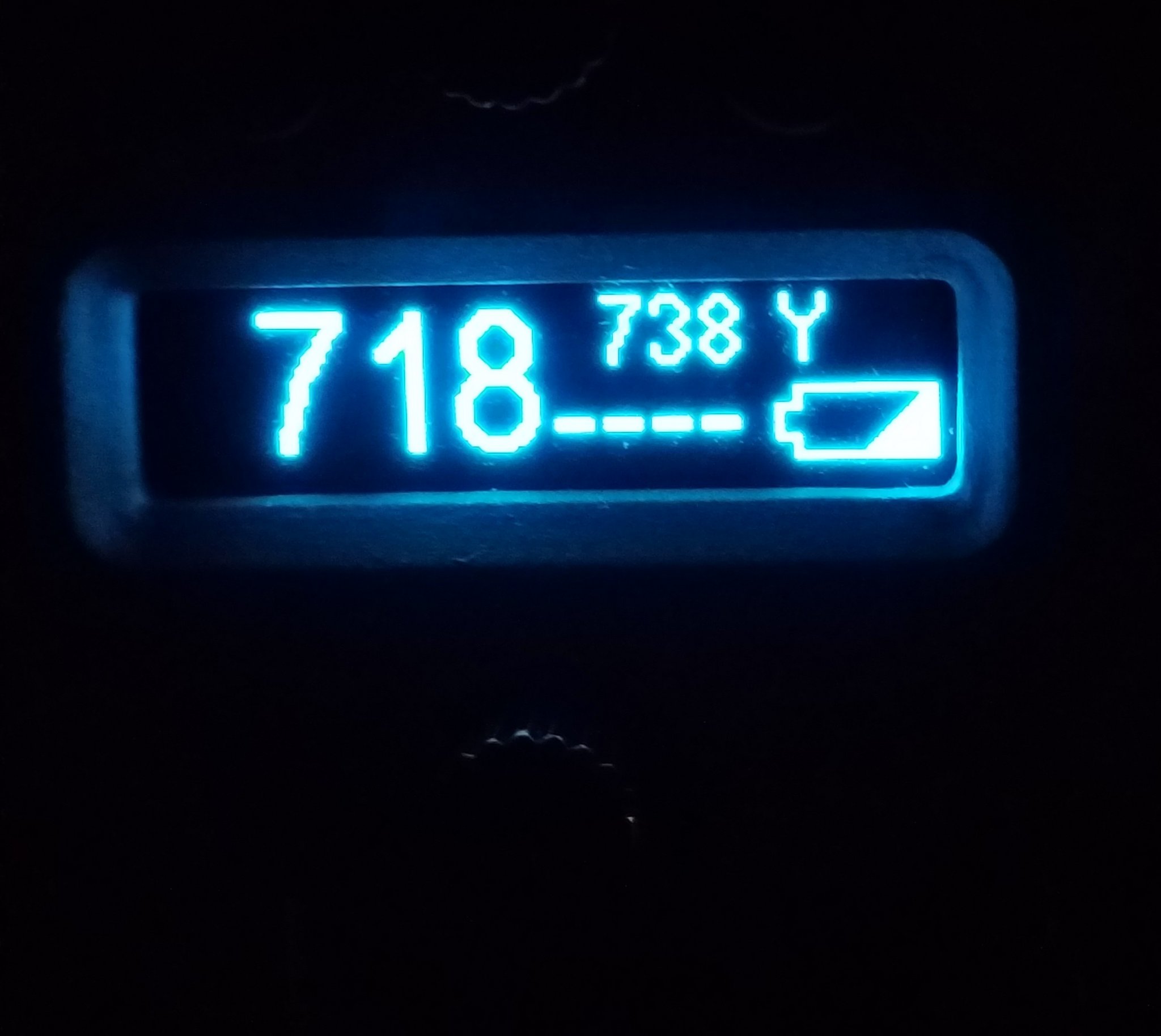

Small feed shed with same setup on same night. 2 different X

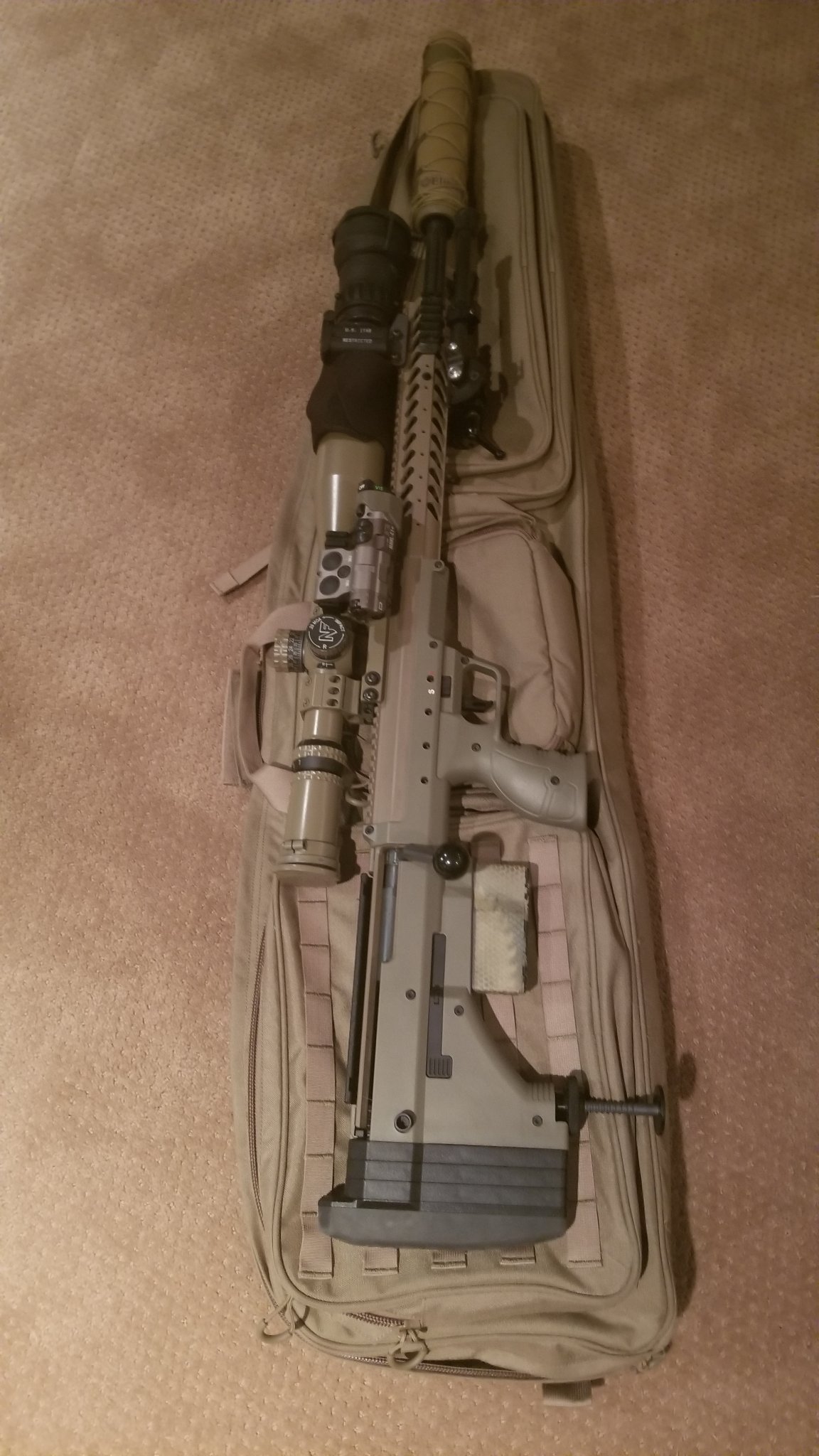

The MAWL has proven to be very effective and flexible under different circumstances.

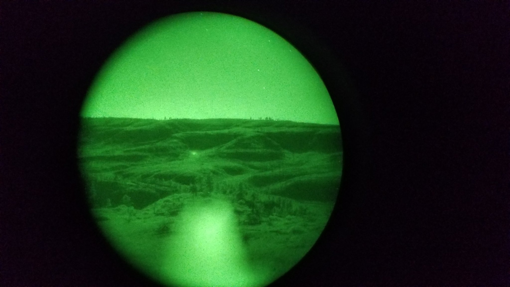

View attachment 6990898View attachment 6990899View attachment 6990900
You make me sick. You got the new WP model, not the refurbs most of us scored this year. That's damn nice, great pictures too, all the ones I tried sucked. There are ARDs for 'em on Ebay if you don't have/want one as well as new rubber covers. They're both FDE, which I'm sure matches yours just fine but my ARD required a bit of flat black to look right.

MAWL is certainly a more high quality illuminator than the ELIR, but the lack of focusable beam on the MAWL means it either works...or it doesn't. I found that even in long-range/high power IR mode it was lighting up trees between the target and me causing some backlighting. Still, it's pretty nice.

Haven't had the chance to try the MAWL past 500 yet, where I had the problem with its wider beam backlighting trees between me and the target. The MAWL is probably king-$hit on an AR though. .
BE Meyers is testing a variant of the MAWL that has at least 2 of the 6 modes dedicated to LR/Precision work. Narrower beam diameter selection on those 2 modes being the primary tweak. I have seen it be able to push into corners and tight spots without illuminating adjacent/closer objects that would washout the targeted object.
