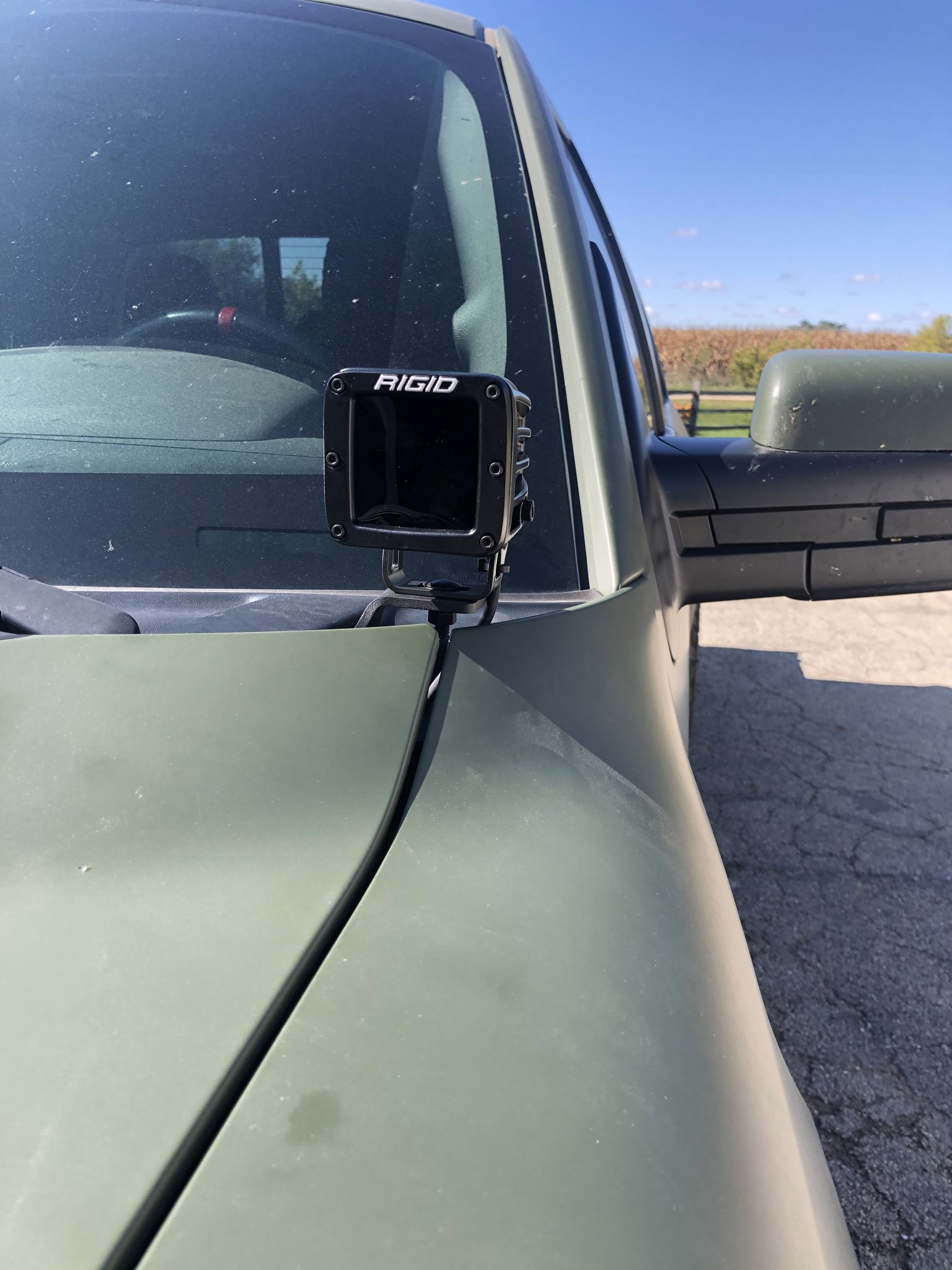

I’m running 4 Rigid IR lights on the front of my truck. 2 4” rectangle ones from Night Goggles in the lower bumper pocket on each side of the license plate. Also 2 cubes with an A-pillar mount. I can safely navigate highway speeds with my dual pvs14s.

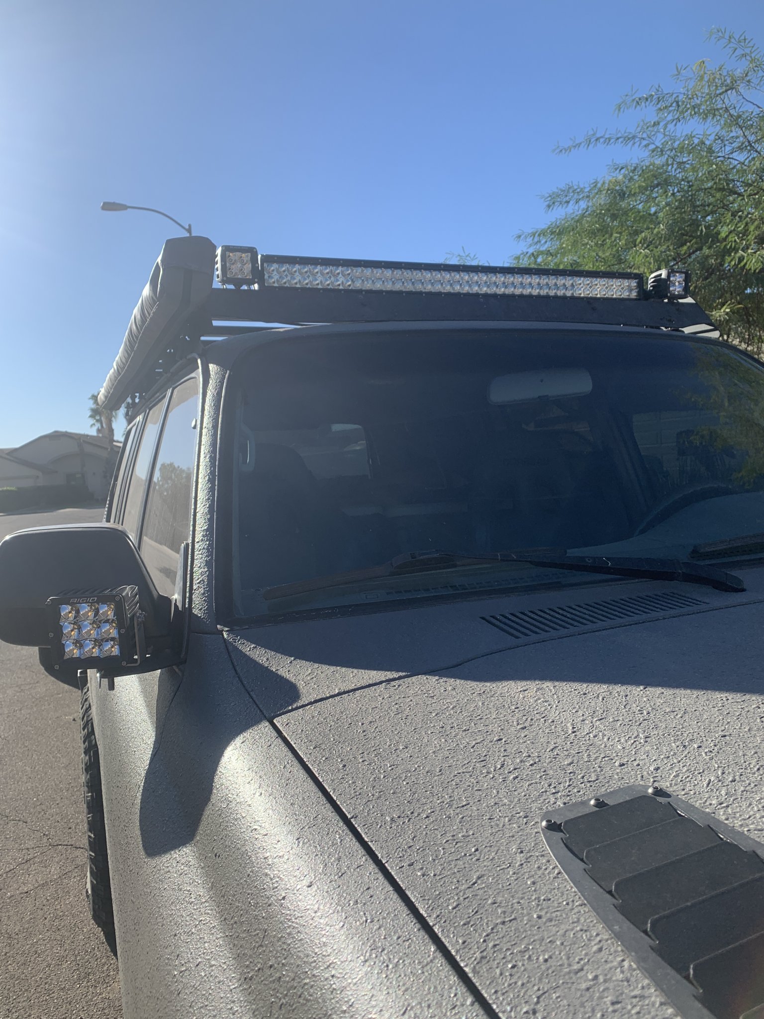

Since pictures rule. Both my upper pods and 40” light bar need to aim up another 5*

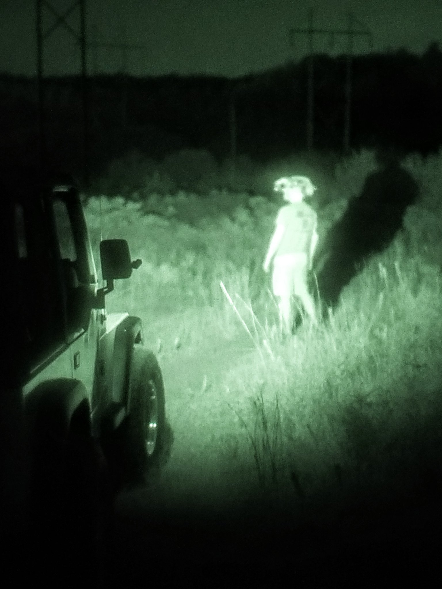

I recently spent some time driving around with my ANVIS and an Armasight focusable illuminator magnet-attached to the roof of my car. Not something I'd want to use for an extended amount of time, especially with a ton of cornering at speed - but it worked damn well for driving around a few thousand acres of private land in the dark to look for pigs to kill.
