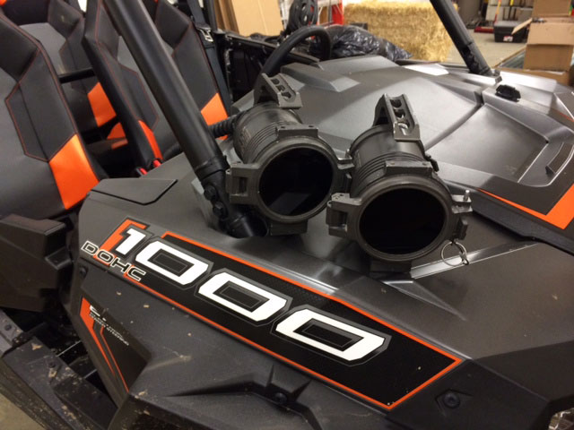

Working on mounting these on my new rzr. Think two Hellfighters will put out enough light to drive by? ;)
Took a test run and as I expected driving with pvs14 is no picknik! I need to get a dual mount or other binocular nv setup.
Used that light many times overseas on a minigun. We used to call it "the eye of allah" because it never failed to stop them in their tracks when we turned it on the jingle truck drivers. Driving with NODs takes a bit of getting used to, especially a 14. Dual tube/15's really is the way to go but you still have to get used to the lack of depth perception.
How do you plan on powering them both? As far as I can tell the RZR's battery may only handle one and you had better be moving!
That big light will drain that small ATV battery. I have the Hellfighter as well with IR lens and the same RZR model as you picture.

Please share what you come up with. Do you know the power consumption for a hellfighter? I probably won't have time to build mounts and figure out wiring and power details until late Jan.
In the process of coming up with a good mounting system for it.
Contact UTVinc, they can fab up a mount if one of their existing ones doesn't work for you.You need dash bar/pillar light mounts. I'll tell you what I told throttleJ. Autotrends wire harness(Autotrend EFI - UTV Fuse/Relay Block) a PAC-200 battery isolator and a second battery wired up as shown.
