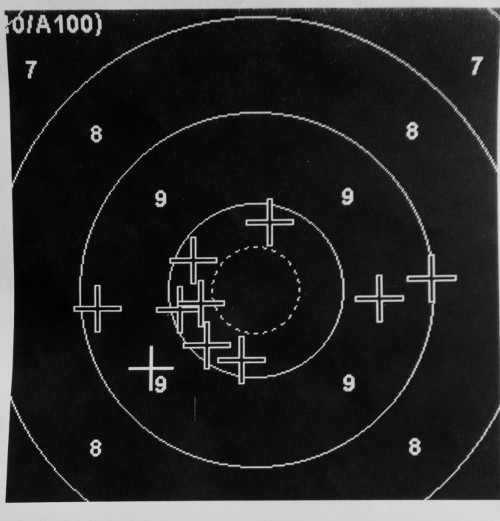

So it goes without saying that we all shoot better scoped vs not. That said, I’m curious what the consensus is for accuracy with iron sights?
I took one of my Lee Enfield No.4’s out yesterday with a Fulton of Bisley ‘no drill’ mount and got 1 MOA average over four 5 shot groups at 100 yards. I then took the mount off and shot it again with irons and got 3.5 MOA average at 100 yards. It isn’t unexpected that my groups would open up with irons (especially with my eyes aging), but with most of my rifles not being set up for scopes I’m curious what people consider good accuracy with iron sights?

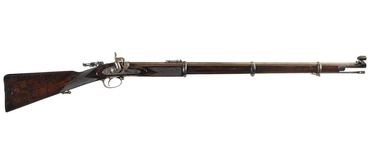

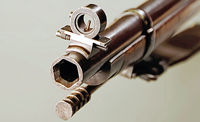

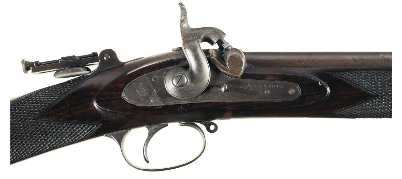

There's iron sights and then there are iron sights....
Confederate snipers were using these Whitworth's out to 1500 yards during the Civil War. And they were certainly capable of hitting "Minute of General" on more than a few occasions.
And don't confuse accurate with repeatable. The important thing is repeatable... whether in machining things or hitting targets at long ranges!
There are definitely iron sights that are just fine shooting out to some incredible ranges. But you have to master them! And it's a lot harder to master an iron sight (especially a diopter and/or peep and/or tang and/or ladder... I can go on!). These guys were masters.
Today we don't teach people to master iron sights before moving on to fancy sooper snipery scopes. But there are a few out there who have. I'm not one of them... but @buffalowinter has it down pretty good, or so I believe!

Took me some time to find them... but here are the results of the British Ordnance Board tests of the Whitworth vs. the standard Enfield rifle... These were done c. 1857 on the eve of the American Civil War when Joseph Whitworth was trying to get them to adopt his rifle as superior to the .577 Three-band Enfield rifle.
The comparative tests of 1857-58 proved that the small bore military rifle is clearly superior compared to the standard issue Enfield rifle muskets. More than 1000 rounds were fired from each rifle, IIRC.
Distance (yards)Average group size (feet) Average group size (feet)
.577 Enfield Rifle .451 Whitworth Hex bore
3000,790,33
5001,60,68
8004,171,46
1000No hits2,18
1200No hits3,91
Note that at 300 yards, the Whitworth with iron sights... in the hands of expert shooters, was shooting 4" groups. That's roughly 1.3 MOA... with iron sights. At 300 yards.
At 1200 yards, still c. <4 moa if my math is right. With a muzzle-loader. And iron sights. And cast lead bullets. And black powder.
Masters indeed!

The Whitworth...well, maybe notsomuch.
3rd for the Service Aggregate in 2017, 7th in 2018.
...and I think I’m bout done with that crap.

This was proven time and again with Stgw 90, Stgw 57 and K31 at 300 m (the most popular shooting discipline in Switzerland) -- for a good shooter, adding optics does not make any noticeable difference in the results.
E.g.
Military-issue Stgw90, original diopter iron sights, prone / standard bipod, 300m, ISSF 10 zone = 10 cm diameter.
(done that recently in a match, can't do much better with optics)
However...
...one beer too many the night before, tired shooter, less experienced shooter, degrading eyesight, difficult conditions (e.g. constantly changing light), or simply less elaborate iron sights (stgw 57 and 90 diopters are quite exceptional -- built for precision shooting) -- and that's where I see that optics leave a much more comfortable margin for aiming errors.
In my case (stgw 90, 300m) it is, on average, 91-93/100 irons, and 93-95/100 with good optics.
