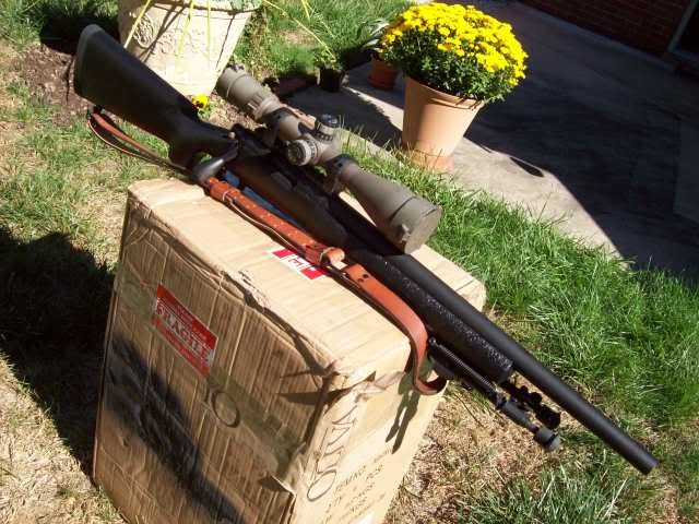

20" MTU Contour Barrel.
it's heavy, but nothing unbearable.
