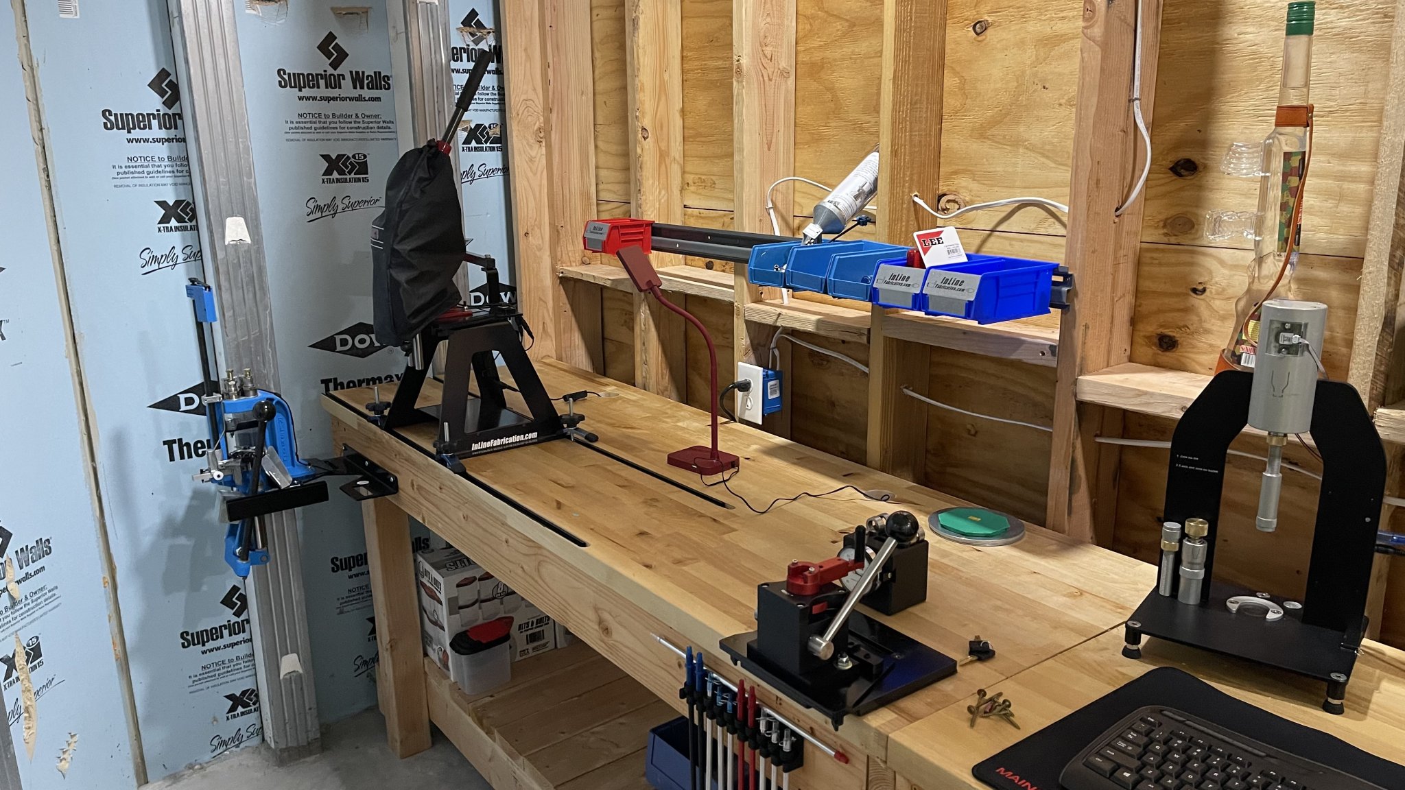

Yes I do on my bench.
Reactions: Balor and Dogtown

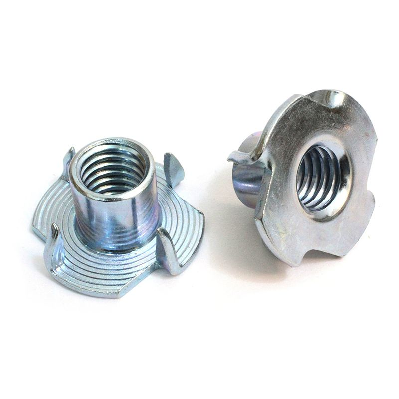

I considered using T-tracking on my loading bench but decided I didn't want put up with the 2 tracks in my way forever. I decided to use T-nuts instead which mount to the underside of the bench top. I laid out where I wanted to mount my press and other pieces of equipment, drew an outline of the equipment base with a sharpie, drilled the necessary holes, installed the T-nuts and I'm done. Obviously I needed the appropriate number of 1/4x20 bolts to secure the equipment to the bench. Cost of the T-nuts and 1/4"x 20 bolts is one helluva lot cheaper than T-track.
Reactions: Baron23
On my previous bench I stripped a couple of the t-nuts shown above. This had to do with the construction on the underside of the bench.

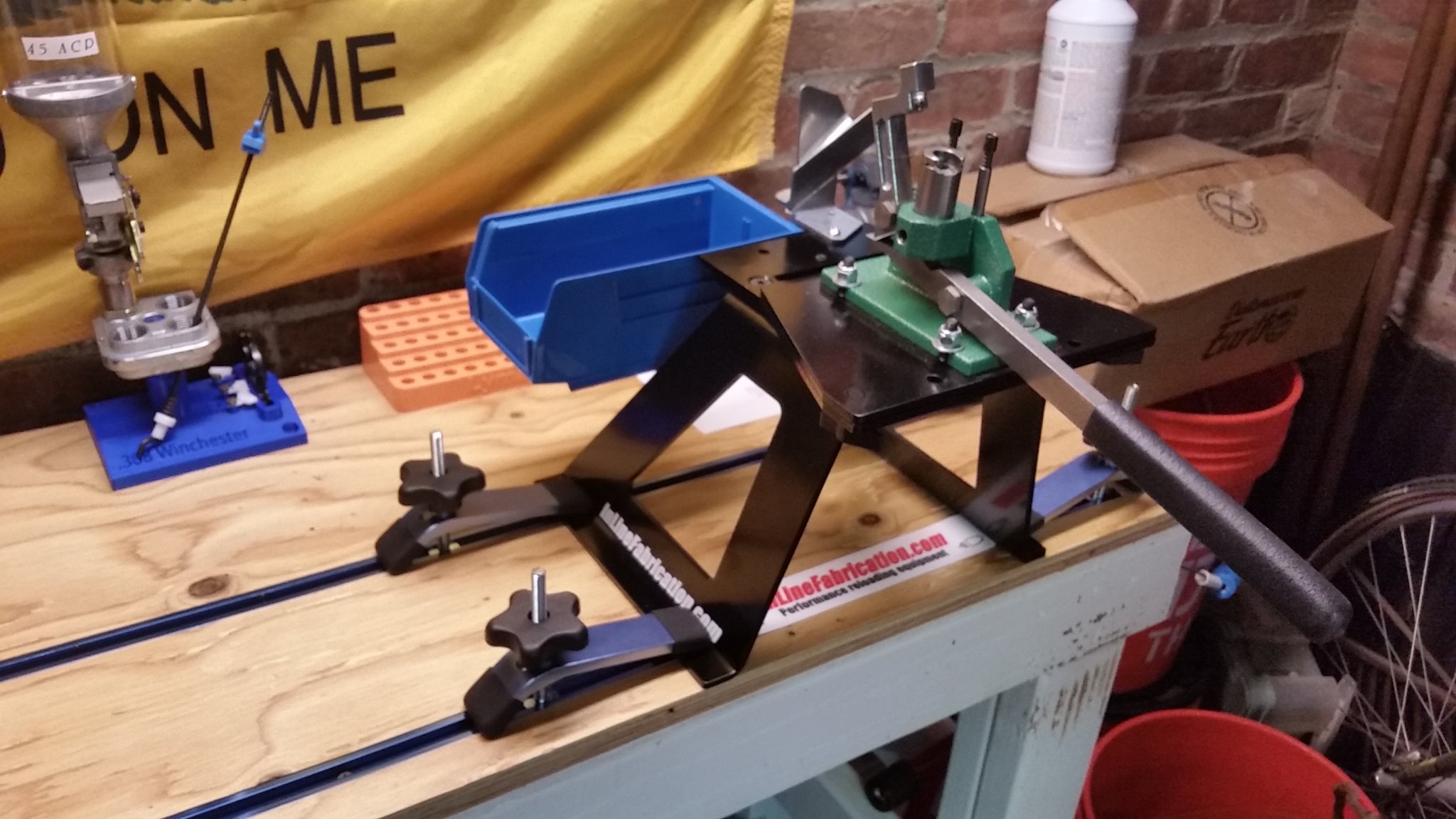

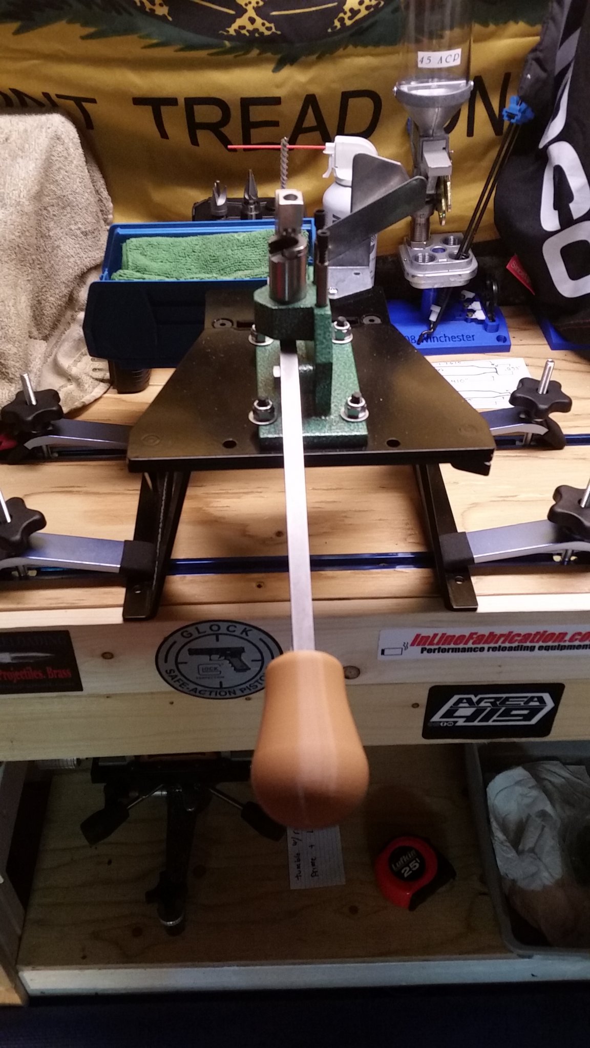

I use Amazon cheap-o T tracks to move around a Inline Fab mount. Have not run a press on it but I see no reason why it wouldn't hold.

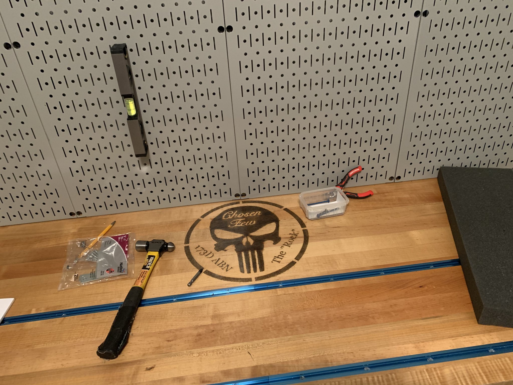

I set up my reloading bench with the ”heavy duty” aluminum t track that takes 3/8” hex bolts. It’s a handy feature, but has some issues.
1. the aluminum is soft and easily damaged
2. If using multiple sections in a row, it’s best for alignment to inset the front track from the dge of the bench enough that the wood will support both sides of the track. I put my front course on the edge of the bench top, and when i put the screws in, the two sections of track became slightly misaligned. this creates a hang up on the bolts as they slide between the two sections.
If steel track was commercially available I’d switch in an instant. Gavin at UR machined his own from square tubing, which I can’t do.
