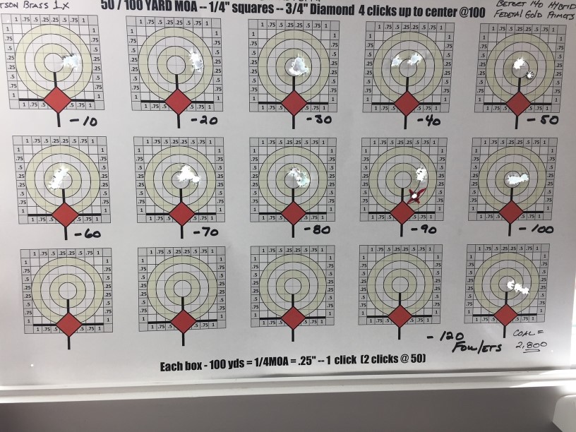

You said it yourself.
The goal is group size to show what the rifle is capable of.
"depending on the target, i will sometimes dial off center a few clicks, so that i am not shooting my aiming reference.....if you keep plugging holes into what you are aiming at, your reference goes away, and your groups open up."
This guy ^, I do the same thing, especially at distance and dependent on the target once you shoot out your "bullseye" there's nothing to aim at.
As already mentioned - so you don't shoot out your aim point. That's why I created these targets, 2 or 3 clicks up and aim at the red diamond. I don't adjust for wind during load development.
