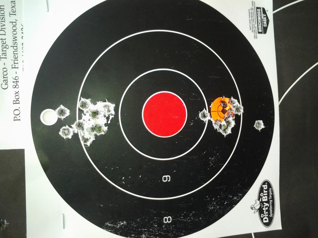

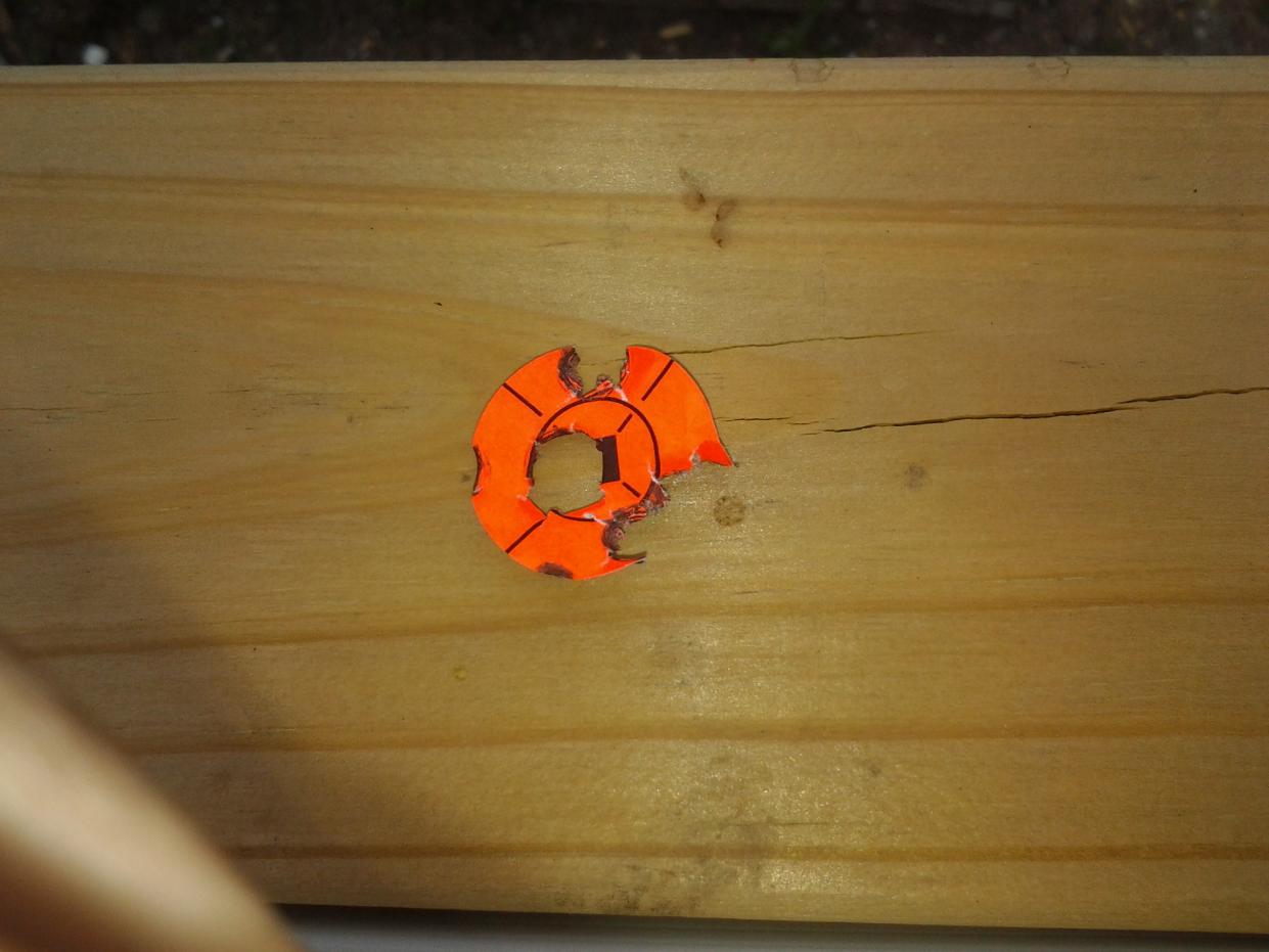

Today I shot my first loads that were built based on a combination of what the manuals say, what my rifle has liked so far (the 11th round in this batch of 25 was my 100th round loaded to date!), and what I thought would probably be OK.
Left dot was shot off with 10 rounds of 37.5gr VV-N140 contained in CBC brass and propelling a 200 grain SMK seated at 2.82" COAL @ 100 yards.
Right dot was shot with 10 rounds of 37.0gr VV-N140 contained in CBC brass and propelling a 200 grain SMK seated at 2.82" COAL @ 100 yards.
The first five shots were steps of .2gr from 36.7gr to 37.5gr. When I tried 39gr in the CBC brass with 180gr SGK seated at 2.80" COAL, the group sucked and the bolt stuck on one of the rounds, so I got skeered. Oddly enough, that 5 shot group was better than the other two @ 5 shots, but my buddy shot up that target trying to sight in his AR, so I didn't take a picture.
Conditions were windy, and my shooting platform was a little awkward, but I'm very pleased with the results.
