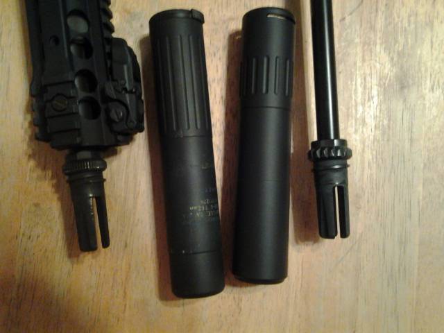

While able to "cram" them on, aac adapters are different.
Take a look at the "teeth" on the two different adapters side by side.
They are not the same.

I think you are a little confused here. That is a 51T mount on the left, and 18T mount on the right. The 51T mount replaced the 18T mount about 10 years ago. They are completely different designs. The 18T used a retainer spring (later versions used dual retainer springs). Th 51T used the latch mechanism. So yeah, of course complete different mounts designed for different silencers won't work.
A M4-2000 (556) 51T mount will also accept SDN6 (762) silencer. Likewise, the SDN6 (762) 51T mount will accept the M4-2000 silencer.
Not confused at all.
Thats a m4-1000 sitting there and the 18t goes with it.
Old like me and lots of miles on both, still banging it.
Have not needed to replace it.
Can't say about the m4-2000
Maybe I'd retract that if you showed us a picture of your 223 and 30 cal aac's side by side with thier adapters on your rifles.
My older cans from aac dont swap / lockup , 2 different adapters.
Was speaking from hands on experience, out of date, kind of like me.
After calling cs at aac they cofirmed that the m4-2000 "223" newer 51t adapter ,
Will in fact go onto the 51t 30 cal adapter . They broke what was fixed?
Could have made the 30 cal flash hide tangs 1/4 inch longer and prevented this.
Sort of a moot point I would not buy a 233 adapter style can again and just use 30's,
I apologize for my mistake.
Still want to see those cans
