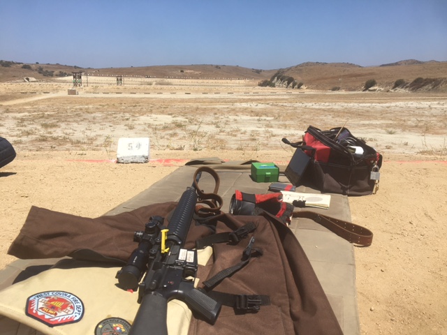

Come to a Highpower or otherwise called Service Rifle Across the Course Match, or a Mid Range prone match. We shoot 200/300/600 yard lines all day from Sling positions other than offhand which is unsupported.
