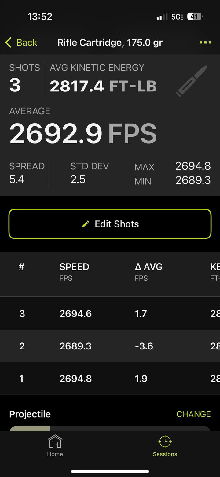

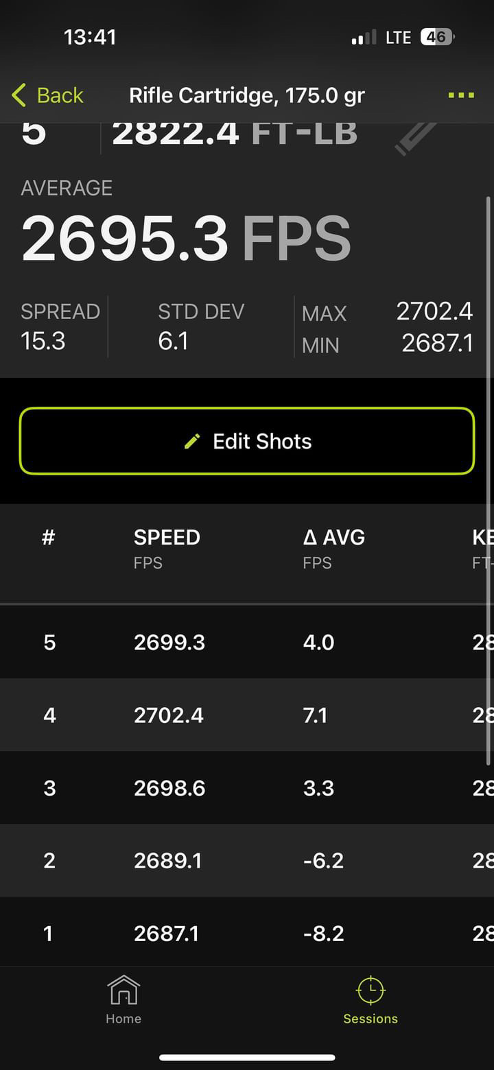

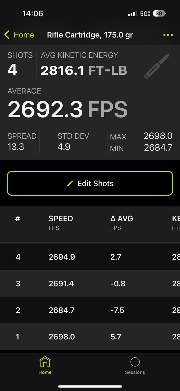

I wrote a whole write up and AAR on it for the Air Force Rifle Team, but M118LR is super inconsistent in seating depths, at least the military M118LR is. You gotta uniform the seating depths which will also crack the tar seal on them.
I’ve cracked the seals on them in the past to make them somewhat decent by seating them .010” deeper. However, with this last lot/can I was measuring BTO on every round and noticed there were 2 different lots of 175s used.
BTO
Lot 1 would measure: 2.123”-2.108”
Lot 2 would measure: 2.102”-2.096”
so that was an ES of .027”
Once separated and seated separately their BTO measurements were within .002” of each other when I was measuring every 20 or so rounds. I chose a seating BTO, in my case of 2.086”, so I was at least seating the shortest rounds by .010” to break the tar seal on it.
This is on my 308 trainer with a 26” barrel. Previously I was getting ES’s of almost 60 FPS. So going forward I’m measuring every rounds and matching sure seating depths are uniformed
Reactions: ThicketCricket
