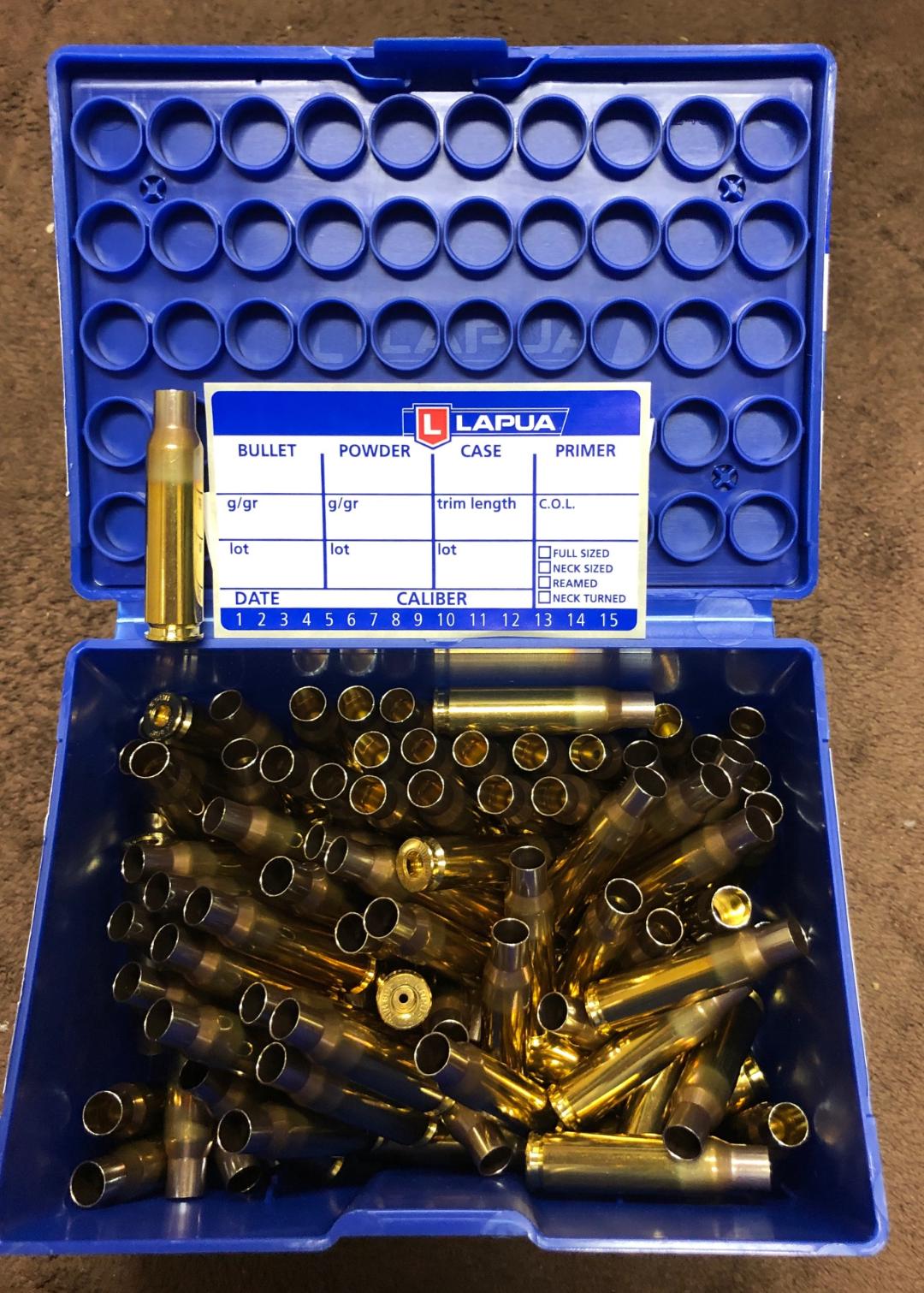

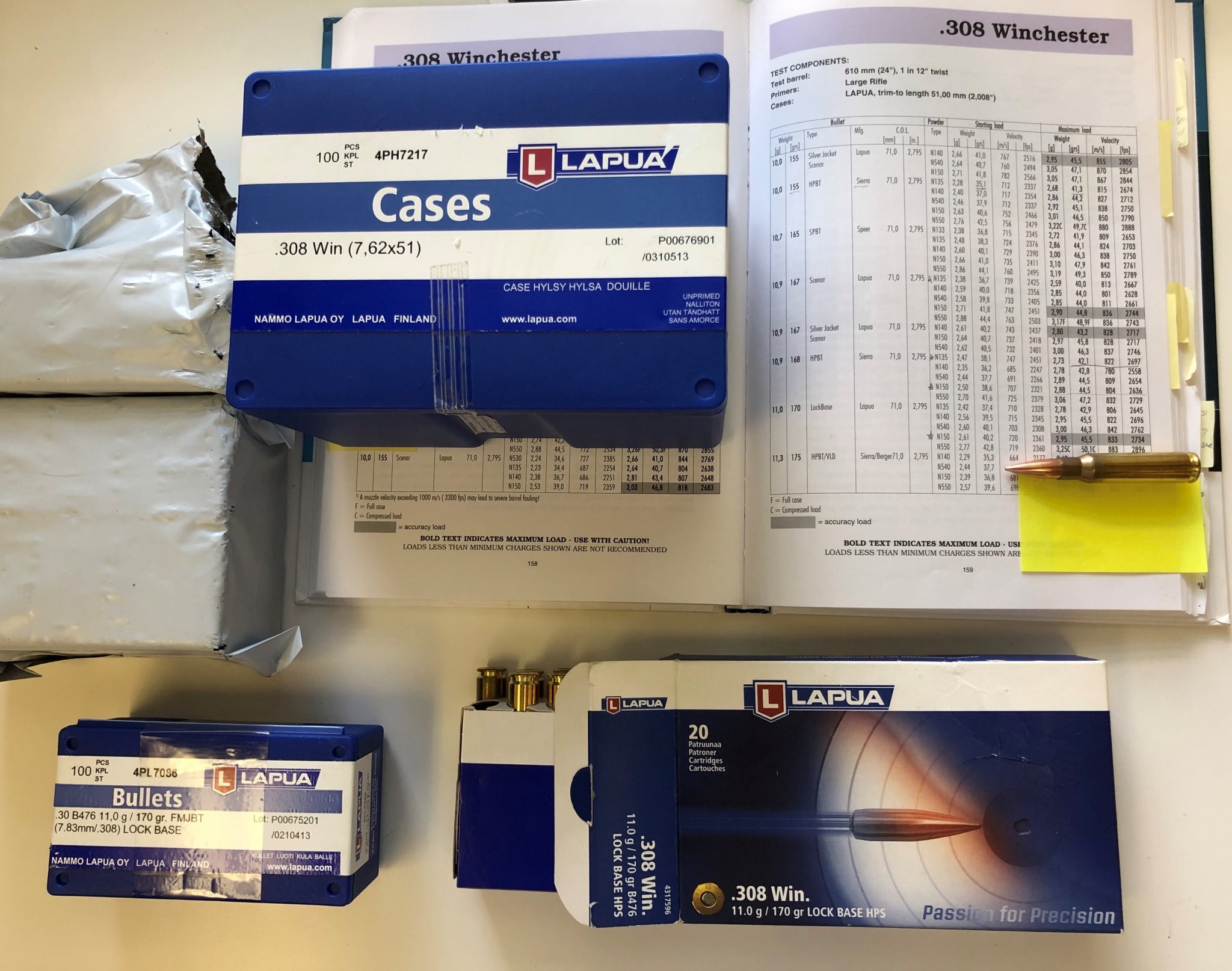

Months ago I bought 400 Lapua 170 grain Lock Base bullets, and for Father's Day I bought a batch of new Lapua 308W brass (large primer). I think the 170 Lock Base bullet has a G1 BC of 0.525, so its supposedly a good long-range bullet. In additon, last week I purchased on gunbroker a single box of the discontinued 'Lapua 170 Lock Base HPS' ammo. According to these specs, it has a velocity of 2820 fps at the muzzle(!). https://www.midwayusa.com/product/1001859049
That is really hot ammo, and I have heard that the ammo that the British used with the L96A1 sniper rifle is also very hot ammo, and that it uses (or used) the same 170 Lapua bullet.

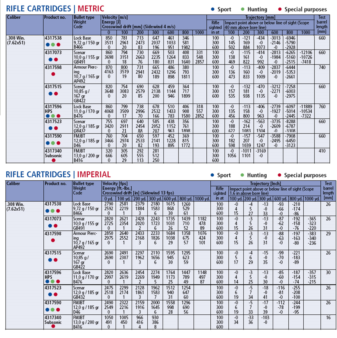

Looking at the Lapua reloading manual (4th Edition), it lists the 'accuracy load' as the max load of Viht N140: 45.5 grains at 2734 fps. The only faster ammo listed was 50.1 grains (compressed) of Viht N550, with velocity listed at 2896 fps(!). Ouch. This loading data suggests to me that the British L96A1 sniper ammo - if it is indeed loaded in Lapua brass with the 170 gr Lock Base bullet and some sort of Viht powder - might involve a heavy charge of Viht N550, somewhere in the upper 40s (ie 48,x to 49.x grains). That is my best guess.
So, here's my question: Does anyone know anything about the British L96A1 (7.62 NATO) sniper ammo, and what components might be used, if it is Lapua-based ammo? Not sure I want to handload something that hot, and I only have Viht N140 powder, and not any of the N550 powder, but I was curious about this subject. Any insights are greatly appreciated.

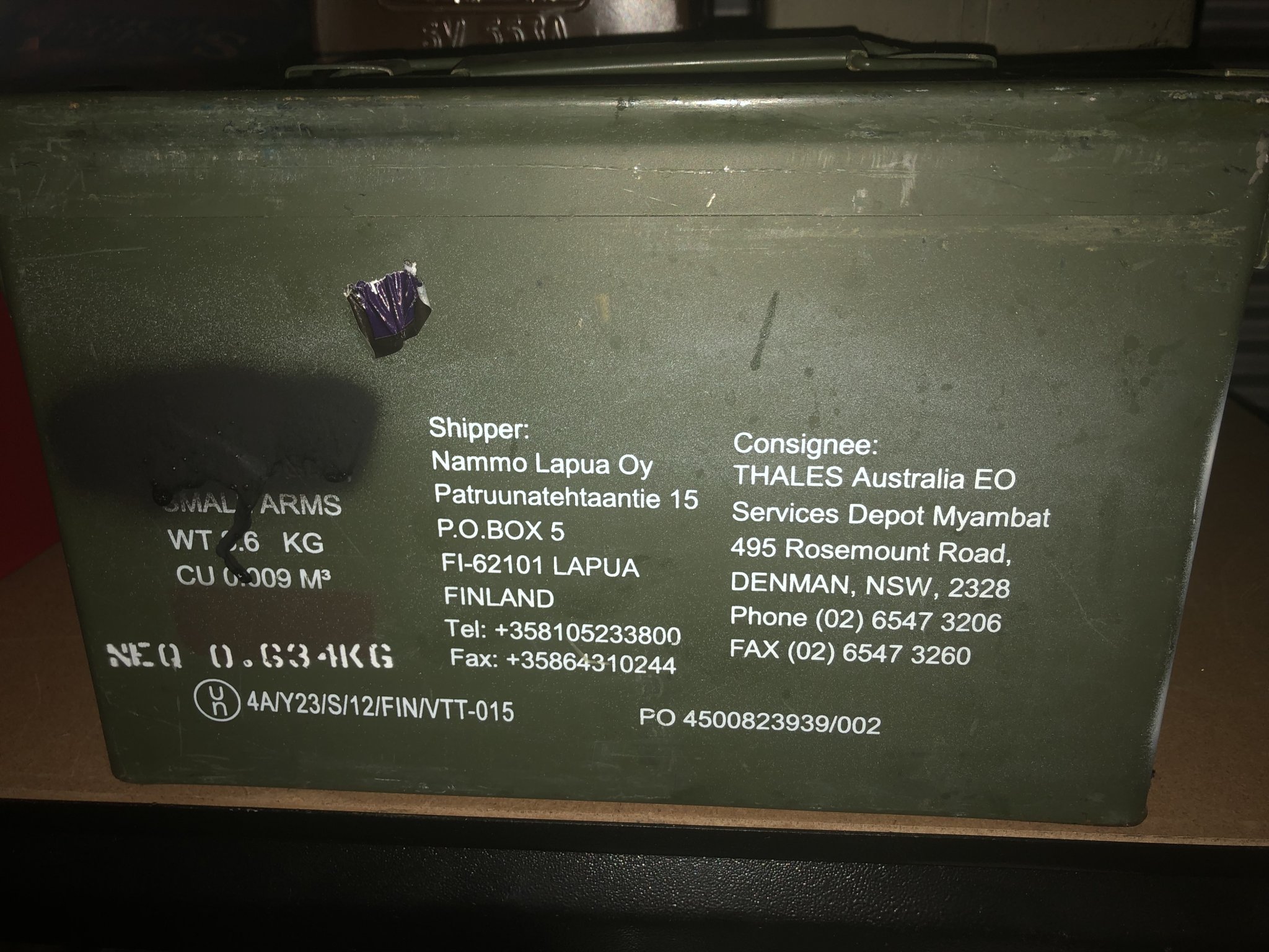

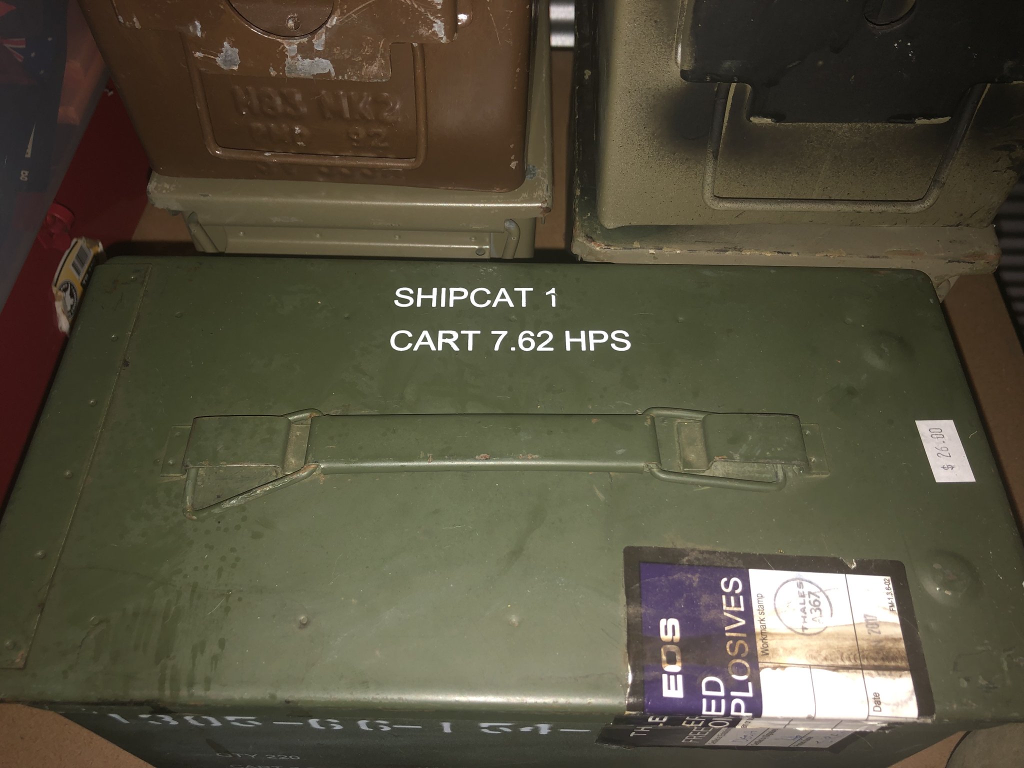

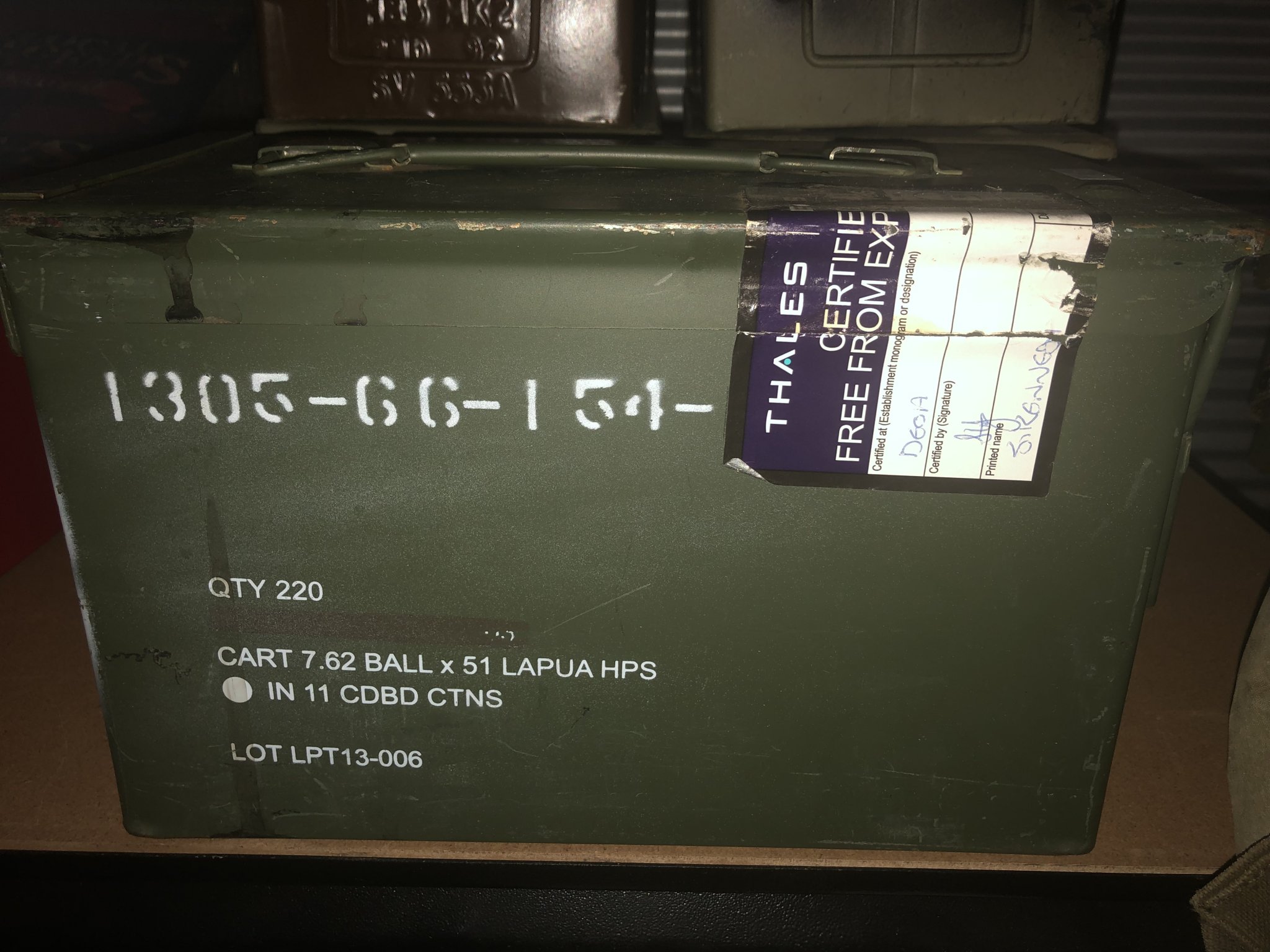

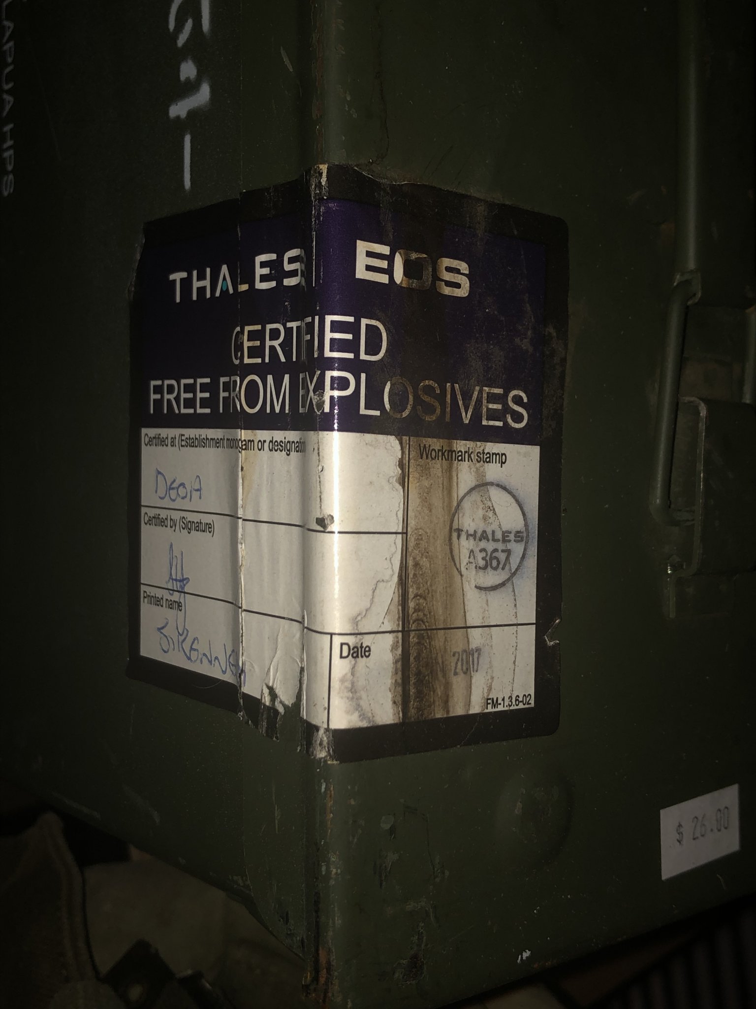

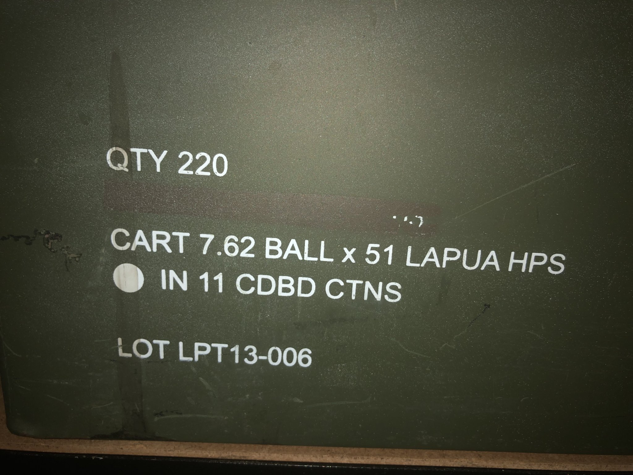

A couple years too late, but anyway, I found this van while perusing a surplus store.
It’s an M2A1 can of Lapua HPS 7.62x51 with an Australian NSN, and shipping address to Australia’s largest (known) ammo storage facility. This would obviously indicate that Australian snipers are issued this ammo, or at least have it to choose from. I also found a reference to the HPS ammo in an online PDF of an Australian Defence Force international shooting competition where it stated that all snipers, including internationals, would be issued Lapua HPS ammo for this competition. It would also point to being off-the-shelf ammo and not any special loading seeing as it’s 220 rounds in 11 cardboard cartons and they occupy a full M2A1 sized tin.
There also appears to be a redacted line of information on the can.
To speculate on your question, it’s confirmed that Australian snipers use the HPS bullet, so it would be feasible that the British use it as well.
I wonder if Australian DMR rifles use this ammo, regular F4 ball ammo or a third type….

Ok, so that ammo has 44.9 grains of powder? Looking at the VihtaVuori book, that charge weight could be N140, M540, N150 or maybe N550.
The only Viht powder that could provide 860 m/s velocity (2820 fps) would appear to N550. However, you'd need more than 44.9 grains of N550 to reach that velocity. So it's still an enigma. One of my shooting buddie's suggested 44.0 grains (w/ military brass) or 44.5 grains (w/ commercial brass) of Varget with the 170 grain Lockbase bullet.

VihtaVuori's accuracy load with the 170grain Lockbase is listed as 45.5 grains of N140, which is also their MAX charge weight, so I'll work up a load starting at 44.0 grains, and I'll try Varget at 44.0 too. Max velocity listed as 2696 fps (822 m/s), so that is a more moderate load than the military-based HPS factory ammo.
This was from the Lapua web site a number of years ago.
Please take note of the test barrel length for the 170 LB.
I'm using Varget powder 43.3 grains,
@ 2700 fps. This was tested at 35 Celsius.
With slight flattening of the primer.
I just went to the Lapua web and they have revised the data for the 170 LB, link below.
Hope this info helps in some way.
