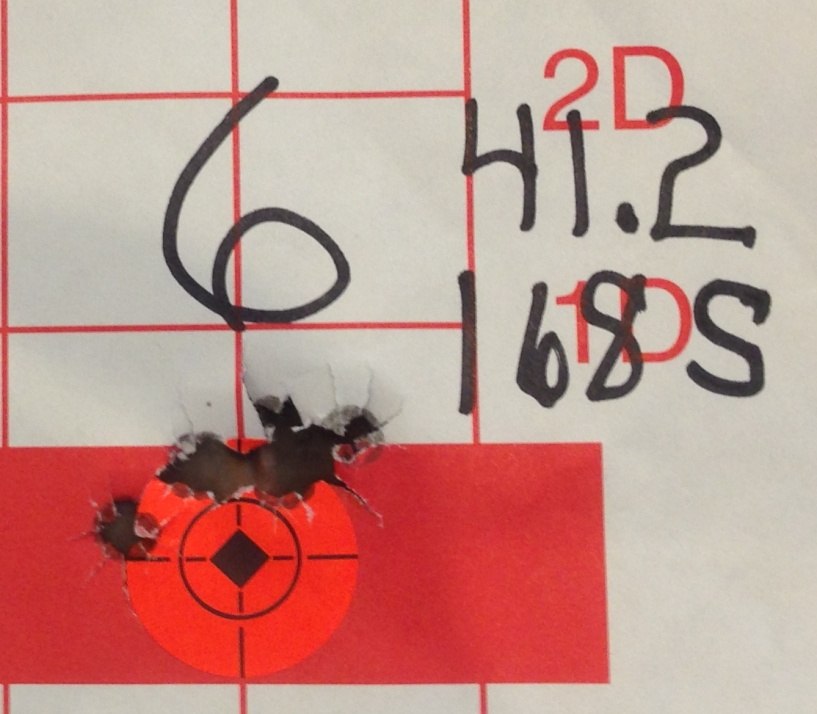

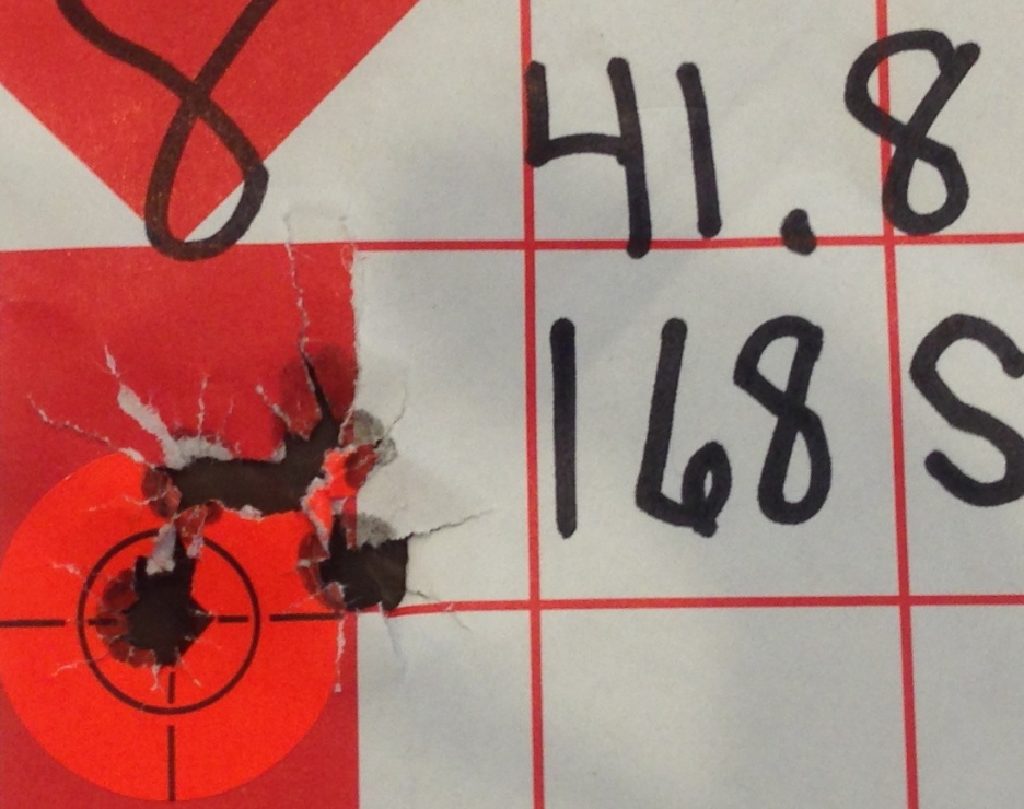

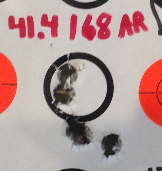

These are three of the targets from the last outing with the new stuff.
I get the vertical potential of not being in a node as the velocity is going up but I never thought about a node being anything but vertical. That's why the lateral one had me confused-but from what some here have said, I guess it's possible. I always only assumed vertical because of the orientation of barrels/actions and I can't remember the recoil of a gun pulling the barrel sideways-without some kind of comp action, anyway!

The targets show the progression working up to an acceptable load to start "fine tuning". The thing that caught my attention was the lateral spread to a vertical spread to a more or less rounded group with all rounds loaded exactly the same except for a powder range difference of .6 grains of 4064.
