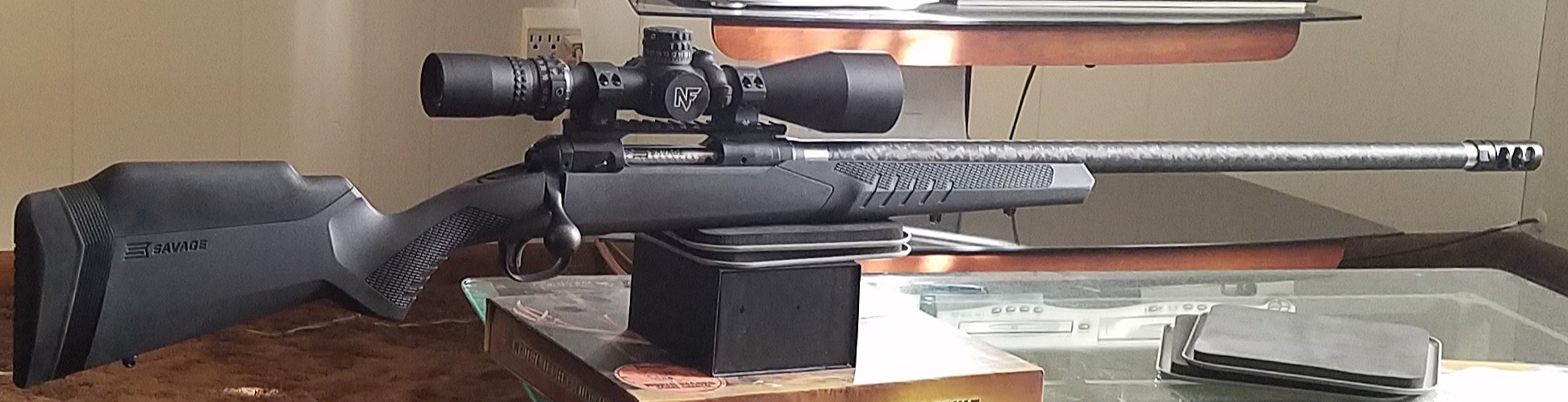

Carbonsix 300wsm, PTG magnum short action bolt face, Accufit stock, SAV2 trigger at 8oz, NX8 4-32, PVA lightweight brake.

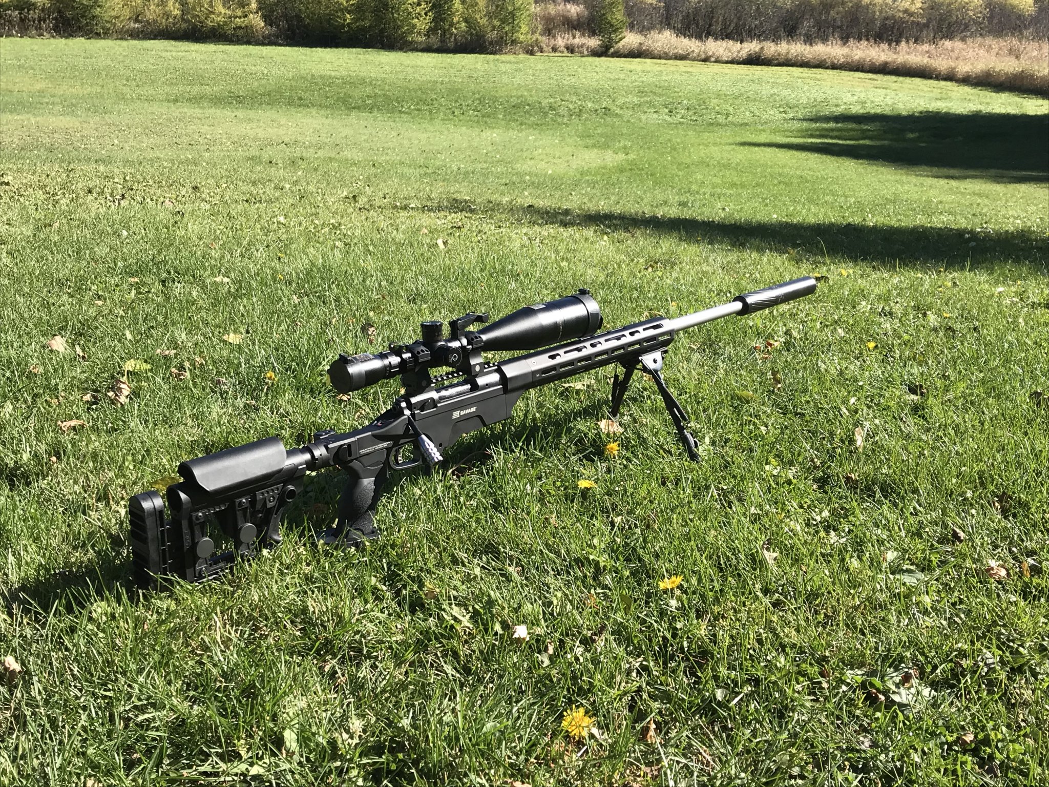

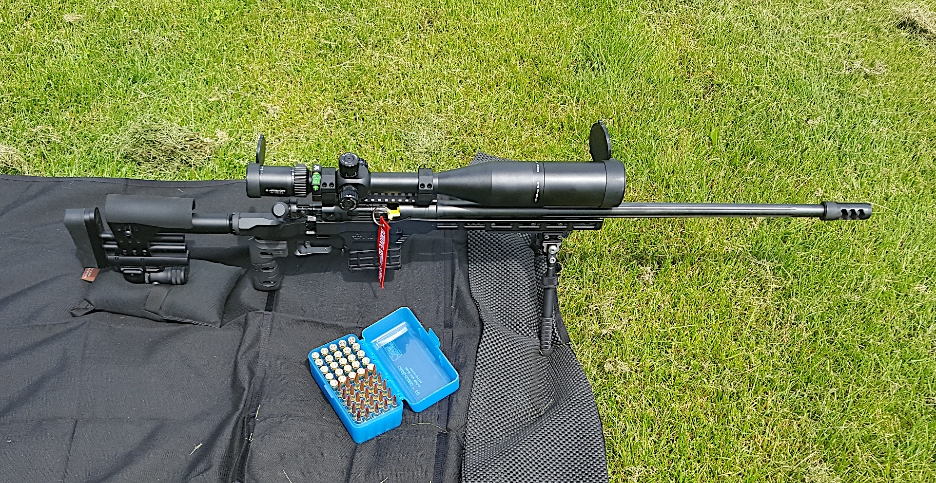

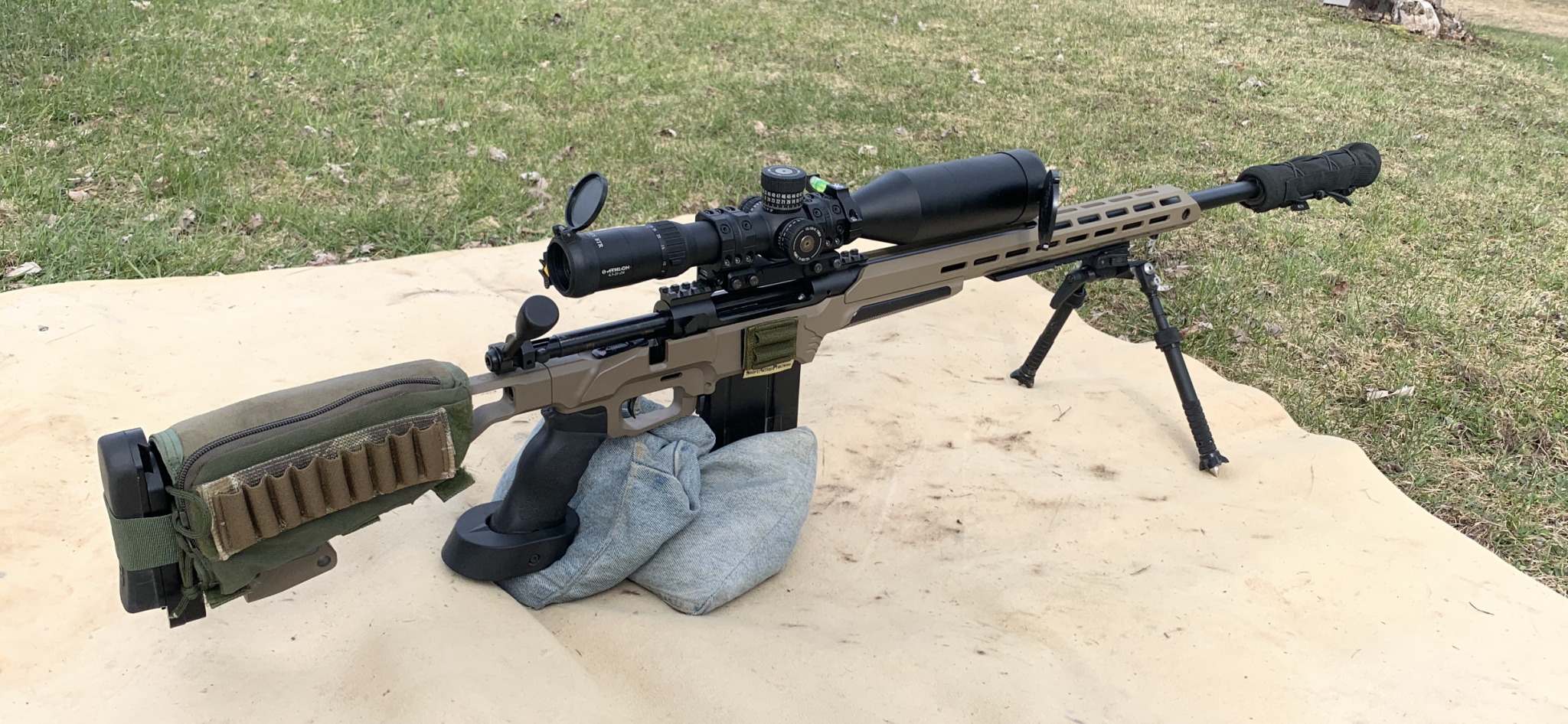

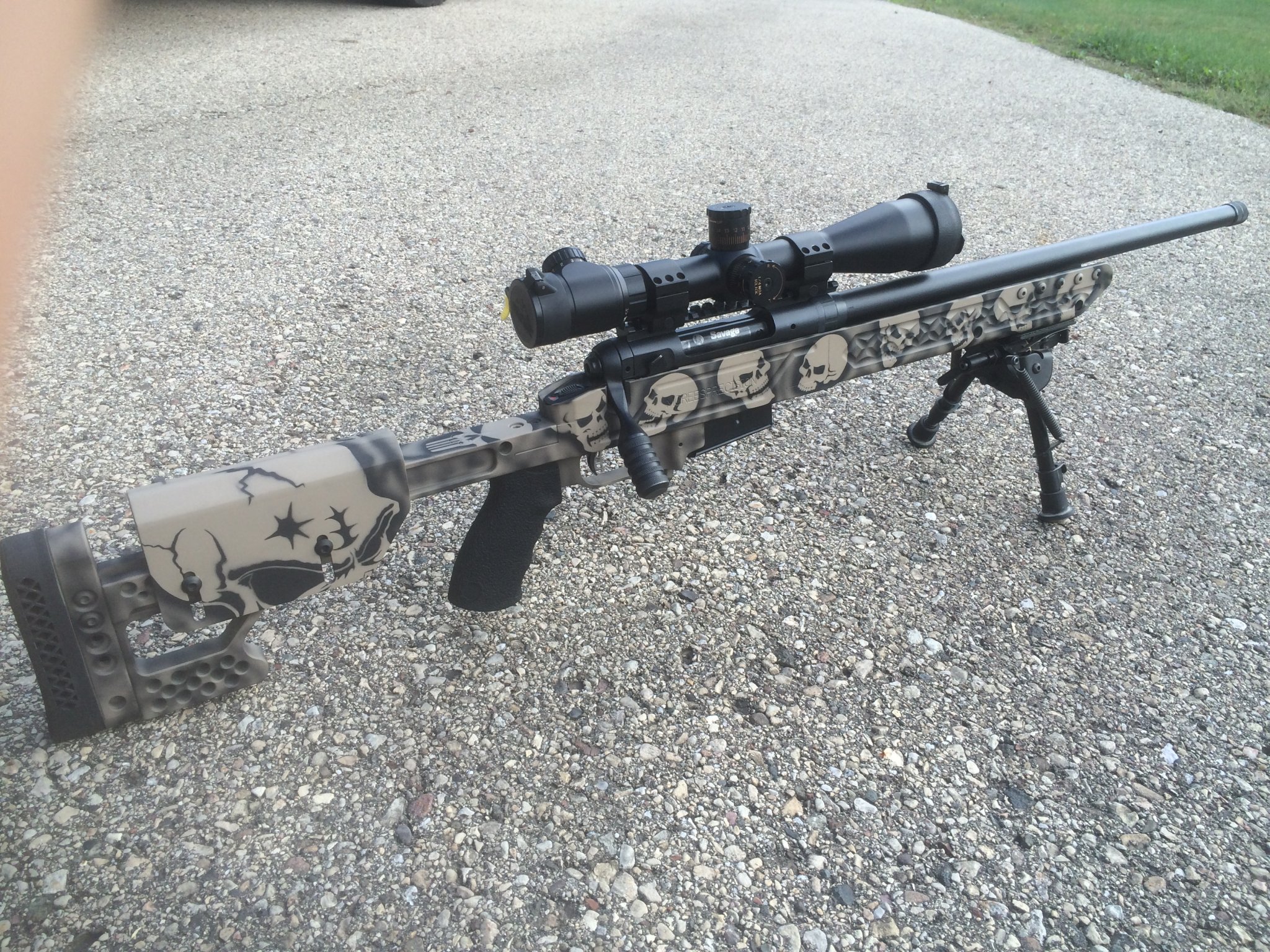

Me, I gots this Savage 10 FCP-SR in 6.5 CM 3 years ago for <$400 and went nuts building a Precision Rifle that shoots sub MOA out to 1000 yards.
When the barrel is done I'll definitely buy me a replacement and run This Dog another 2K+ rounds. I'm a Savage Whore and rocking this bitch until it lets me down. Which it has not to date.

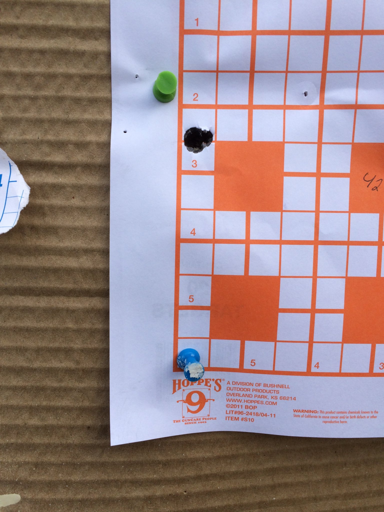

I’ve got a sentimental savage that’s one of the most accurate rifles we have. When a savage action is broken in and timed right(not sure what that means but a smith I sent it to said he tweaked it some) they can run nicely. At least mine does. It’s got a proof steel prefit on it and is boringly accurate. Add the 1-off 3d printed bolt handle and its a straight ghetto AI. We have a lot of nicer rifles but this one can run right with them. Moral of the story is while savages can definitely suck, they can also be very effective.
This is from a 12FV with just a ashbury chassis for an upgrade using 120amax factory ammo @ 200yds 10 shots. That is a Nickle under my finger for reference. IN my rifle the ammo runs 2910fps and is about 1" high of my zero with 147's @ 2765fps

@Vodoun daVinci How much did that rifle cost you to build?? Not including the scope/rings/base. A buddy wants a 300 PRC to do some long range and I suggested this route.
Round numbers I have ~$1500 invested in Savage 10 FCP-SR, MDT LSS-XLGen2 chassis, XLR Extreme buttstock, Atlas BT-10 bipod/rear monopod, MDT AICS magazine, MDT vertical grip, and assorted rails and stuff.
I have continued this build and added front picatinny rails, weights, Vortex Golden Eagle optic.....etc.
VooDoo

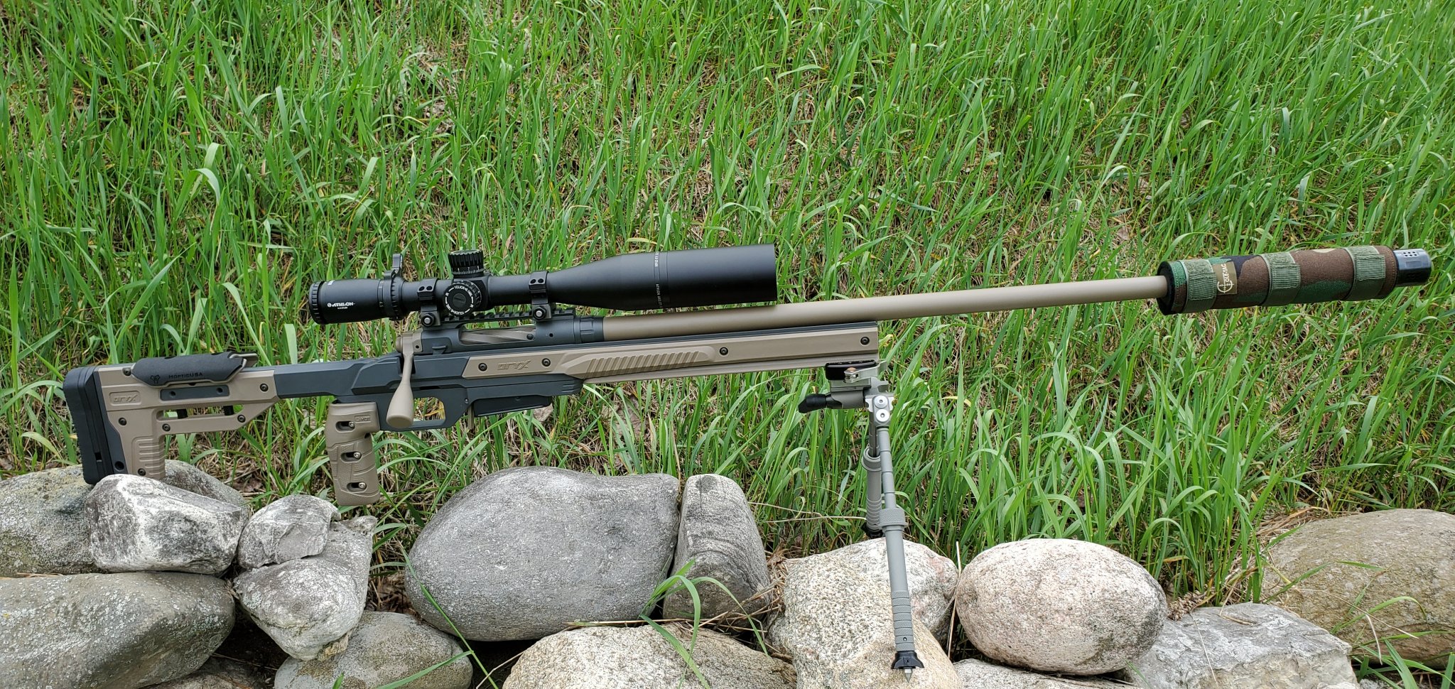

I may buy one of these stocks. What made you choose the AR stock tube over the other one that's available?
The MDT Chassis? I specifically started using chassis so I could bolt stuff on (like different buttstocks and grips) I really liked the XLR buttstock much better than the MDT skeleton buttstocks. Just ergonomics I guess.

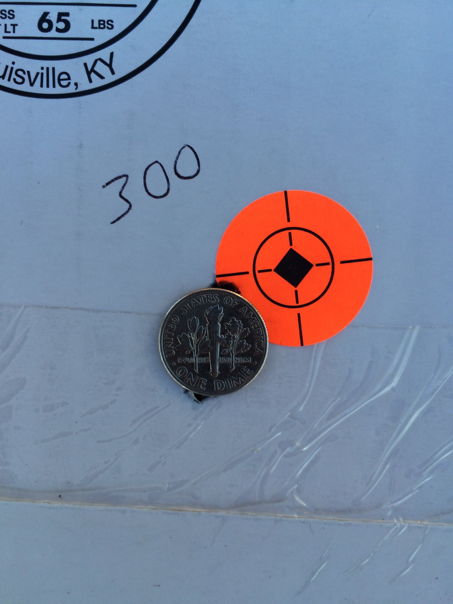

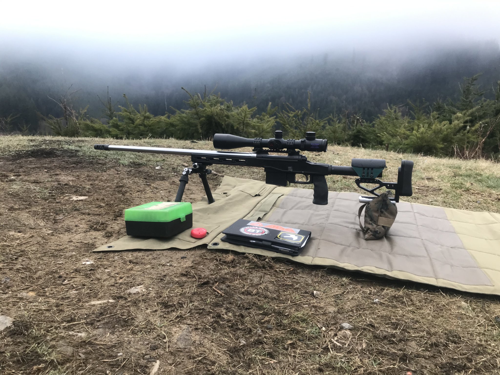

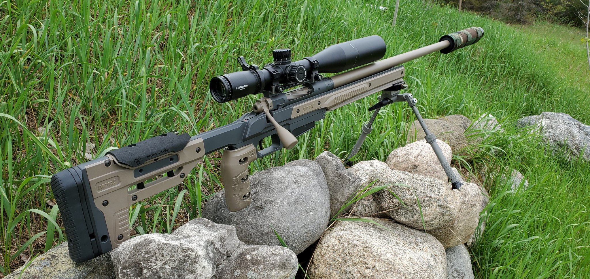

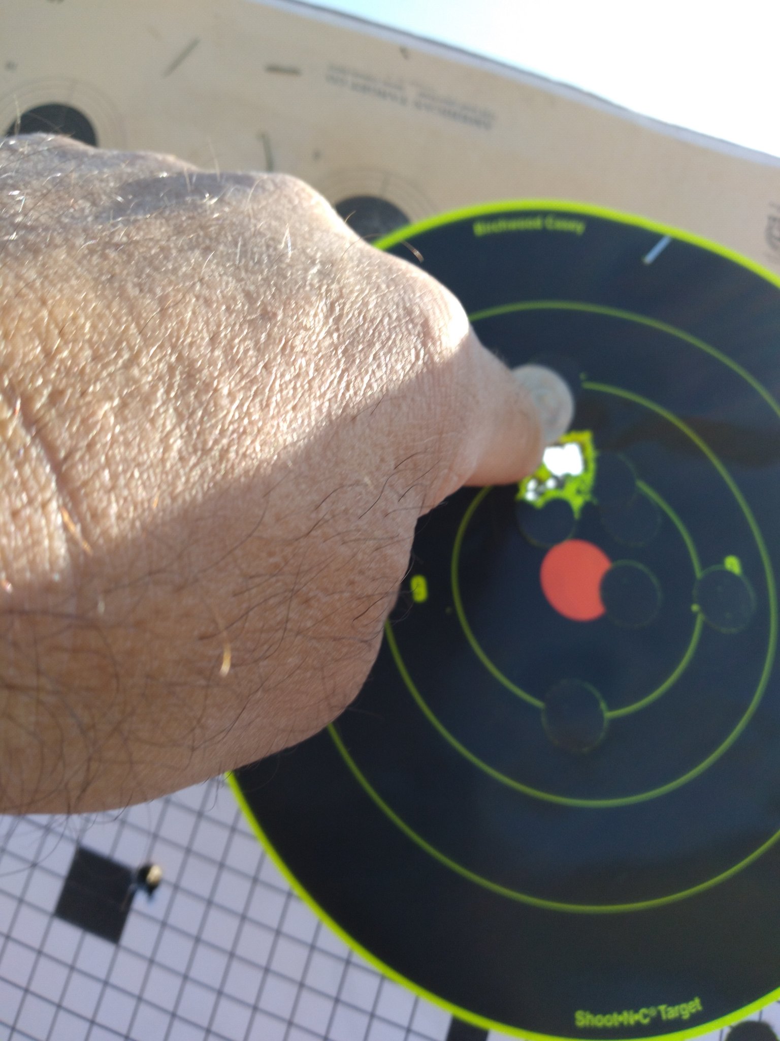

Savage Model 10 rebarreled into a 300WSM with a Shilen select match barrel in an Oryx chassis. Jard trigger, and all new bolt, then topped it off with a complete Cerakote job. Has a Leupold VX-5HD 3-15x44 now instead of the Athlon. No ragrets.
100 Yards 5 shots.
