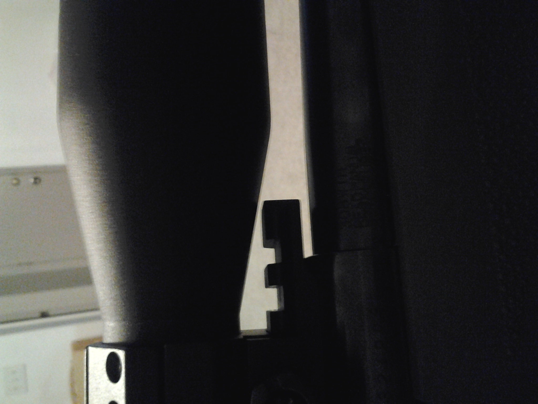

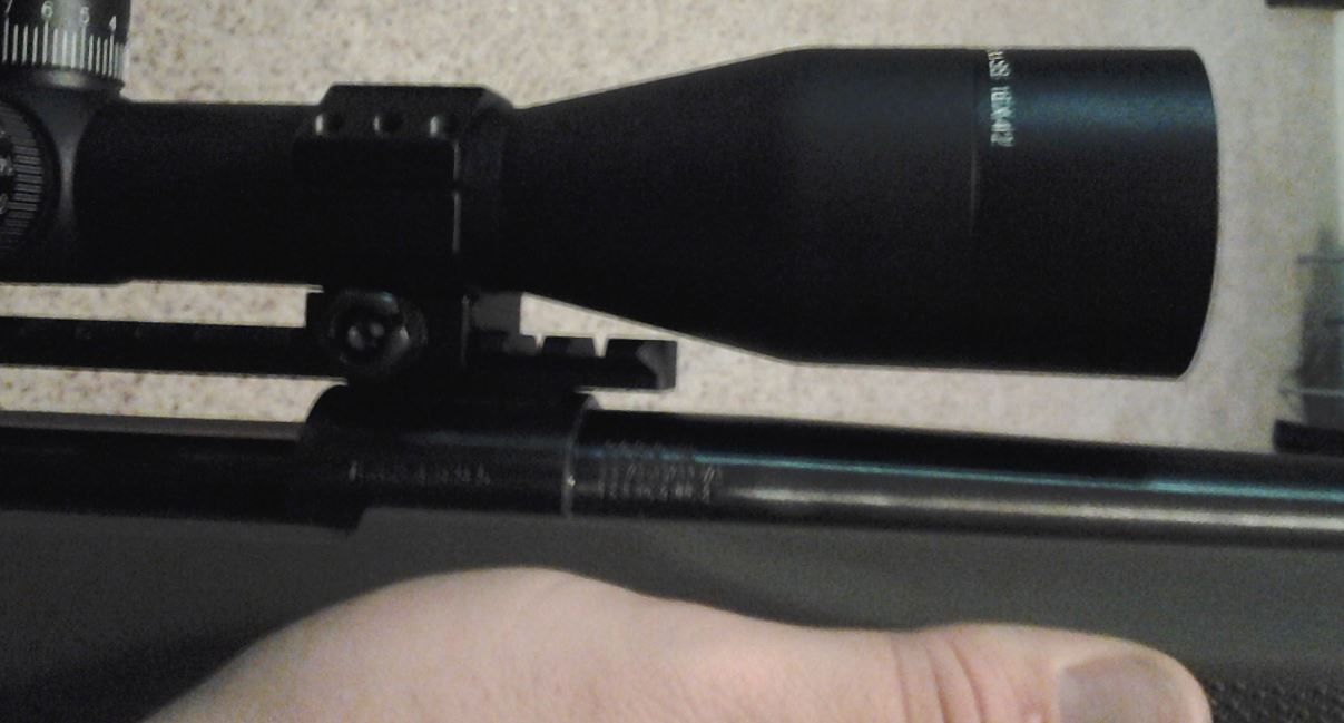

I mounted my new scope to my new base and it is mounted very close about 1/4 in maybe. I worried that when I go shooting the vibrations and harmonics will make them slam into each other. Here are some pics.
Also, when I was torquing my rings to the base my torque wrench took a shit and would not break at the correct inch pounds!!! I wasn't really paying attention and I know i got the first one pretty tight. I didn't strip or break them, I don't think I was even close to stripping or breaking them; do you guys think they should be fine?
Thanks!
As long as it not touching you should be fine. I cut the front of mine off for aesthetics; not necessary. As far as the torque, you should be fine. If you haven't zeroed the gun, I would recommend loosening them all and starting again if you have one screw you feels is over torqued compared to the rest. I wouldn't want added load to one side of the ring; more prone to shifting under recoil if it is going to shift at all.
I wouldn't be concerned about the clearance, but something looks a little off with the fit. It doesn't seem like the curve of the base matches the receiver contour very well. Could be the picture.
