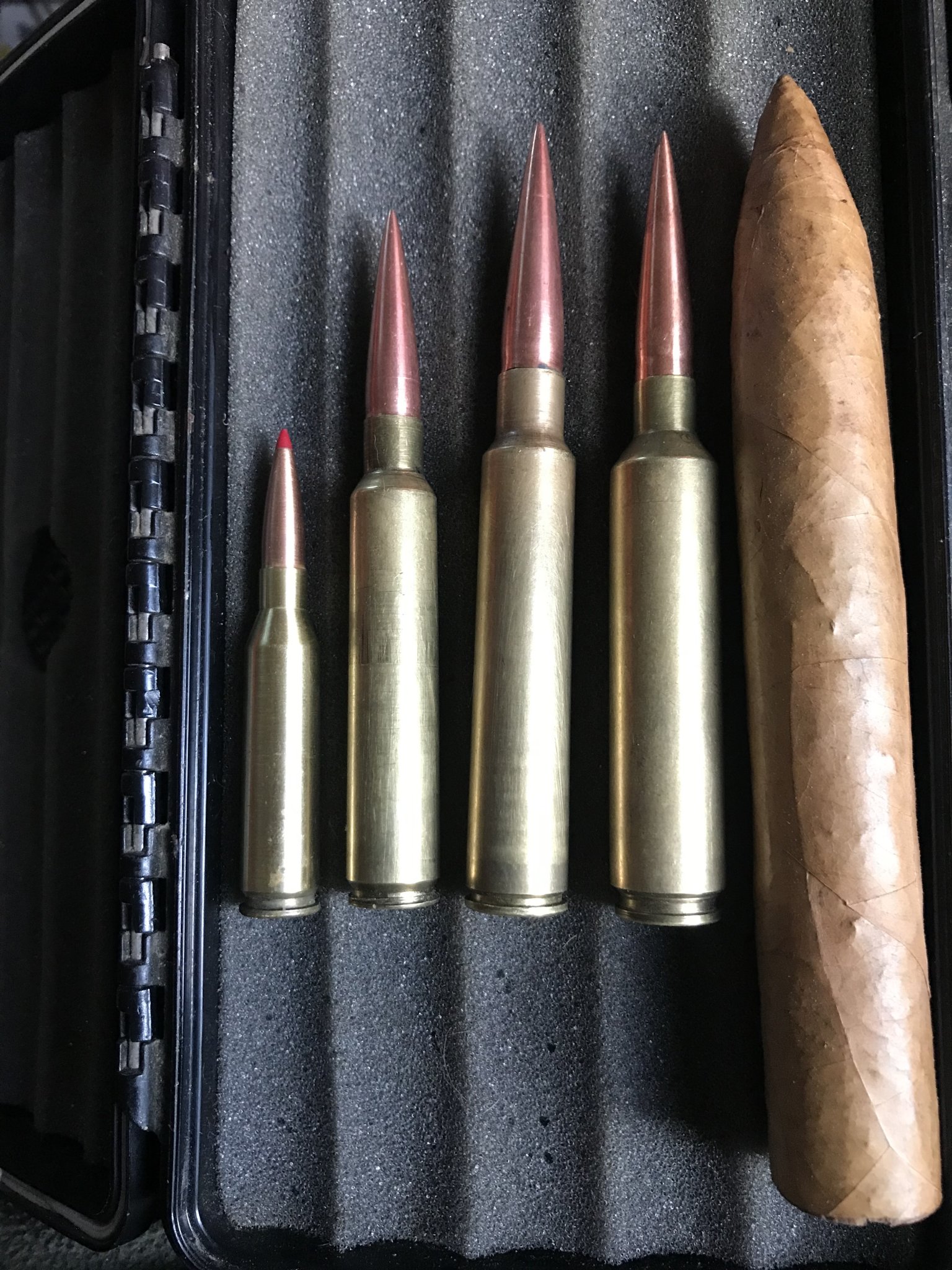

Mighty Mouse 260 and some more appropriate 2 mile options

I took a path similar to this. About 10 years ago, we decided to test the limits of a 5.56 AR-15 and an 308 AR-10. We could get hits out to 1K on 1.5MOA steel, but with the wind of our area being typically like a frustrated bitch, it was more worth our time to work in the 600-800 range to learn wind calls, etc.
I probably should have bit the bullet and jumped to an AXMC, but instead made an intermediate diversion to an MPA in 338LM. That made the jump to 2K trivial and 2400 just a bit more work on the spotting end. Then I added an AXMC in 338LM and loved it. I can shoot the AX much better and can spot my own shots way more easily. We added a 30" 300PRC barrel and 1.5 miles was straightforward for both calibers.
So basically, I'm agreeing with the others about learning from what you have, then stepping up and learning more. Most days now, a mile with the PRC is pretty casual, but if you shoot in a place with flaky wind, casual is a relative word. I like to do ELR in 2 to 4 day trips, where I can get set up and get the rewards of the times with calmer winds and also take the beatings when reality is a bitch. You really do want to try to understand what it takes to shoot in horrible conditions of all kinds, because, unless you've found some tricks I haven't, Mother Nature does not give a fuck about your wishes for easy conditions.
