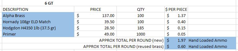

Seriously? Math much?
Want me to lay it out for you?
I'm genuinely interested. I'm at $1.97 (all new components) or $0.60 (not including brass). I haven't updated my prices since spring of 2020.
I could see where a guy that shoots one gun, once a month in a cheaper cartridge could justify $120 a month to shoot $30 matches. A lot of guys own few precision rifles and keep it slim and simple. They're all about competing. But it's hard to extrapolate that same model to multiple guns and cartridges. Some are really expensive. Want to shoot ELR matches? What's 300PRC cost? Want to have a .223 trainer? Going to pay $1.50 a round for trainer ammo? See what I mean?
