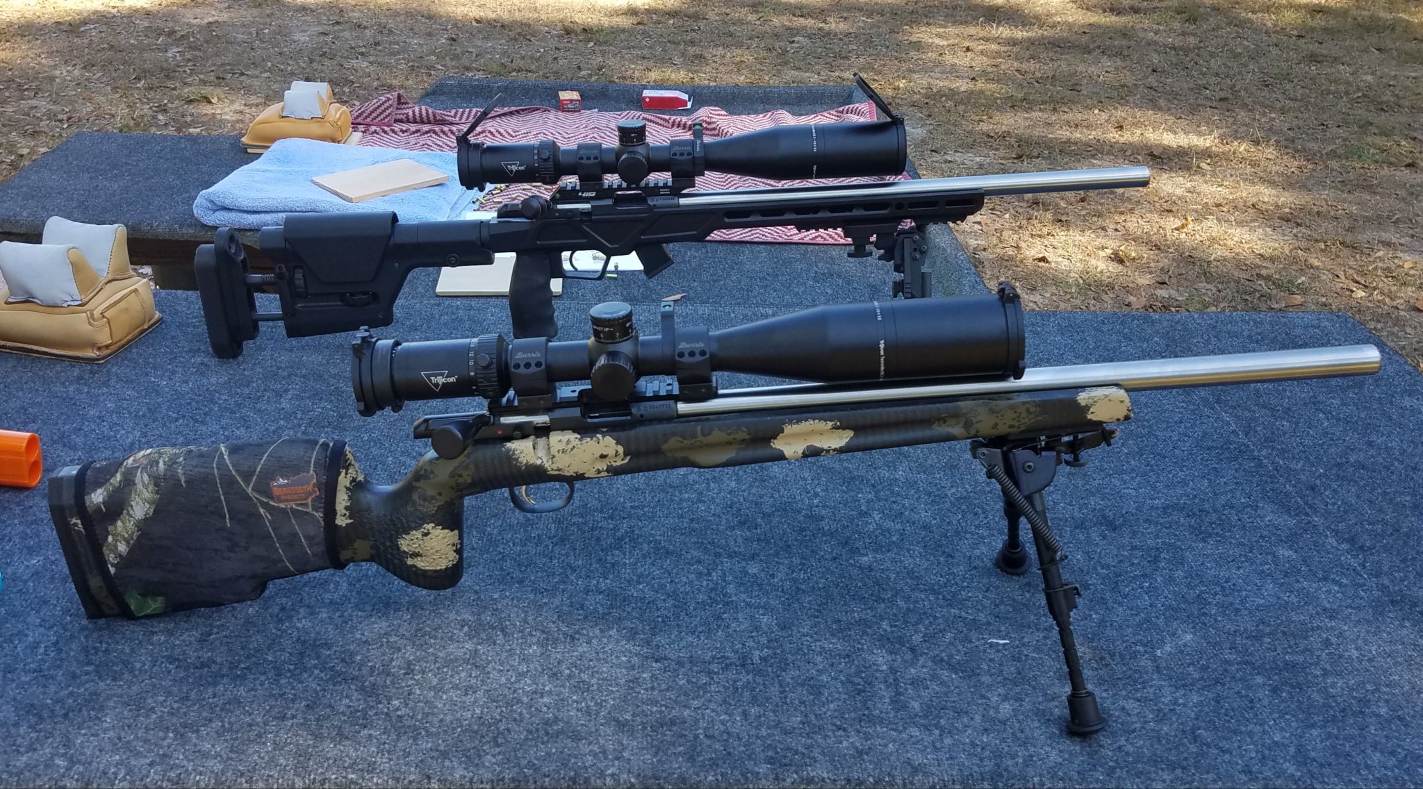

CZ's - I love em, started with a 455 varmint tactical (Boyd's stock) and ended up building it out with a chassis and custom barrel. Then did it again !, and both are excellent shooting rifles. Achilles heel ?, trigger(455's) and maybe the little plastic magazines but they feed very well.
But - at the end of it all they are still just CZ's and everything you bought is CZ specific and forever tied to that rifle. So when I built my Vudoo I had zero to start with except glass.
