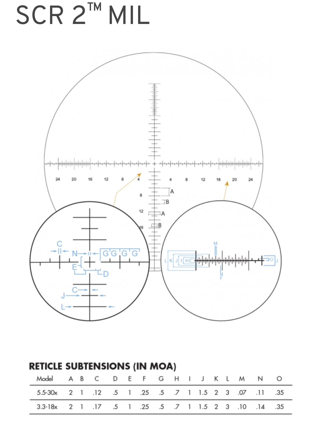

I certainly do want to like it... Do you know if the SCR2 reticle is sized the same for the 3.3-18 and 5.5-30? The Burris website is a bit confusing. Also, do you know if the 3.3-18 XTR3 has the 3-15 or 4-20 XTR2 sized SCR MIL reticle? Again, the Burris website kind of sucks. Thanks.
The SCR2 is optimized for the 18x. So its a little thicker than the 30x version.
The SCR reticle is the same in the XTRII and XTRIII. I'm not aware of a reticle thickness difference between the 15x and 20x XTRII. I thought those two were the same, but I've never had the 15x. So the 18x should be the same as the 15/20x. The 25x and 30x should be the same. I think the website just shows one size rather than get into all the detail of various reticle thickness depending on magnifications and models. Its a can of worms to try to post them all.
If you want a thicker reticle, the SCR is thicker than the SCR2.

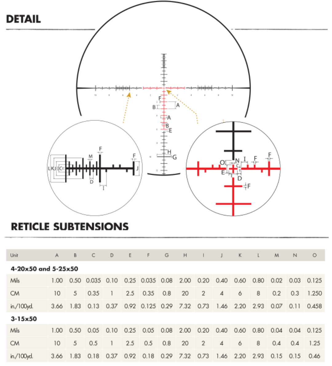

For the SCR MIL they show 15x and >=20x versions. For the SCR2, they show a single drawing in mil twice and what looks like a SCR MOA drawing. The downloadable catalog shows the same. Confusing.
From the drawings that seem properly dimensioned, the center cross line thicknesses are (in mil)
SCR MIL 15x: 0.04
SCR MIL 20x: 0.03
SCR2 (all?): 0.02
I may need to call them...

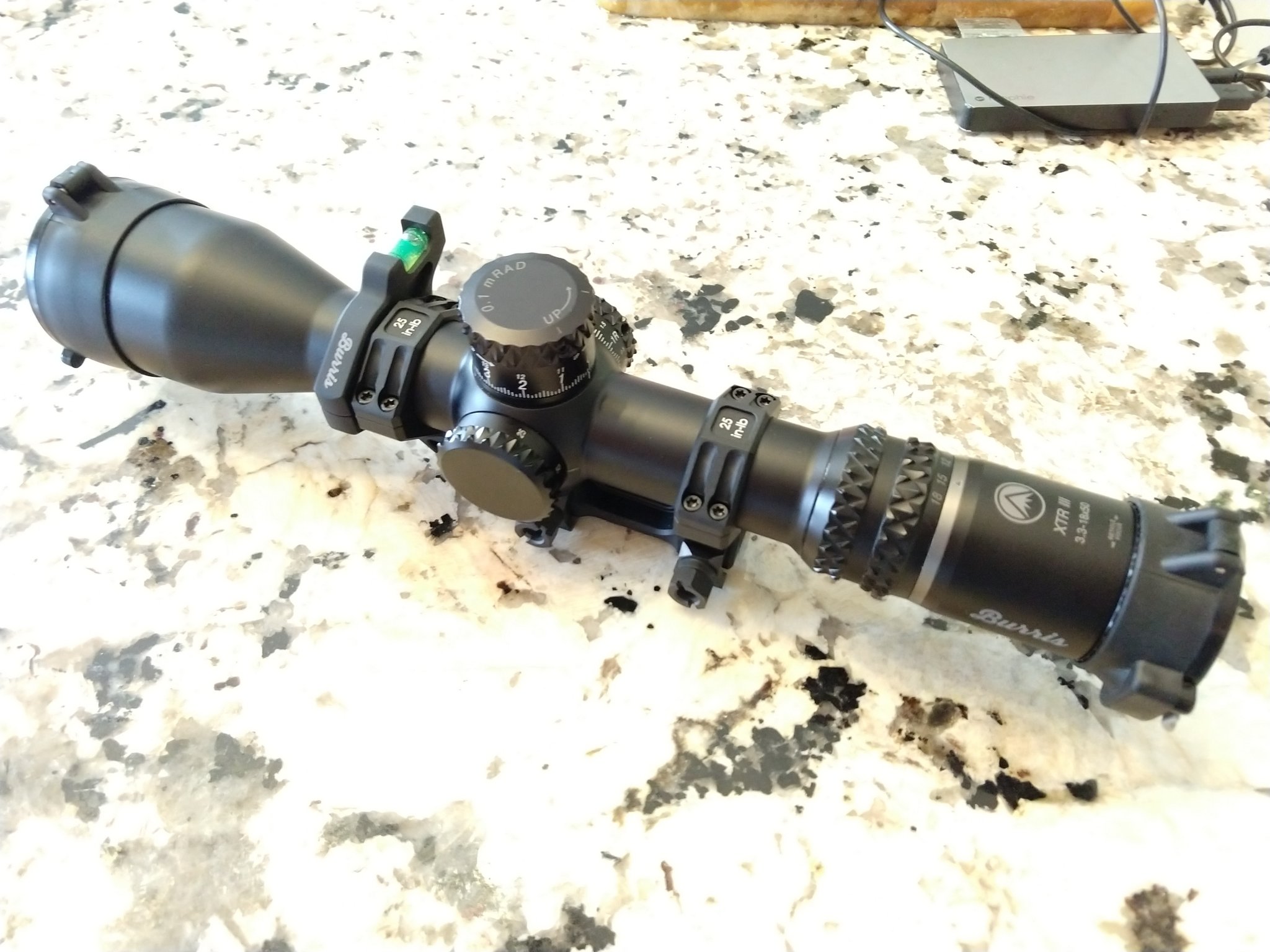

So I did a thing...
3.3-18 XTR3 (30.75 oz with exposed windage turret cap) in a Sig Alpha3 mount (4.98 oz). Saved ~9 oz compared to the previous XRS2 setup.

Also, the manual had XTR3 SCR reticle info that the website is missing...
Aiming cross thicknesses:
SCR MIL XTR2 15x: 0.04
SCR MIL XTR3 18x, XTR2 20x & XTR2 25x: 0.03
SCR MIL XTR3 30x: 0.02
SCR2: 0.02
The non-cross thicknesses:
SCR MIL XTR3 18x: 0.04 for 0.2 mil marks, 0.05 remainder
SCR MIL XTR2 15x: 0.05
SCR MIL XTR3 30x: 0.03 for 0.2 mil marks, 0.035 remainder
SCR MIL XTR2 20x & XTR2 25x: SCR MIL XTR2 15x: 0.035
SCR2: 0.02
SCR2: 0.02
SCR2: 0.02

So I did a thing...
Nice! Let us know what you think compared to the XRS II.
The XTR3 was warrantied for a focus issue, and I now have a Pro and 18x XTR3i. The newer ones didn't overlap with my time with the XRS2, but from recollection it's apparent the XRS2 is an older design. The XTR3s' had better color, contrast and brightness, but the XRS2 did a better job controlling CA. I also appreciate the lower minimum parallax of the XTR3s.
