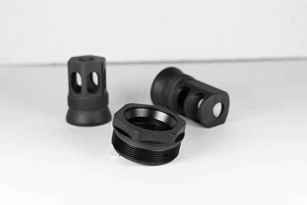

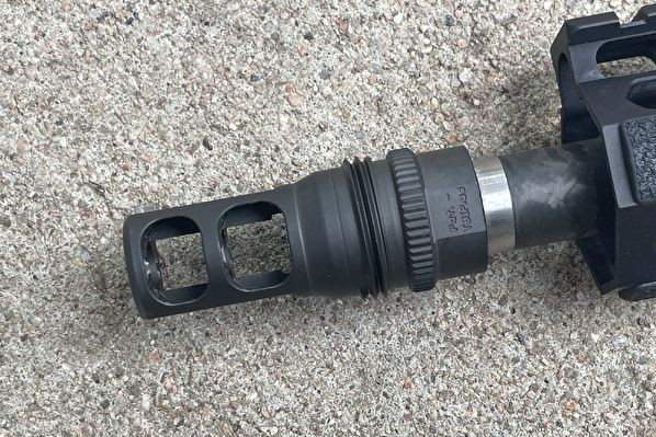

    I believe any muzzle device with the threads before the taper is more susceptible to gumming up with carbon. I think that’s why TBAC’s own SR brakes have the threads after the taper.
    I think it’d be cool if TBAC released a Hub SR adapter, with or without the lock.
    TBAC SR mount above

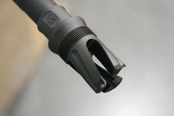

    No that is a 1X16 LH thread for the QD with a tapered mounting surface.
    Similar in concept to the HUXWRX QD mount, but C.A.T. released their QD as open source so there are a few different manufacturers turning out a variety of QD muzzle devices for them.
    Nice thing with a left hand thread, when you go to remove the suppressor it will tighten the muzzle device onto the barrel so the QD mount doesn’t spin off with the suppressor.
    Superior in concept to any of the right hand thread QD mounts.
    Compatible with C.A.T., CGS, and Kobalt Kinetics suppressors.
    I pick up a C.A.T. JL here next week that is a QD model I’ll report back once I hit the range with it.

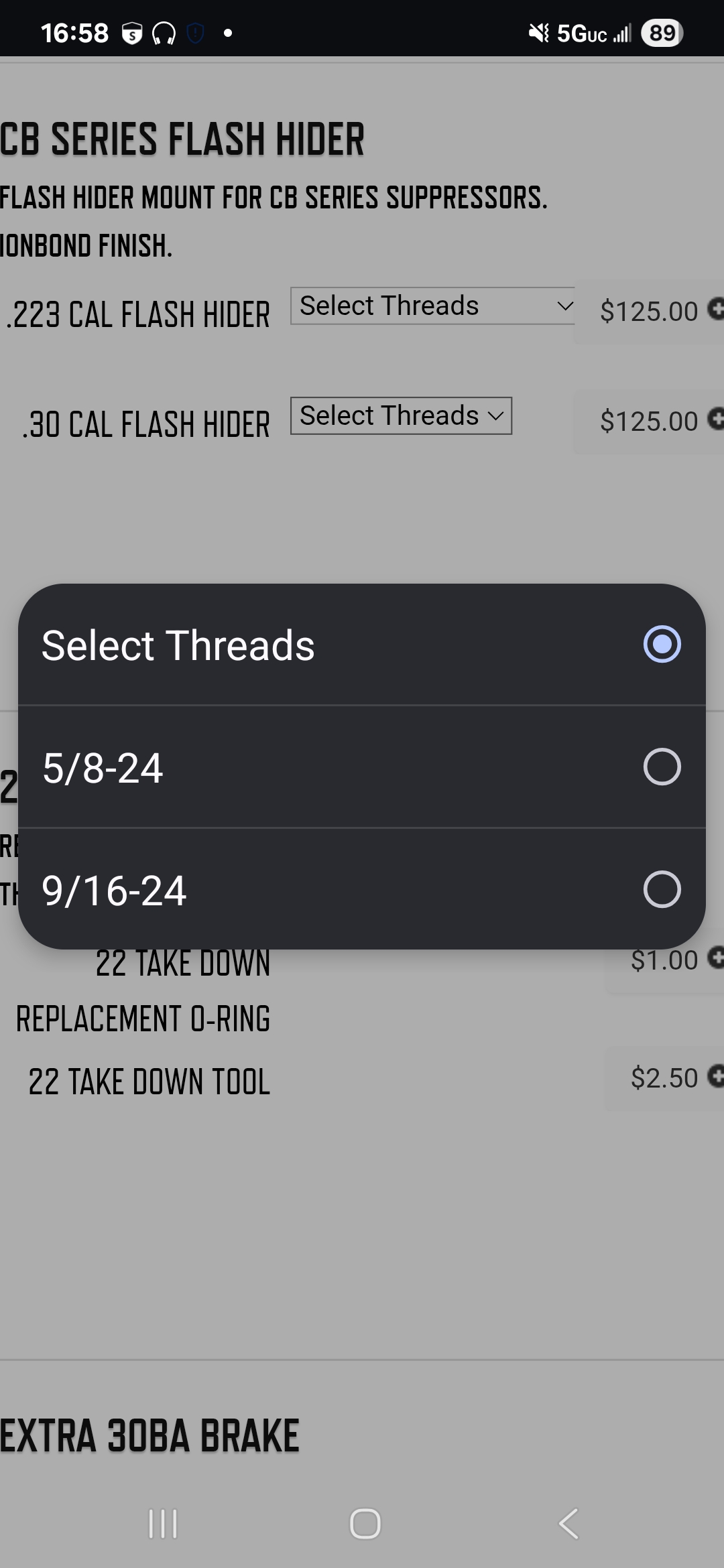

    FYI if you are not set on a brake, TBAC makes exactly one CB muzzle device with some wrench flats; this flash hider:
    It’s down a ways on that page. I think it’s weird that their other CB muzzle devices don’t have flats.
    Edit: upon reflecting, the only reason I can think of for the lack of CB wrench flats is they wanted a “dual use” ability without making the can longer. As in, suppressor QD when leaving the CB device on the gun, and direct thread if you red loctite (or carbon lock) the CB device into the can.
    Edit #2: Note that TBAC has told me that the direct thread version of an Ultra 9 is just red loctiting a CB brake in the can. I do think it would’ve been wise to have a thin wrench flat on there anyway.
