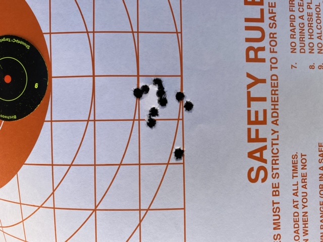

    The first target is the unmolested m855 control. All cartridges in this “test” were from the same box of 20. The squares on the target are 1 inch.
    I didn’t rush firing, but I didn’t dawdle either. 10 shots, then let the barrel cool until the next firing session. Range goes cold at top and bottom of the hour.

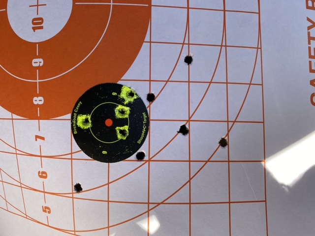

    This second target is the test batch
    Im not sure why these are on their sides, but both targets are rotated 90deg counter clockwise from how they were shot.
    ASC was super busy today and I’m taking the opportunity to blame that one errant impact on the guy next to me rocking the shared bench like it was his wedding night.
    I went into this short range session wondering if “the juice was worth the squeeze.” Well, for taking free projectiles and cheap blaster ammo and turning them into something reasonably respectable, I’d say yes, yes it is.
