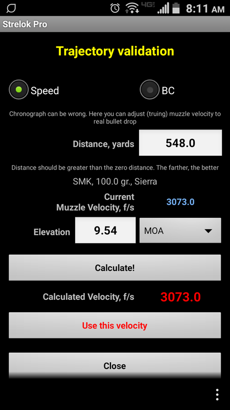

Zero at 100, then shoot a farther target without adjusting your scope, figure out your drop at that range in mils or moa, then with current environmental conditions and published specs on your projectile, drop reasonable velocities into a ballistics solver until you arrive at a velocity that produces the drop you saw on paper. My guess - 3100 - 3150fps

But yes, shoot at distance and back into the velocity by entering all the other parameters and seeing what velocity number lines up with your observed drop.

I personally like iStrelok Pro. its always been dead on for me. its as accurate as my kestrel with AB on it when I put in the same wx and what not.
but as others have said you are prob in the 3100 fps range. so you could start there in your ballistic calc, then log your hits and what you need to actually dial to get center hits.
truthfully, with a ballistic solver you need to do this to true it anyway with actual hits out to range - and the further the better. even with a magspeed or labradar and a litz BC number or Doppler generated number doesn't guarantee perfect hits out to range in a ballistic calc.
