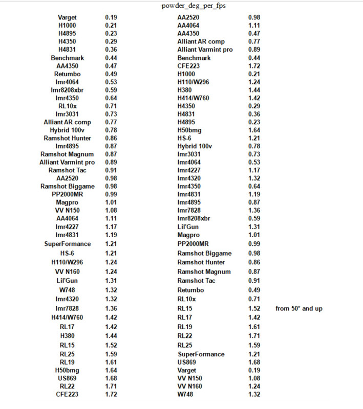

Anyone validated the chart below? Specifically asking for 223 and 308 loads.

That chart was originally posted by @Rob01 on another forum, here is a link to it in the 6.5cm thread

20 degree temp change won't move impact a mil at 1000. Look at the temps below for changes per degree. The most is 1.71 per degree. Using that and 20 degrees it comes out to about 34 degree change. Running my data on JBM, which I know is good, my load at 2895fps with the 140 AMAX is 7.9 mils at 50 degrees at 1000 yards. When I go up to 100 degrees it changes it to 7.6 mils. I have shot the H4350 loads from the teens to over 100 degrees with minimal chrono'd data shift. Might be a tenth or two at 1000. That is from the ammo being in those conditions. Granted that is with H4350 and not the new powders being used but even if they were more there still wouldn't be a full mil shift.
HS-6 1.21fps per *
H110/W296 1.24 fps per *
Imr4227 1.17fps per *
Lil' Gun 1.31 fps per *
RL10x .71 fps per*
Benchmark .44 fps per *
Imr3031 .73 fps per *
Imr8208xbr .59 fps per *
H4895 .23 fps per *
Alliant Varmint pro .89 fps per *
Alliant AR comp .77 fps per *
Varget .19 fps per *
W748 1.32 fps per *
Imr4064 .53 fps per *
Ramshot Tac .91 fps per *
Imr4895 .87 fps per *
AA4064 1.11 fps per *
AA2520 .98 fps per *
RL15 1.52 fps per * from 50* and up
PP2000MR .99 fps per *
Imr4320 1.32 fps per *
Ramshot Biggame .98 fps per *
H380 1.44 fps per *
VV N150 1.08 fps per *
H414/W760 1.42 fps per *
Imr4350 .64 fps per *
AA4350 .47 fps per *
H4350 .29 fps per *
RL17 1.42 fps per *
Hybrid 100v .78 fps per *
RL19 1.61 fps per *
VV N160 1.24 fps per *
Imr4831 1.19 fps per *
Ramshot Hunter .86 fps per *
H4831 .36 fps per *
RL22 1.71 fps per *
Imr7828 1.36 fps per *
Magpro 1.01 fps per *
H1000 .21 fps per *
RL25 1.59 fps per *
Ramshot Magnum .87 fps per *
Retumbo .49 fps per *
RL33, still trying to get my data for this one.
US869 1.68 fps per *
H50bmg 1.64 fps per *
forget about those charts. every powder's temperature behavior / sensitivity is cartridge dependent.
probably it's better to put powders in 3 classes: very sensitive, middle sensitive, low sensitive... imho
