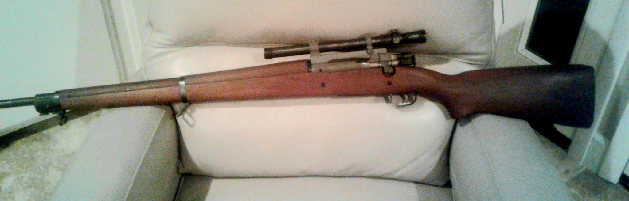

    I did this for a 1903a4 sniper tribute project. Somehow I ended up with a 1903 barreled receiver from a drill rifle. I learned that making these into functional 30-06 rifles was ill-advised due to the welding done to the receiver when making these into drill rifles. So, I figured, let's make this into a .22lr instead. I used the Redman sleeve mentioned above. I believe the instructions call for an 8mm drill extended with some drill rod to prepare the bore. I chose the solder method for no particular reason. Put a repro m73b1 scope on it. Turned out pretty well and fun as hell to plink with. Love the looks of surprise I get when others on the firing line are expecting the report of 30-06 and hear a .22!

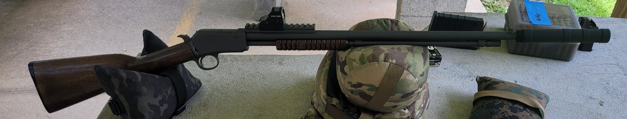

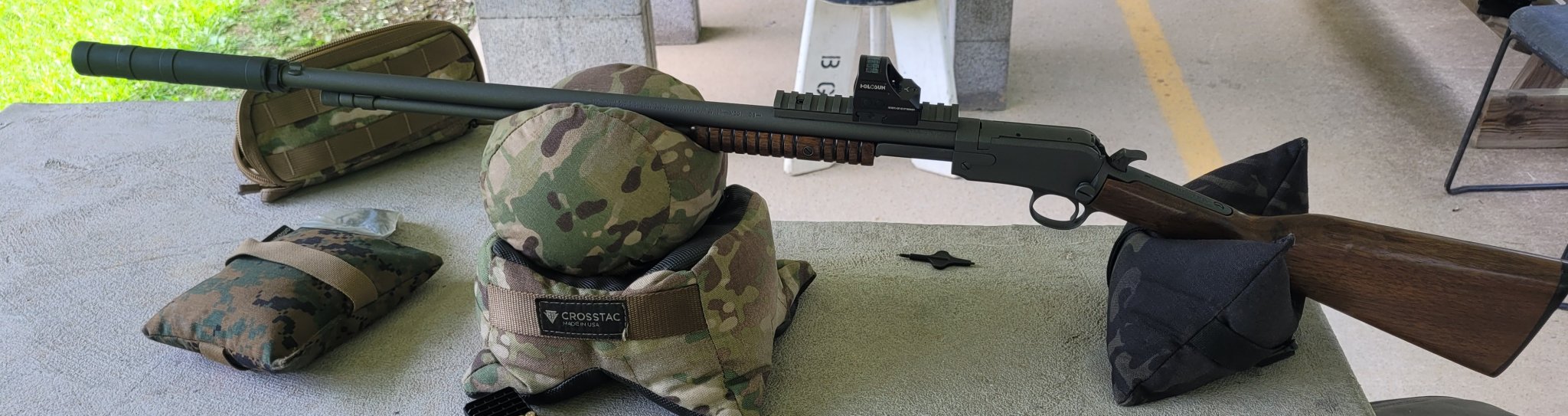

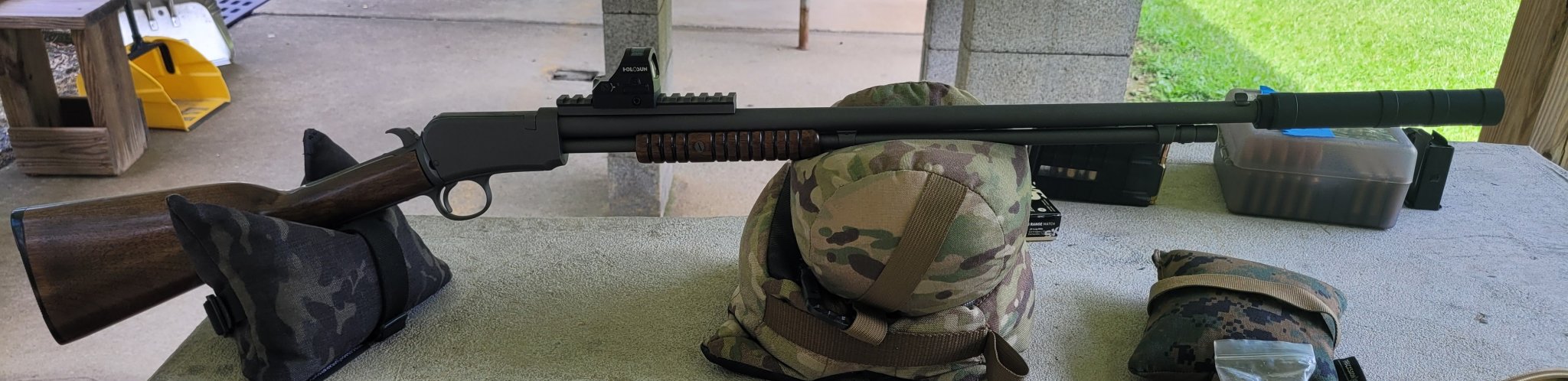

    So thanks to a gentleman ITT, I did get hooked up with a guy in MT who put a sleve in my barrel and them my gunsmith buddy threaded the barrel, installed a rail, and cerakoted it for me. Pretty slick set up and it's super quiet! Will post pics soon
    Sorry about the pics taking so long. I got distracted and forgot. Here ya go. I can't make the red dot work here though. Now I'm going to have to get a little scope....
