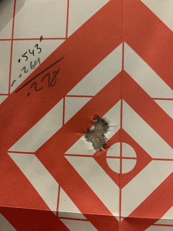

Stupid question maybe, but how do you measure this group? 5 shots, 100 yards, 6.5CM
Measured .543" using calipers from outside edge to outside edge.
Bullet is .264"
So...is this a .543" group or a .278" group?
7116255
.279 center to center
.543 for MOA calculation, i.e. approximately 1/2 MOA group or .518 MOA
And this was the cause of my question....I guess I'm confused about referencing a difference between group size as a linear measurement and its "MOA".

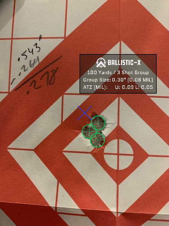

Just for clarity, not that it really matters, but this group was just used to illustrate my question. The 'offset' see here from POA is just coincidental in this case. I was doing load work up and always adjust so POA/POI are the same once I have load determined.
Annnnddd....I also ponied up for Ballistic X. Handy little app, but I wish it didn't always need a 1" reference point. Makes my usual "paper plate and a sharpie" targets less convenient.

The hole a bullet makes in a paper target is significantly smaller than the bullet diameter. Your center to center group size is larger than 0.279"...
Reactions: 308pirate
If it was measured from center, it's correct. The center doesn't have a diameter, it's a point.
That's not how it was measured. The picture shows an edge to edge diameter, and then subtracting 0.264...
Christ, does the OP understand his .278 is the correct method?
