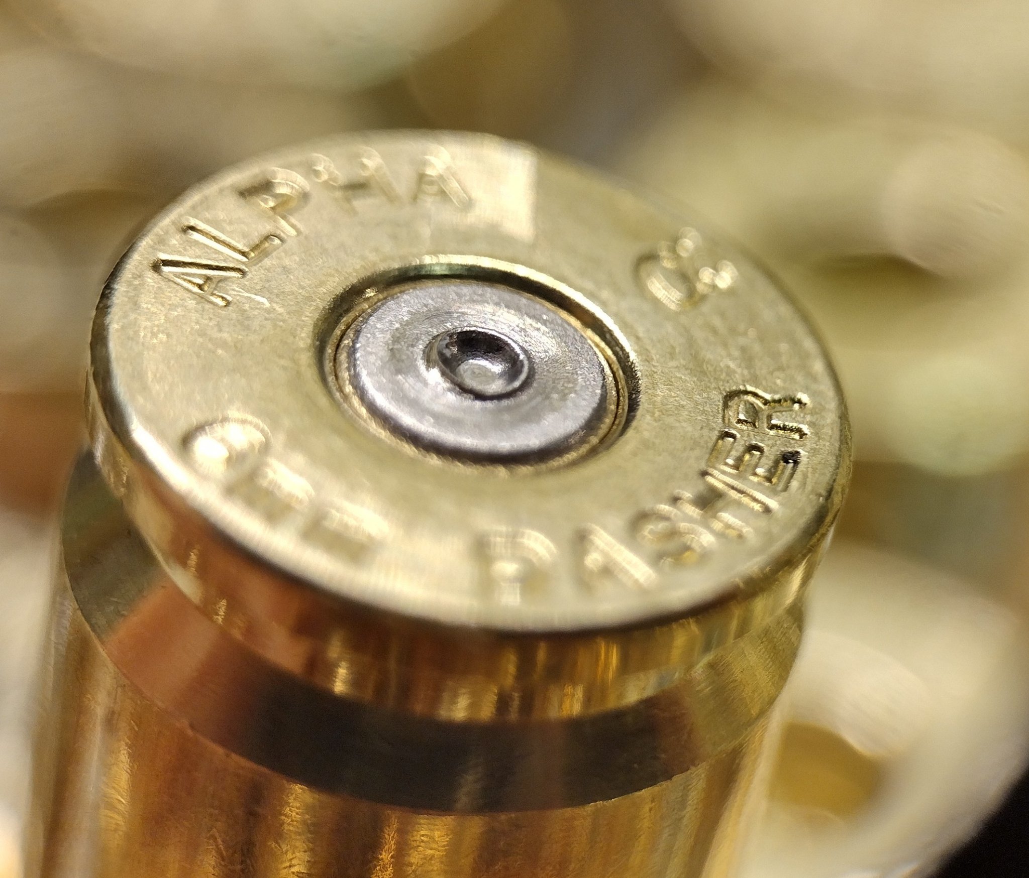

Is this a cratered primer?

    CCI 450 in Alpha OCD Dasher brass, first firing.
    My go-to load of 32.0-gr Varget. It's an older barrel I cut from 26" down to 18".
    4 of 20 rounds for zero and quick test had hard bolt lift. The rest were butter. Not sure why. All the brass is virgin: I ran it all through my die and over a neck mandrel like always. ES was 12, SD was 4.2 fps. They average 2,890-fps from the 18" tube and this same load was going 2,960 when it was 26" long.
    Wonder if I should back off 0.4-gr or what?
    All 20 primers pretty much look like this though. But they haven't been flattened.

    Your primer cup is flowing back around the firing pin into the firing pin opening. My large firing pin bolt assembly on my AXMC does the same thing. Not really harmful unless you start pushing the limits on pressure, then you will end up with a pierced primer, and it only takes a few of those to start flame cutting the firing pin and that makes the problem even worse. And I know this from experience lol.
    One way to solve it is to have your bolt bushed to close down the gap between the pin and the hole.
    Also, that primer does look a bit flattened to me.

    Send to LRI and have it bushed. Did that on my buddies 6.5 CM savage and it fixed it. Quick turn around as well
    That gun would crater primers at mild loads
    This advice doesn’t mean bush it and load at high pressures. Still may want to back off a bit if having issues
    Different manufacturers make different primer holes. In that brass it is almost possible to get the primer to really fill the void.

    The primer cups on certain brands can play a factor in the severity of this issue as well. CCI tend to hold up decent
    Some weaker cups could blow the crater out, into the action and pit the pin or the bolt head though

    Looks to me like it’s typical flow from a firing pin gap. If you were shooting LRP brass and swapped to SRP brass, this would likely be new to you. Primers alone are not a good indicator for pressure.
    The hard bolt lift could be an indication but if only the first 4 had heavy lift, I’d guess you had just cleaned the rifle and there was moisture/oil or something still in there at first. If it was 4 random rounds out of the 20, that’s prob an indication that you’re too hot. I don’t shoot dasher so I’m not sure if the speed is excessive but the comparison from 26” to 18” seems to suggest you’re hot.

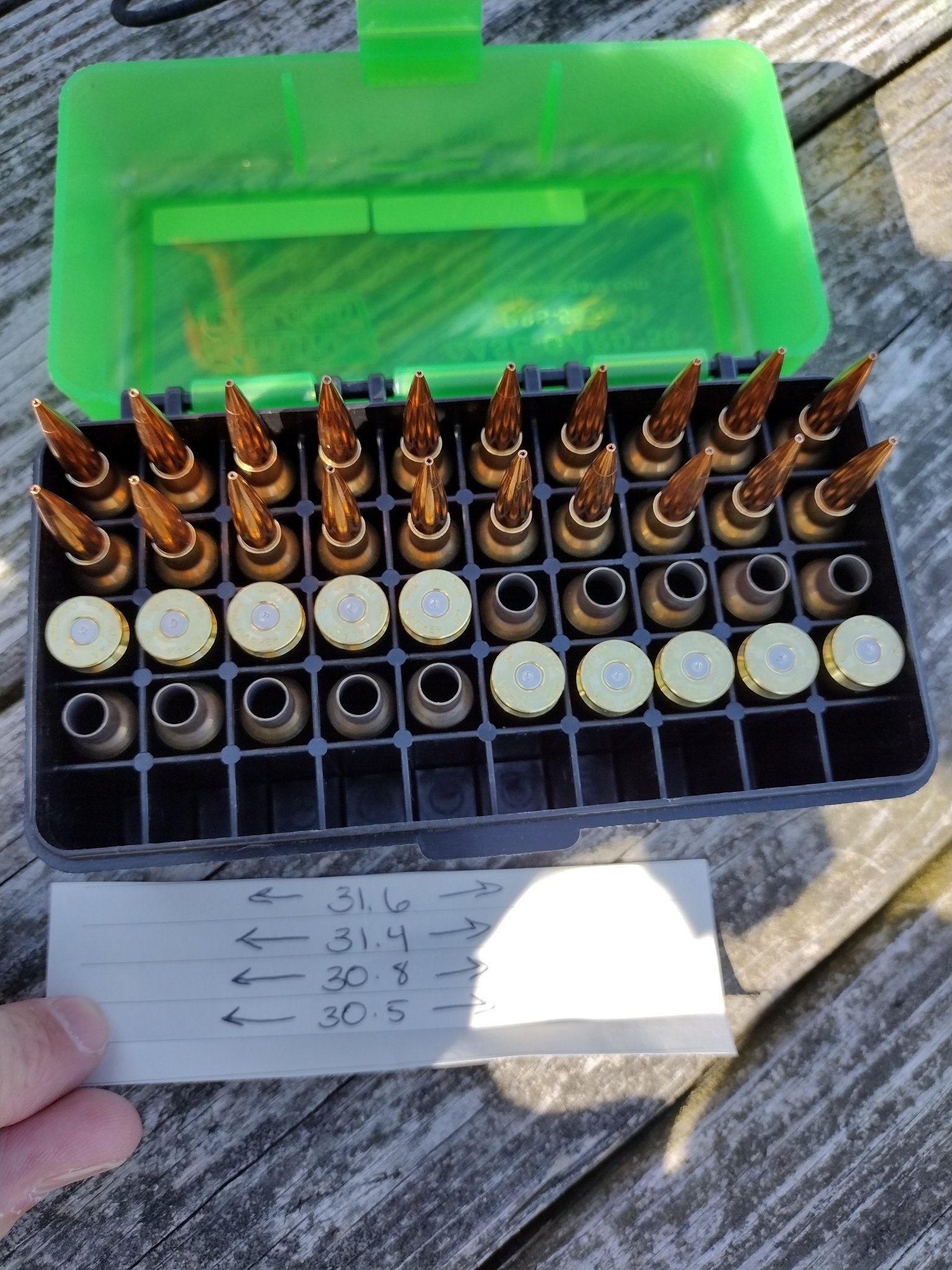

    Back out here with lighter loads.
    Cleaned the barrel last night.
    Loaded:
    x10 @ 30.5-gr
    x10 @ 30.8-gr
    x10 @ 31.4-gr
    x10 @ 31.6-gr
    First 5 from the lowest load (30.5-gr) had hard bolt lift, velocity averaged 2800-fps. Thought maybe it was pressure from bore cleaner but I patched it until dry. Second five from that load cycled fine.
    First 5 from load two (30.8-gr) cycled like butter, shot well and averaged 2825-fps. Next 5 from that load had hard bolt lift and ejector marks again. SD was 5.1 after 10 shots, max spread was 15-fps. I'm stumped. I'm probably not going to shoot the rest.

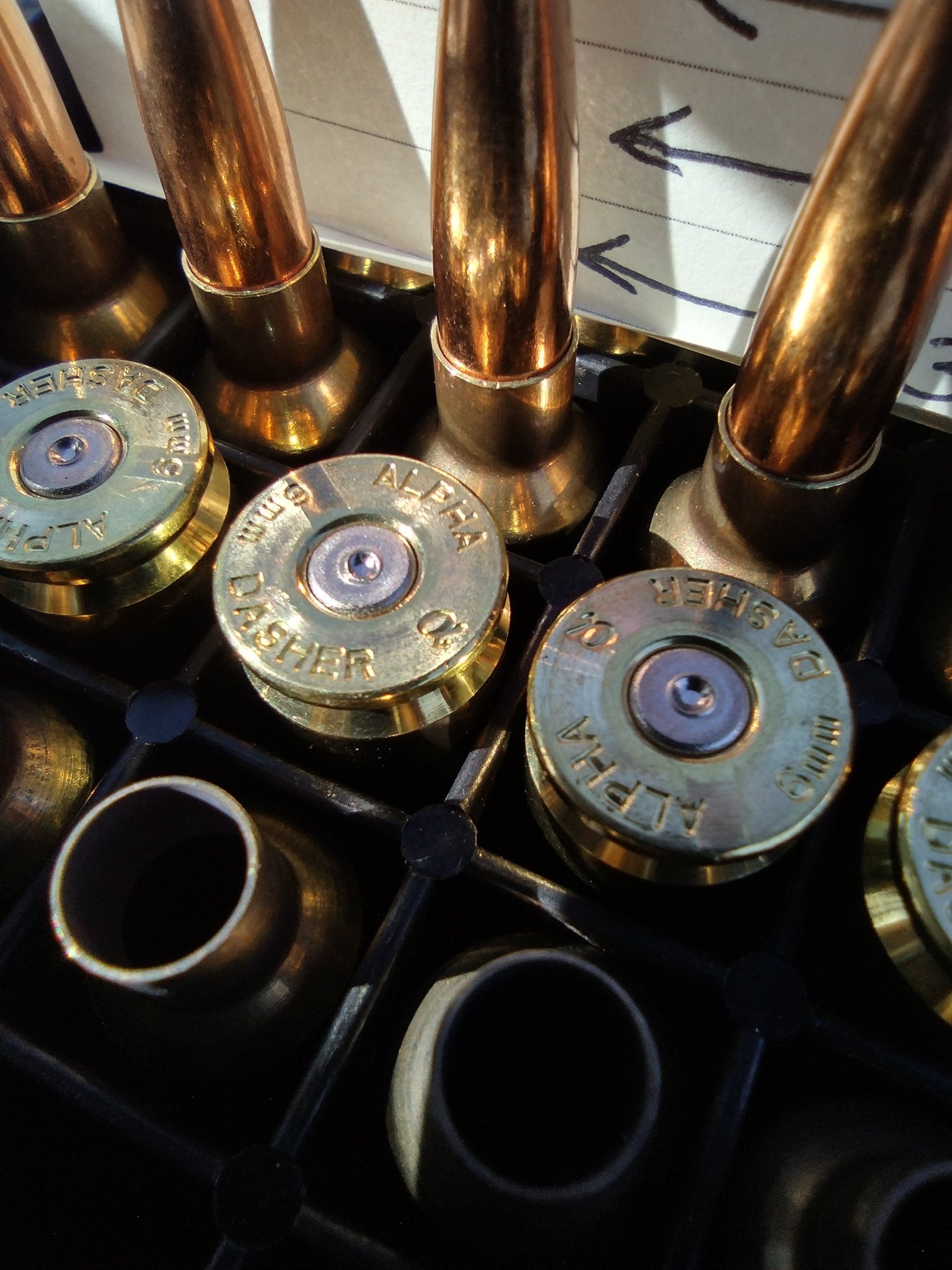

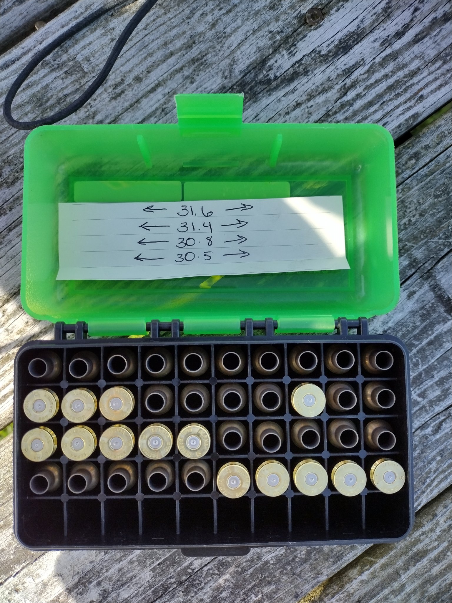

    Front to back, right to left is the order I shot these. The ones with primer visible had hard bolt lift, the ones with case neck up were fine. Although there is no difference in the appearance of the bases between the two. Even ones that had no issues with bolt lift show primer flow and ejector marks. 🤷🏼‍♂️
    Well I couldn't resist....I shot 'em all. Funny thing though....the hottest load, 31.6-gr had none that gave me any trouble with bolt lift. 🤷🏼‍♂️🤷🏼‍♂️
    Necks up = ran fine.
    Primers up = hard bolt lift
    Shot low to high, right to left.

    I wouldn’t read much into the primer flow. Our Desert Tech leaves the exact same flow with SRPs. It’s just empty space between the pin and the hole.
