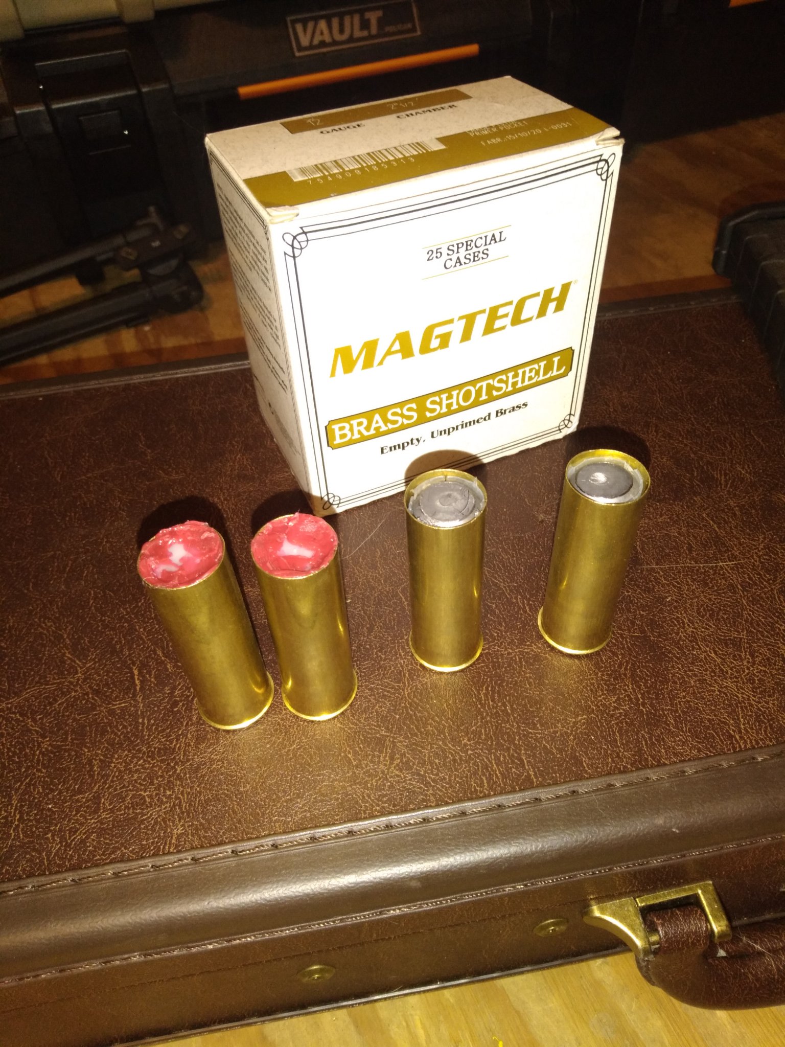

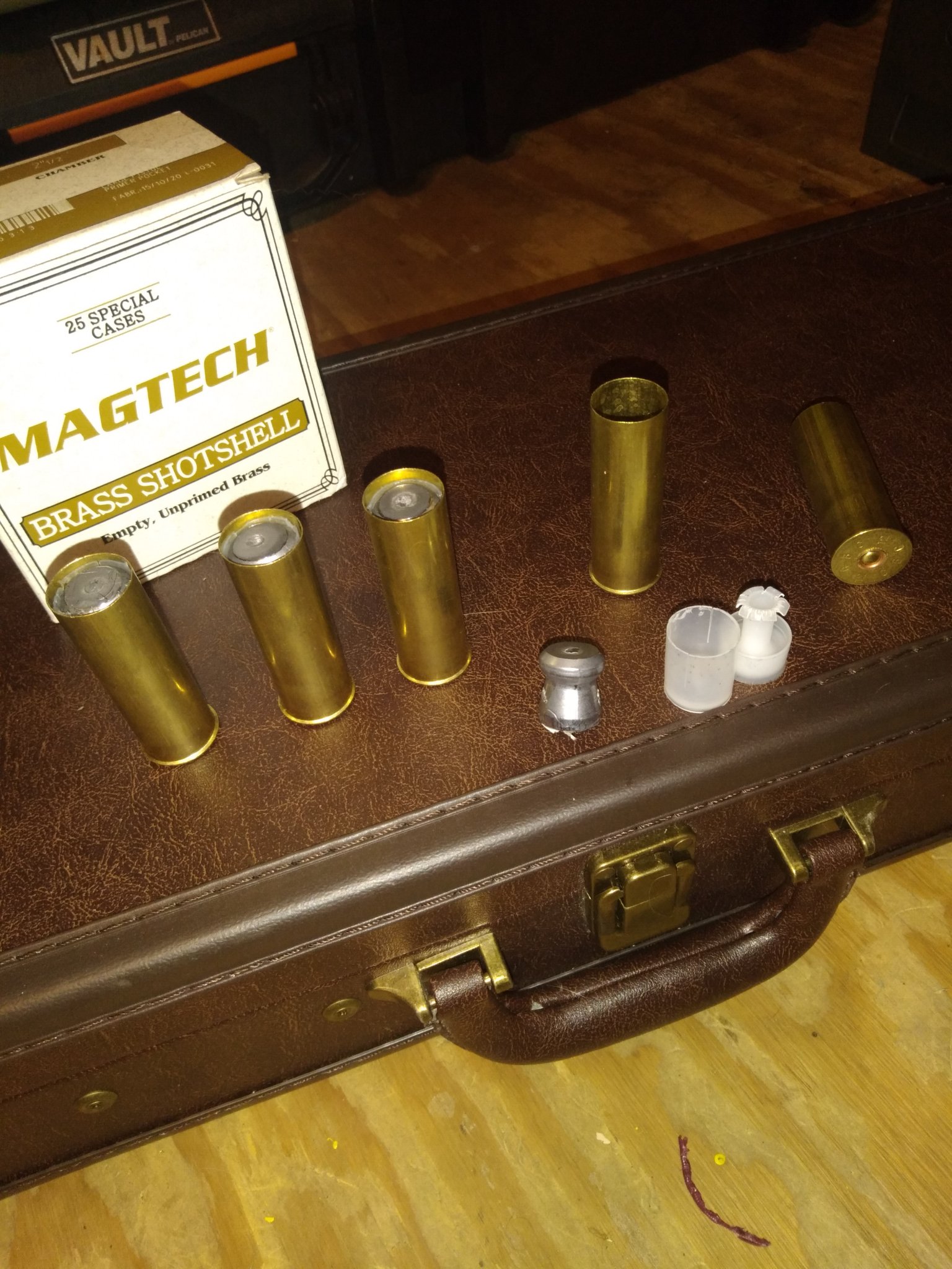

    I have made up 5 solid brass 12 guage shells. But i want to shoot some slugs out of em. On these 5 shells i drilled them out and chamfered them to take 209 primers. Running federal 2 peice wads and havent decided on powder, i have a few kinds for shotgun. The slug is a lyman slug i pour from soft cast lead using a svarog mould. I also cut 5 shells apart and removed the plastic seat for the shell head that levels powder with the primer and just moved them over to the brass shells and tapped them in. I have tons of reloading experience for rifle and pistol, but not much for shotgun and especially not with these types of shells. Just curious what the hide thinks.

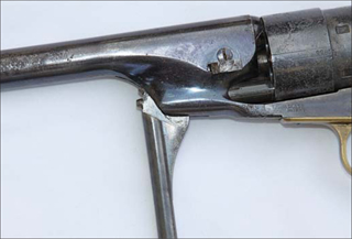

    The ultimate is the Colt .36/.44 caliber black powder revolvers......they are designed with their own reloading press...

    I knew nothing first time I fired my BP Colt 1860 Army. Im lucky I didnt blow my hand off. I had bought a pistol specific loading kit and the "nipple" for the powder magazine must be set for the appropriate amount of grains because I was just putting my finger over the tube dumping powder from the magazine, shutting off the valve than dropping the powder in the cylinder. Top it off with a ball add some grease to prevent chain fire, cap and go.

    Only thing I'd be concerned about is the length. I'd make sure the case it doesn't protrude past the chamber. That might get exciting. How did you make the brass shells?
    I bought them from midway. Magtech 2 1/2" solid brass shells. They come setup for running large pistol primers but are easy to change over

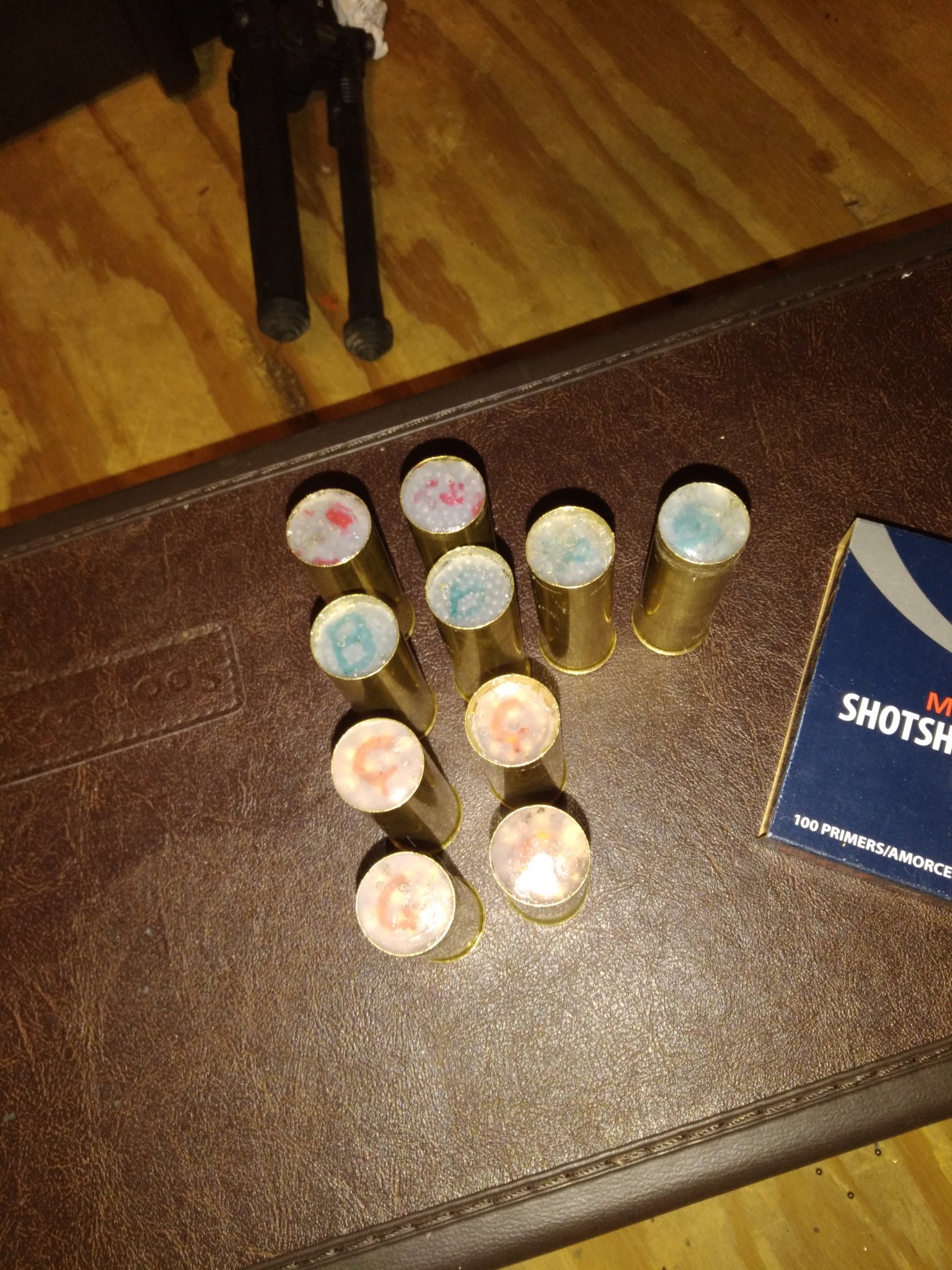

    So, update. The makers mark crystaline wax did not do a passable job on the overshot card. I did not fire any slugs thru these, just too iffy for it falling down the barrel. This is what i came up with. I loaded 10 of the 25. If anybody wants a play by play of how i made them work i would be glad to post it. The red ones are federal 2 part wads with bird shot, the green ones are winchester wads with bird shot, the orange ones are winchester wads with copperhead bbs, i placed the over shot card and used clear silicone this time.

    OP, I made some of those mag tech shotgun shells last year. I found that they are made with a ”balloon” construction and will give you bloopers if you use regular nitro powders….not all the time..but mostly. The box says the shells are made for black powder, and they work fine with real BP. The reason is the primer hole is above where some of the powder sits.
    there is a way to make them work with regular powders but it involves pouring epoxy in the base of the shell to bring the bottom to be even, then redrill the flash hole thru the epoxy….this was more than I wanted to do and I began using regular blackpowder.
    Also, shotgun powders require some pushback/resistance when used. This allowes all of the powder to ignite before the shell payload begins moving down the barrel. With real BP, the powder burns much faster than nitro powder and doesn’t require back pressure.
    I found the 12 ga shells needed 10/ 11 gauge fiber wads depending on brand and 11ga overshot cards. I used elmers glue to secure the last overshot card and allowed it to dry overnight.
    I found that 12ga plastic WAA12 wads to be very loose inside the thinner brass shell and dispensed with plastic shotcup/wads altogether.

    If you're using the standard lead polyethylene wads on the Copperheads BB load, you will likely score (dent) the bore of your shotgun. Steel shot (Copperhead) need a thicker wad made from a thicker plastic. Take apart a steel waterfowl load and you'll see the different wad.
    Hope you haven't shot them yet.
