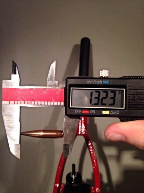

JBM lists the length of the Berger 6.5mm 130gr VLD as 1.4". I just cracked open a new box of 100 and they are measuring on average 1.323" in length. What gives? Anyone else out there find this to be true for their lot of these bullets?

The current Berger spec sheet is different from the previous ones. On the new spec sheet the hunting and target bullets have different dimensions. On the old spec sheets they were the same but are different from either bullet on the new sheet.
According to the new sheet the OAL and the bearing surface length is a lot shorter than it used to be.
I asked Eric Stecker about it and here is his reply...."This bullet has been difficult to make due to the height of the lead column. When we made the jacket shorter we are able to get more consistent results. This change has no affect on ballistic or terminal performance. It may affect rifle tune but the affects should be minimal given that the only dimenesional difference is a shorter bearing surface."
