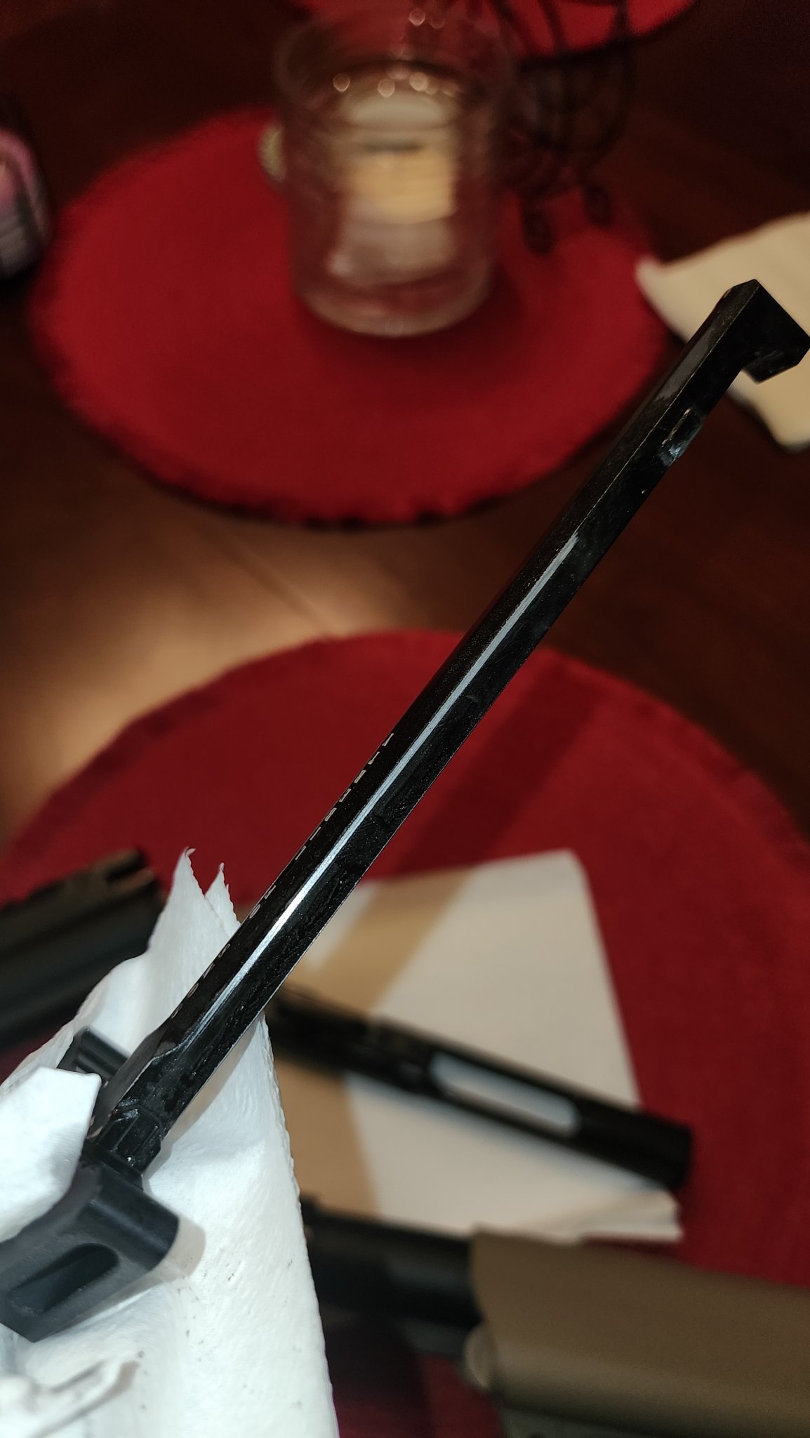

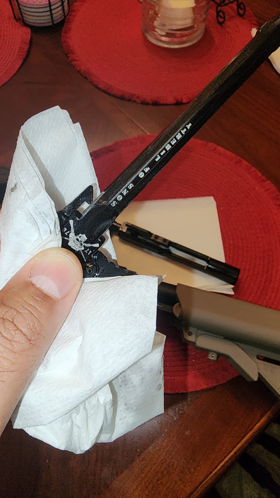

Thank you for your reply. It was helpful. So I took out the charging handle and bcg, and the I checked to see if the carrier slides freely and it does, I also noticed that there was wear on the charging handle and upon inspection, it seems that the charging handle is what is causing the drag. Without the charging handle, I can put the barrel facing down and just drop the BCG in and it glides along with no issues. I will try another charging handle and see if it is any better.

OP - Is the CH one manufactured by SOLGW? Can you post pics of where your CH is worn down the most? Can you see any wear inside the receiver?

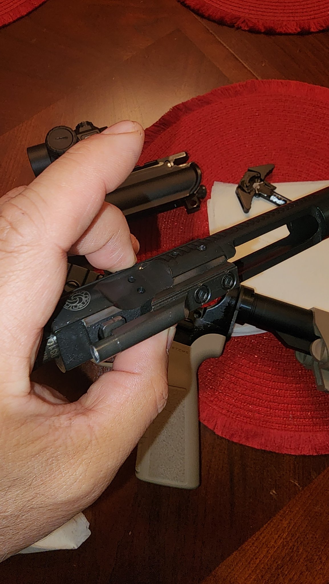

So after adding copious amounts of lubricant, the situation seems to have rectified itself. The BCG and charging handle are gliding along as easily as they do in my other AR with hand cycling. I've included pics of the wear patterns both inside my receiver and the charging handle and BCG just in case you guys can identify something that should concern me.
